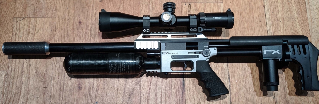

My Impact:

Thanks to all that have replied and MonsterMax for the cool pick. Yep that's what mine looks like but I have a super size Donny. Let us know how the slug liner works for you.
