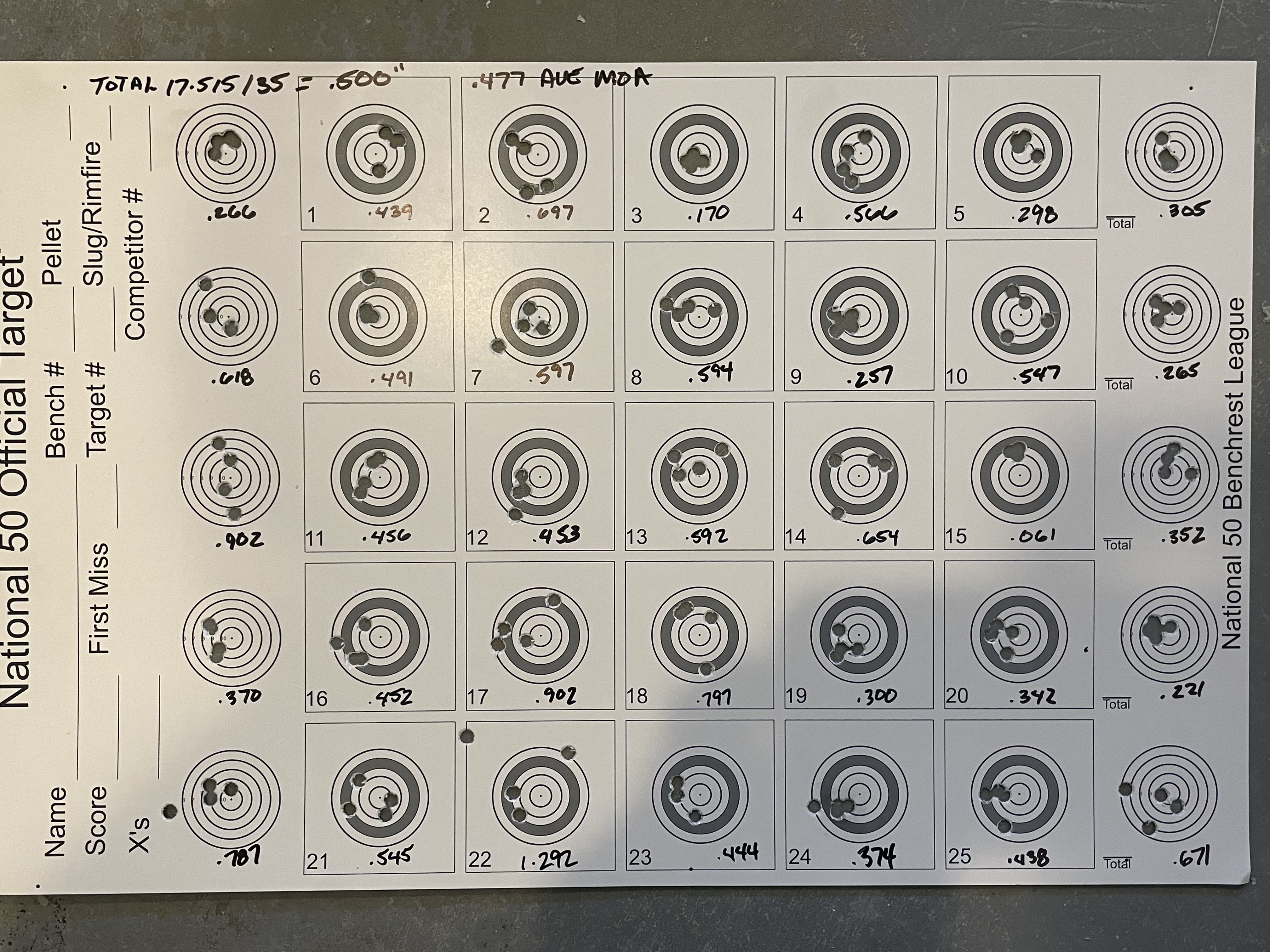

I posted 6 consecutive 25 shot groups with slugs yesterday.
Mike
Here is 35 consecutive 4 shot groups at 100y...although it's a different slug than the groups I posted yesterday.
1/2 moa average.
Mike

Here's a link to a scientific study as to why my 25 shot groups averaged .96 moa and my 4 shot groups averaged about half that.

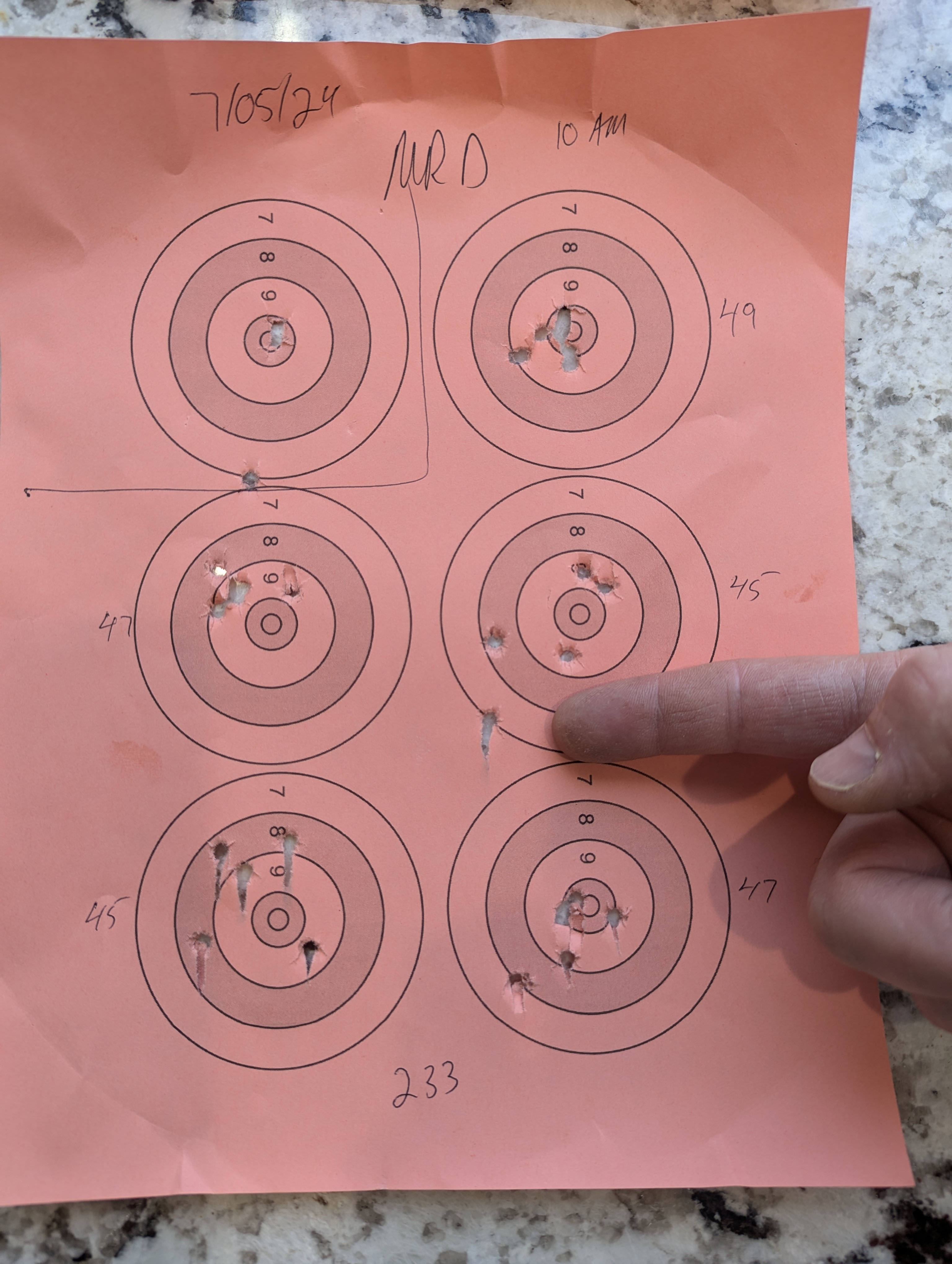

I was one of the biggest critics of .22 Monster RDs, in regards to their 100yard performance. Over 5-6years of trying, I just couldn't get them to shoot acceptably, from lots of guns and lots of barrels. 6-8 months ago I was so disgusted with the .22 Monster RD that I sold 95% of my supply, at nearly give-away prices.
Then I stumbled upon a barrel that will actually shoot them well.
This was yesterday morning. Not really an exceptional example either, as it'll do this in decent conditions pretty often.
I'm pointing at the one shot that is about the worst flyer I see from this barrel. These pellets were straight from the tin, unsorted, unweighed. And I only shot the one card yesterday so this isn't cherry picking. The MRDs shot are from around 2020-2021, and this same batch would produce all too frequent flyers from other barrels that I tried.

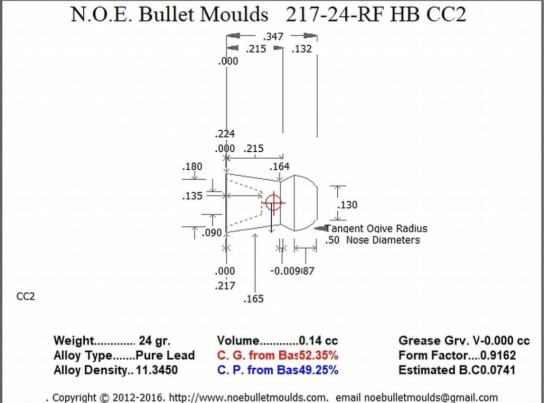

Couple years ago I bought an NOE mold for .22, called their "Hunter" mold. When using the deepest skirt pins it throws pellets in the 19.6-19.9grain range, with a meplat. VERY similar shape to a JSB .22/18.13 so not necessarily a great 100 yard option.....tested those cast pellets in quite a few barrels, mostly out to 50-60 yards. Most of them didn't shoot very well, could be used for Hunting I suppose, but not target shooting. Other than from one barrel, they didnt shoot well enough at 50-60 yards to even bother with 100 yards. Anyway, NOE also makes a mold for 24grain .22s that I've been intrigued by for awhile. I image they're quite similar to a JSB 25.4. The spec sheet lists a pretty high estimated BC, high enough to interest me, but with how the lighter version shot for me, I've never "pulled the trigger" to order the mold for the heavier.
Would love to hear from anybody who has tried this .22/24grain mold out to 100 yards.
