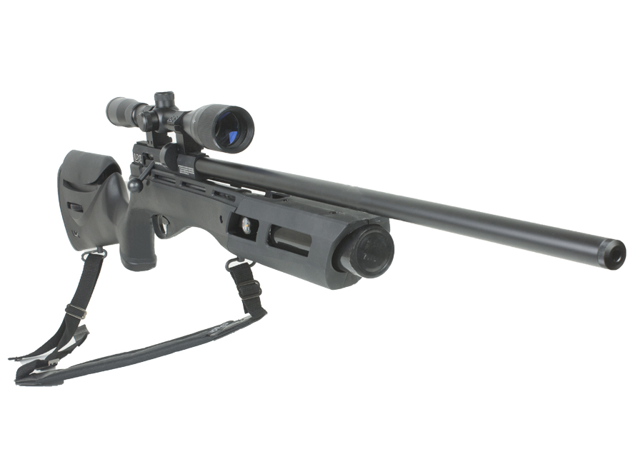

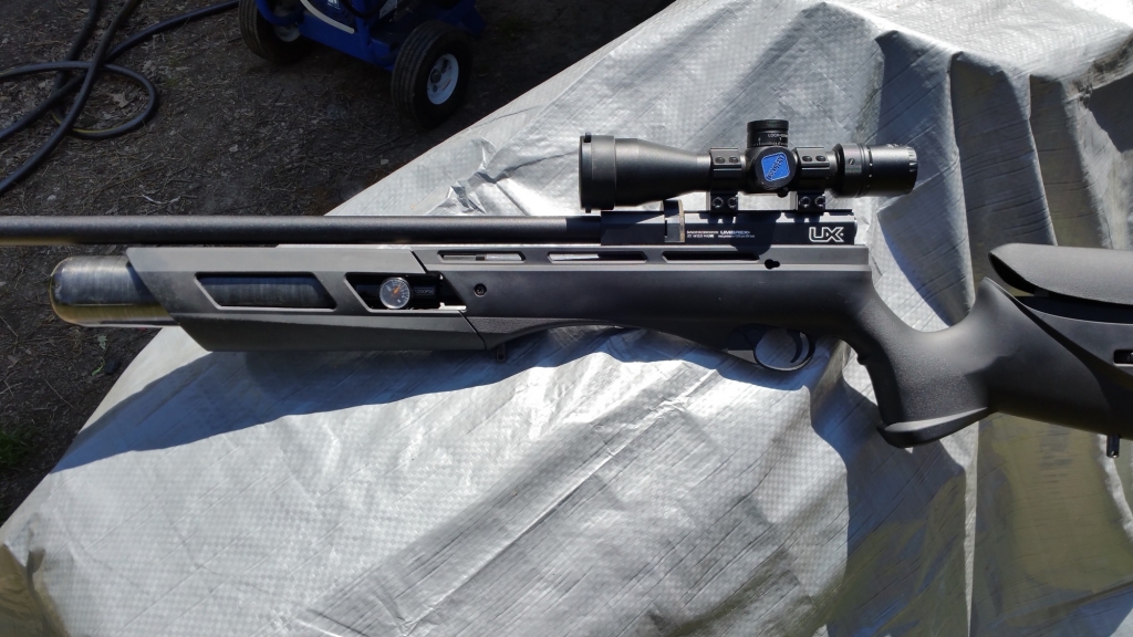

Your question isn't clear so I'll give you an example that may help.
I purchased a .22 Umarex Gauntlet for one of my sons. He doesn't own a pump so he can only fill at my house or from my SCBA tank so I modified his gun.
I replaced the 200 bar steel tank and 1200 psi regulator that came on the gun with a .3L 300 bar carbon fiber tank and a 1600 psi regulator to give him more power and a higher shot count.
Original configuration

Modified
