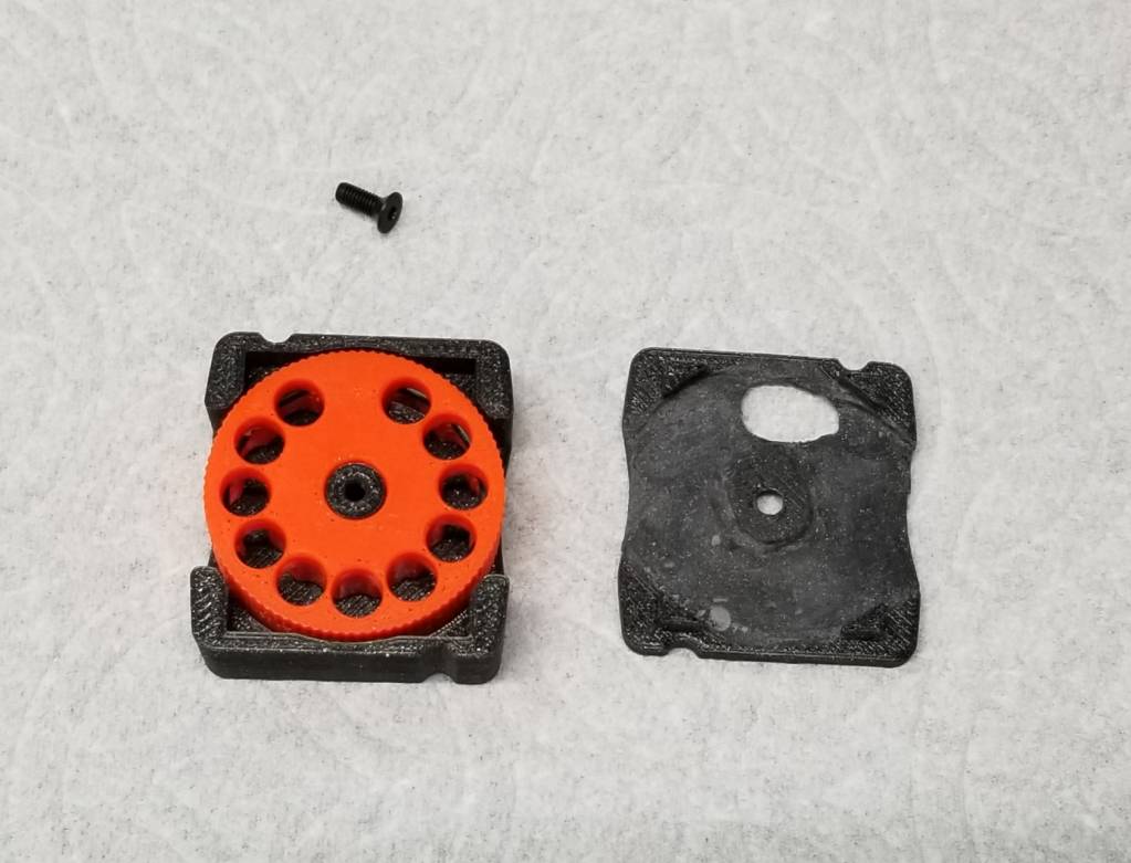

I just got my Uragan standard in .22 and see some initially promising results shooting JSB 33.9 grain Beasts.
My problem is that they are a little too long to rotate in the magazine making it impossible to do more than single load to shoot them. Has anyone else ran into this problem and figured out a better solution than load one, shoot one, pull the magazine and repeat?
Quick update...
The Carm magazines CAN be successfully modified to accept Beasts. I took the cover plate off and sanded a shallow channel on the inside in order to gain the tiny extra room for the length of the Beasts.

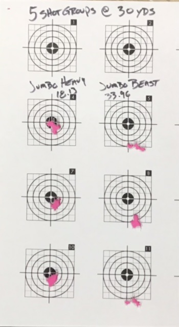

I played around last night at 30 yards to check the job I had done to the CARM magazine and compared the most accurate pellet so far (JSB Jumbo Heavy 18.13) against the Jumbo Beast 33.96 which showed promise single loading.
I’ll evaluate as I back up from here but from what I see it’s definitely worth pursuing further.
I have to note that I have not been able to try any Monster REDESIGNED yet and am really looking forward to seeing how they compare to everything so far.
small grid squares= 3/16”

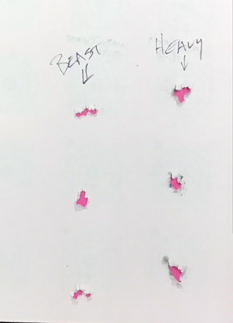

Here’s the back of the target.
