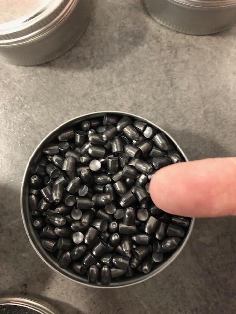

The 18g (now discontinued) shoots remarkably well in my .177 FX at 30FPE plus in my Redwolf and WOLVERINE HP, also 30FPE.
I am waiting for the 12.5 &15g NIELSEN to arrive as we speak, but also I am testing some new slugs from H&N in .177 so watch this space.
