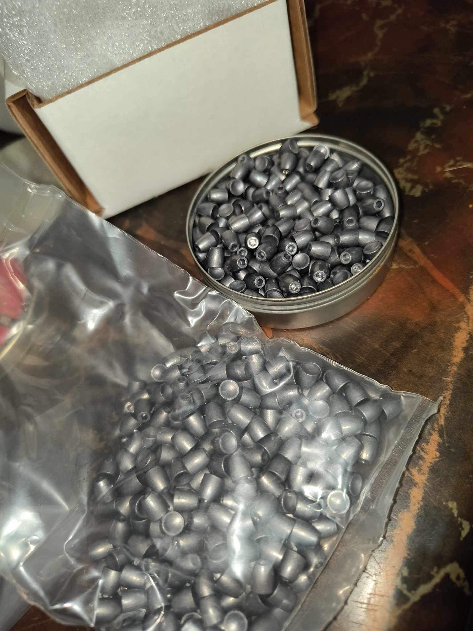

I have used the Nielsen Specialty .217 17.5gr in a few of my .22’s.. DAR Gen 3 (Dynamic Air Rifles), Benjamin Armada & Beeman 1358 Underlever & they have grouped really good with factory tunes on all.. so my guess is they will do well for the most part in moderately powered guns.. they are loose in the mags is the only downfall..
Why would a slug get stuck? Aside from a dbl feed? Just curious?
If the slugs are long and oversized, and your gun is underpowered, and the barrel is potentially choked, all these things can lead up to a stuck slug. Because many guns/barrels weren’t designed for such. May never happen. Just something to be aware of.
Reactions: Jake4578
Ok I understand that, Thanks, thats why I ordered these light ones, @ 17.5gr I figured most moderately powered guns shouldn’t have an issue.. I appreciate the feedback, I’m fairly new slugs ect..
