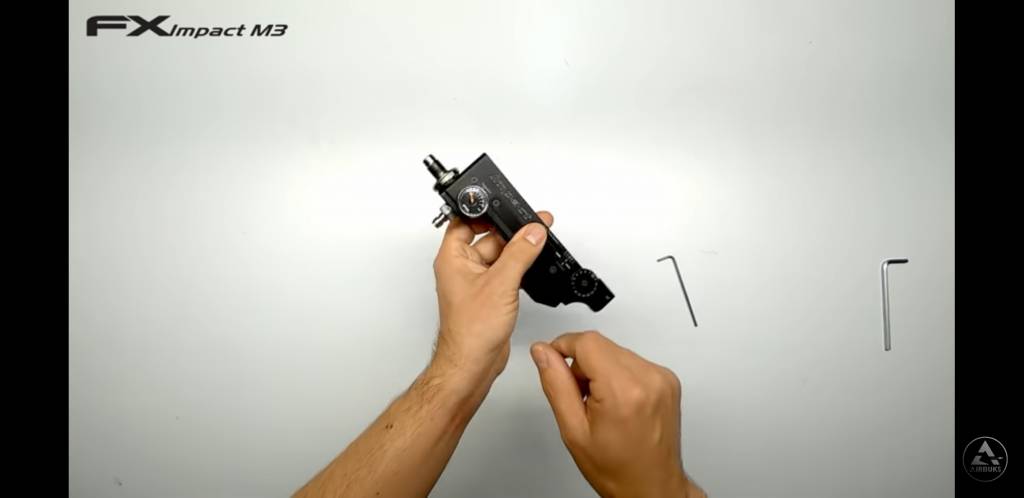

Saw a video this guy took the m3 apart. Looks to me everything is identical to the mk2 except the lower receiver which houses the dual reg and micro adjuster. I'm thinking, couldn't mk1 and mk2 owners just buy the lower receiver and convert their impact to m3? Seem simple to do. Anyone tried?

The plenum doesn't matter. Mk1 mk2 m3 can all use the 720 plenum. I've seen mk2 owners installing the 720 plenum with no problem. What I wanted was the dual reg and easy adjustment on the micro which the mk2 can't be converted to cause the receiver block is different. So was thinking why not just replace the receiver block and bam, got a m3 without paying $2200.

The rear block have a different part number cause it's for m3, so it will have different label/designed but still house the same plenum so wouldn't need to get a new rear block to convert. The rear block on the mk2 can also house the same 720 plenum.
What would need to be purchased would be
1. The 1st reg
2. Lower receiver/trigger block
3. A new guage.
4. Marco/micro adjustment, unless fx can make the trigger block with those already installed on it.
Never order a trigger block before but if what you said $600 just for that small block of aluminum is rip off imo lol. That cost more than a whole new pcp gun of another brand airgun. How is that tiny block cost more than a new pcp gun? Was expecting like $200-300max for the block, $20-30 for a new guage, $70-80 for the reg. Macro wheel/Micro adjustment $20-30.
Don’t forget to put a bottle valve in with your order. Oh, and the trigger is different with my M3 compared to my M2. Not sure if those components are compatible across platforms. So you might have to add that to your order as well.
Yes will need the bottle valve to use on the m3 1st reg. But I checked and that only cost $3.33. Won't break the bank. As for the trigger, I look at the video they took the m3 trigger assembly apart and looks just like the one on the mk2. So should fit, even if doesn't replaced trigger shouldnt break the bank. The expense part i see is the trigger block that house the 1st reg and mirco adjustment.
