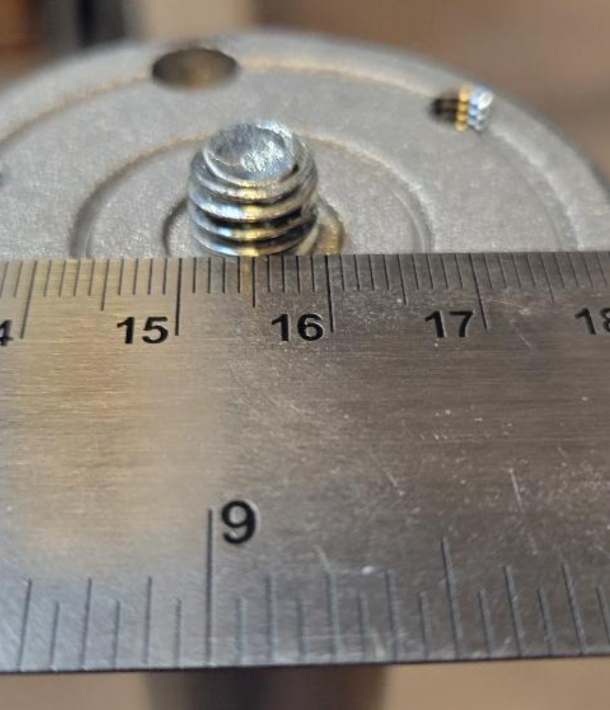

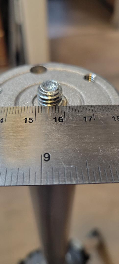

Three set screws removed and head unscrewed from threads below. Let me know if you need any other pictures. Right hand threads.

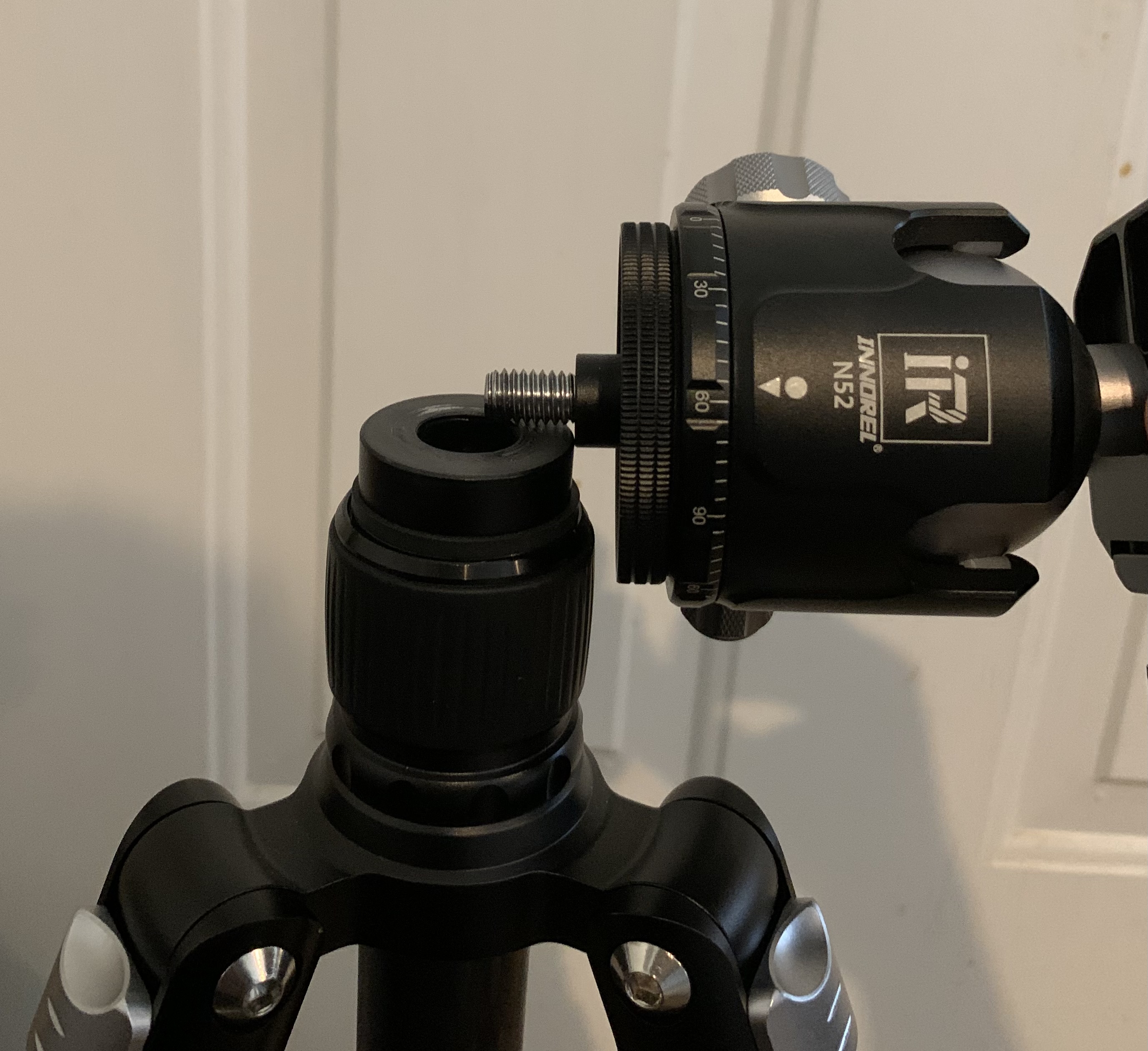

With the type of Innorel ball head I have, it should screw onto that screw. Some tripods come with a removable screw-on plate with a similar screw that protrudes up like the one pictured above. Check out some photos in this thread of the ball head taken off of the tripod for a better visual. https://www.airgunnation.com/thread...tup-advice-and-criticism-are-welcome.1099111/

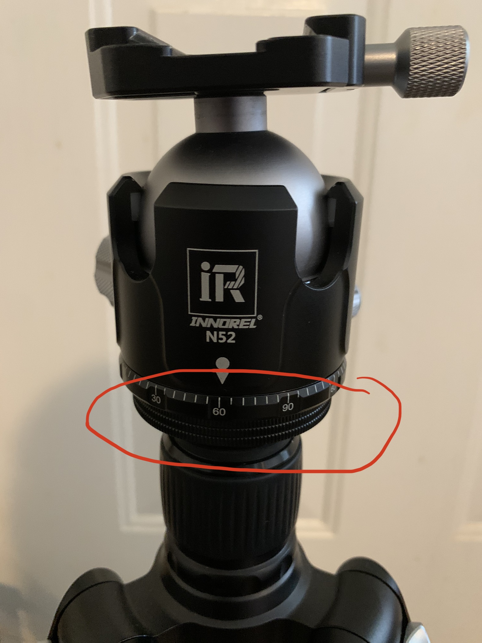

@Scouty I rushed and took these yesterday. I wanted to point out the plastic disc (circled) between the head and tripod. It has a bolt with threads on both ends and a nut in the middle that holds it in place within the plastic disc. One side of the bolt screws into the tripod and the other into the ball head. The screw in your photo looks similar. When I took these I accidentally unscrewed the disc and head from the tripod as opposed to the head from the disc. You can see the details much better in the link I provided in my previous post. Considering the weight tolerance of the tripod is a smart move.
