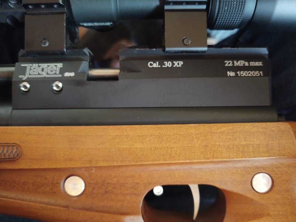

This is the rifle in which I installed the original regulator of my Vulcan 2 .30 Cal.
The block says 22 MPa max.
According to my conversion software it is about 3,100 psi.
The tube do not have any pressure data.
The maximum pressure for the Vulcan 2 is 250 bar. So that is also the pressure supported by the regulator.
If my conversion software do not fail, 3,100 psi is on specifications. My question was if it was safe to go from 3,100 psi to something around 3,400 psi.

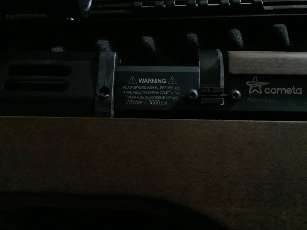

I’m in the same boat with my Cometa. My pressure rating is on my breech and not the tube. Without knowing what the tube is truly rated for, I error on the side of caution and just fill the gun to 200b. I mistakenly said 220b in my last post because I haven’t shot the gun in a while. Overfilling guns for just a couple extra shots just isn’t worth risking what we don’t understand.
