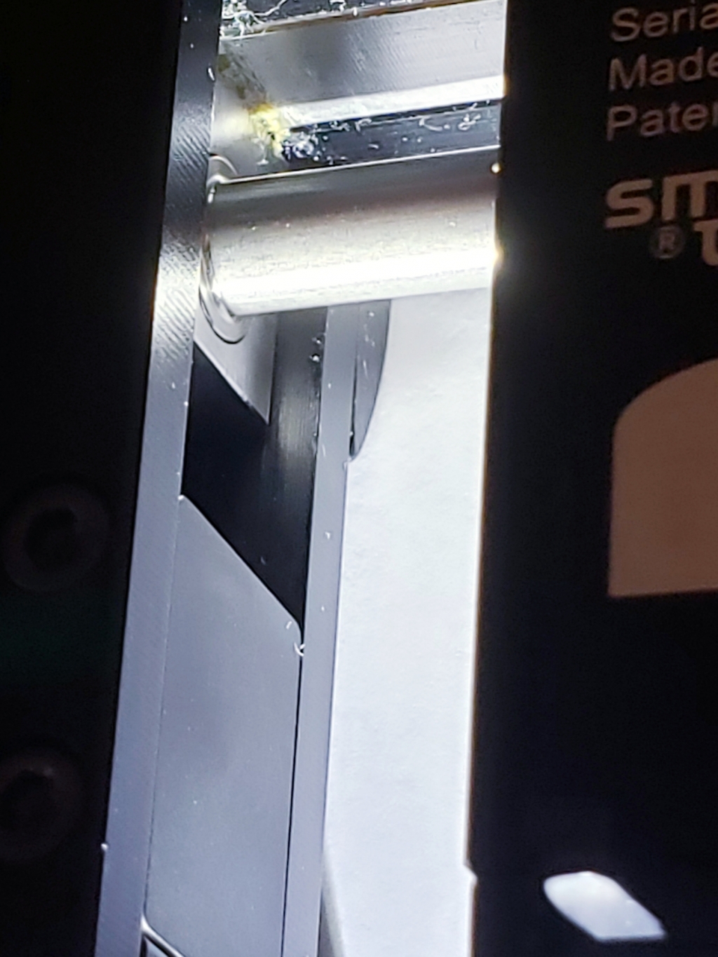

Can AnyOne Look At This Fx Impact Probe Location Please
After Installing the Power Plenum I haven't shoot it but,
this is the one location thats have me wondering about if I am good to go?
Having no leaks. Looking at the pellet probe in the closed position do I need
to make any adjustment to the probe position?
Thanks
RonT
Thanks
RonT
Ron-
Probe seems way too far back. My 3 month old Impact had a loose pellet probe (cocking?) rod and had walked the probe so far back it was pushing the shoulder pad away from gun while cocking! After removing the top plate and cocking rod assembly I measured the transfer port depth in the barrel and adjusted probe rod so port in probe lined up perfectly with port in barrel. The front of the pellet probe block should be almost flush to the black housing with cocking lever in full forward position.......maybe 1/32'" back from flush. Don't forget to loctite both ends of the rod.
