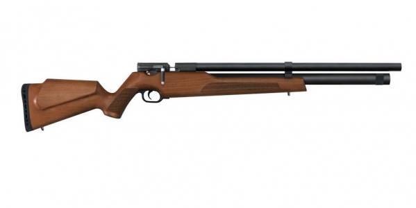

Check out what just came for under $300 . Side lever, shrouded, regulated, adjustable power and a 4350 psi tube !!!! Not sure about the two stage trigger yet..Also LIGHT compared to the lead pig gauntlet !! About 6.5 lbs. Nova Vista Liberty !!

Sorry, failed to get back here before now. Have been shooting the Nova Vista Liberty and am very..... pleased, have tried numerous pellets now and the barrel is not pellet picky. Shoots JSB 18.13's very well along with H&N Barracuda match 21.14, AA 16's and H&N sniper magnums and even Crosman Premier Domes. Have shot the JSB 18's and H&N Barracudas at 50 yards and both groups could have been covered by a nickel and that was with a bit of a breeze from 90 dg from the side. Chrony had the JSB 18's at 28 fpe and the Barracudas at 31.8 - 32.2 fpe, out of the box. May be shimming the hammer spring shortly to raise fpe on JSB's to at least 30 fpe. Also a couple new youtube videos up on modding the new Liberty.

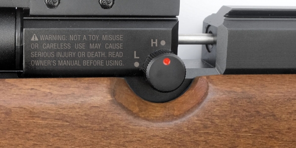

I have this rifle in .22 synthetic and love it. I’ll echo the accuracy statements from above. But I wanted to say that it is a lot more backyard friendly than my Hammerli 850. And don’t forget, you have a low power level setting that makes it a bit more quiet. My chrony numbers show that it meets or exceeds the advertised specs with a decent sized pill. The regulator is adjustable. There are some videos coming out now that show how it’s done. But out of the box, this thing is very much worth the $299 price tag. Fills to 300 bar (4350 psi) so you have A LOT of regulated shots even on high power before it falls off the regulator. I’d love to see this company introduce a .25 cal and one with removable reservoir.
Just my .02
Had my friend Keith over last Wednesday to see this new rifle, filled it to 3500 psi and shot 60 shots and it still had not fallen off the regulator. He kept asking if I needed to refill it yet. I also like the fact that all my Marauder magazines work with it too, they don't snap in quite as tight but they cycle just fine and haven't offered to fall off or cause a jam. Was shooting it tonight after work at 55 yards with JSB 18.13's and you could cover the group with a nickel and most shots were touching. As for sound level, at the stock setting without baffels it is as quiet as my Marauder was before adding a regulalor and twin spring system, and thats on the high setting. I just added a Crosman baffle system to it tonight from a NP2 from Pyramyd air for $6.00 and although it doesn't sound much quieter it does have a much lower pitch.. That was also a dry fire inside the house, so I know it will be quieter when shot outdoors with a pellet in the barrel. I also just recieved a new tin of JSB 15.89's to test tomorrow on my day off and if they match the guy from Indea's results they could be the most accurate to date. ( or not ) but in any case I know the JSB 18's and Barracuda match 21's with 5.53 head size are very good. I can't wait to stretch some shots out to 100 yards and see how they group. 70 yards is about the max I can get on my property though. Plan to do some chrony testing tomorrow if the weather is good, may also shim the hammer and possibly raise the set pressure on the regulator. If possible the ideal goal would be 30 fpe with 15.89's, 32-33 fpe with 18.13's, and 34 fpe with 21.4's, then see what they do on the low setting too. When I get some spare cash would like to order some nielson 23 grain hollow point slugs to try too.
