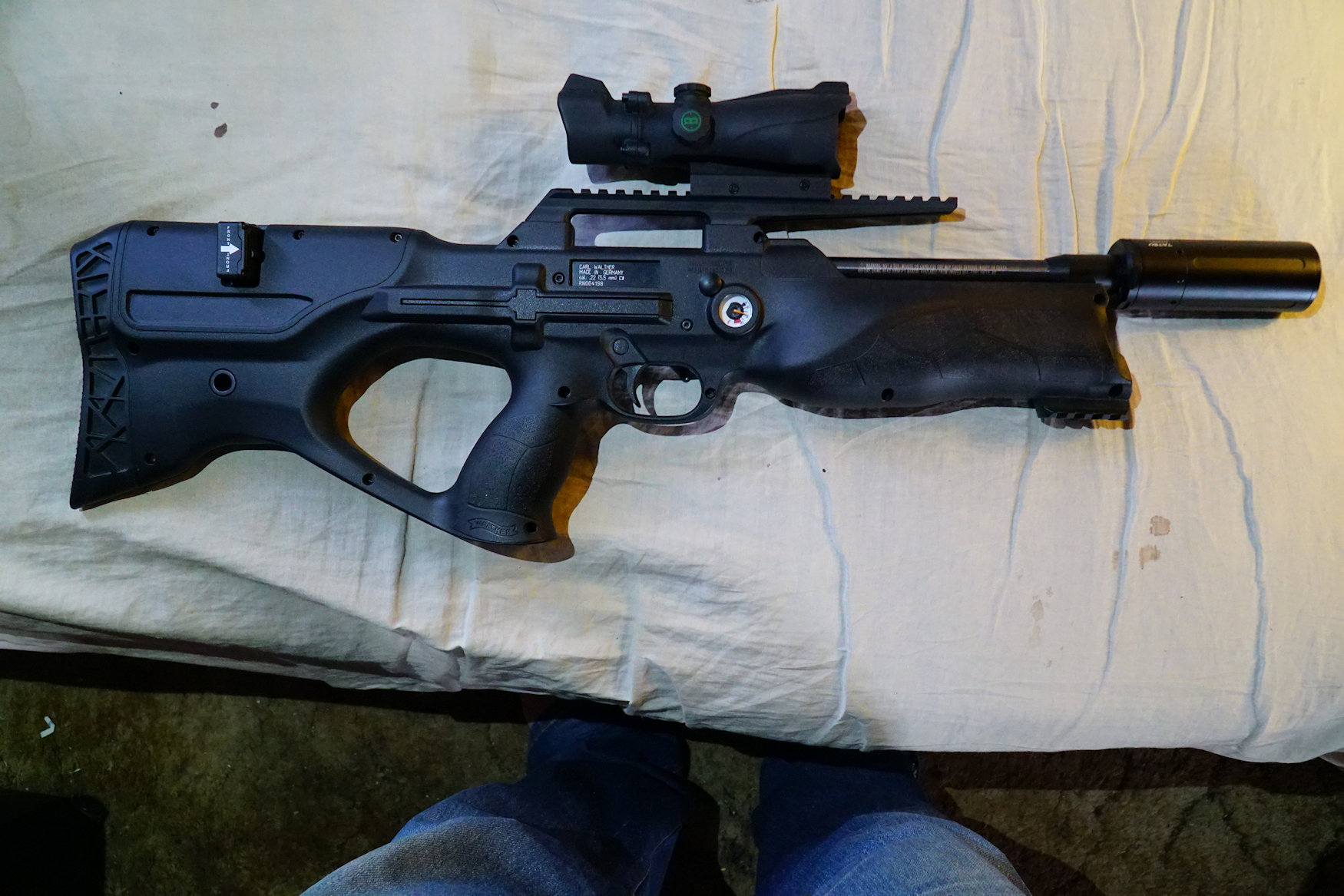

Yes, you can trim the barrel as short as you like, provided that you leave room to reinstall the suppressor. It may be VARY close to the air cylinder and ot the stock.
A clean end cut, with a nice clean crown in the bore. The crown doesn't have t be large or exotically polished, or a huge radius, or anything fancy. Just a clean, burr-free chamfer.
Then either a new thread of your choice, normally 1/2-20 . Or an adapter to attach to the end of the barrel to be able to attach the suppressor.
All pretty straight forward. What..."was at the end of the barrel", needs to be "redone" at the end of the barrel...where-ever the new end is !
The barrel below is almost 3.0" shorter than when I removed it from its box. Still shoots fine, as accurate as it was with its full length barrel. Maybe a few feet per second slower, but that of no matter to me.

Sure...any barrel can be cut. I've cut a few. If the barrel is choked i usually cut the breech end and machine it back to insure I keep the accuracy it had before. There are pros and cons to cutting a barrel though. Pro.. the rifle is a tad lighter. Rifle being shorter is definitely nice in certain situations.
Con... You will loose fps and fpe.. and will most in likely need to be tuned to the shortened barrel. If you in to doing the work...go for it! Or needing/wanting a shorter rifle sounds like a good excuse to buy a new rifle 😁
