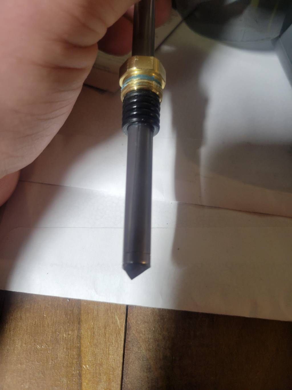

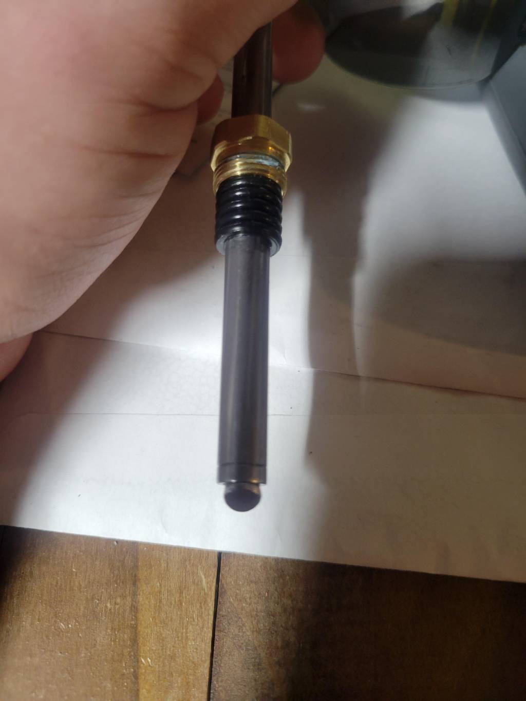

I cant figure out why my Crown MKII keeps doing this, see attached pics. Bone stock rifle, shooting NSA 23 grain slugs. Been shooting the same ammo since I bought the rifle. Just started this tonight. I have taken the barrel off a couple times, check and made sure the transfer port was tightened all the way, yadda yadda yadda. Idk what is wrong. It happens at random, juat shoves the slug against the end of the barrel and blocks it. Thanks in advance.

I modified the port, enlarged and oval shaped it on my impact inlet, and with the pin probe installed it did that also. With the stock probe there was no problem.
How much of the threads are exposed on the liner retention nut. Just wondering if the liner for some reason isn't seating all the way in the SS piece and up against the TP. Mine has 9 threads exposed. The liner should be butting up right against the shoulder in the TP with no gap available to grab the slug. As Airgunman said, maybe the problem is actually starting before it gets to that spot. Does it do that with pellets?
