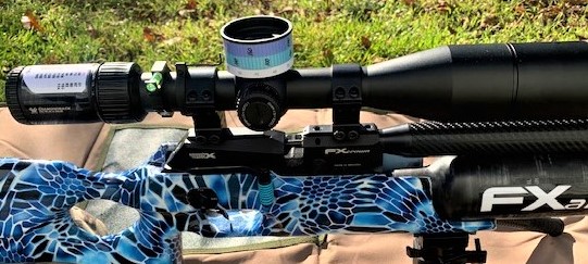

Two I know of.
Leapers UTG original full size 3-12x44 SWAT, non-IR reticle. About $140. Discontinued but I just bought one new last year. 30mm tube. I feel they area a GREAT scope for the money. Wade and I both have them on our Mrods and regularly shoot to 100 yards plus using the 6 mil-dots. The AO ranges to about 45-50 yards on 12X Decent glass for the cost. Target turrets with 1/8" clicks. Thin reticle.
Vortex Diamondback HP 4-16. About $300ish range. 1" tube. BDC reticle with 3 dashes below the crosshair. Non exposed turrets. Clear glass, thin reticle.
