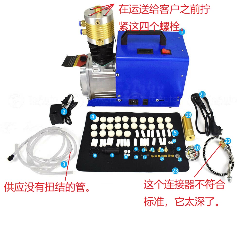

I made this picture for the manufacturer explaining the changes that need to be made to the big head knockoff. Hopefully they listen.
