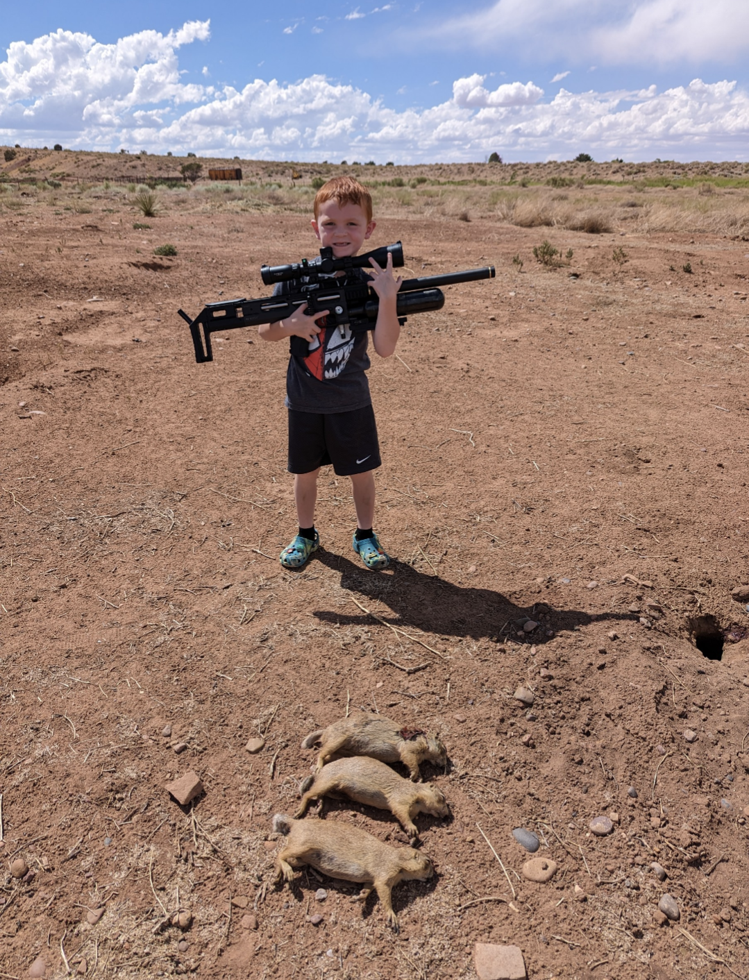

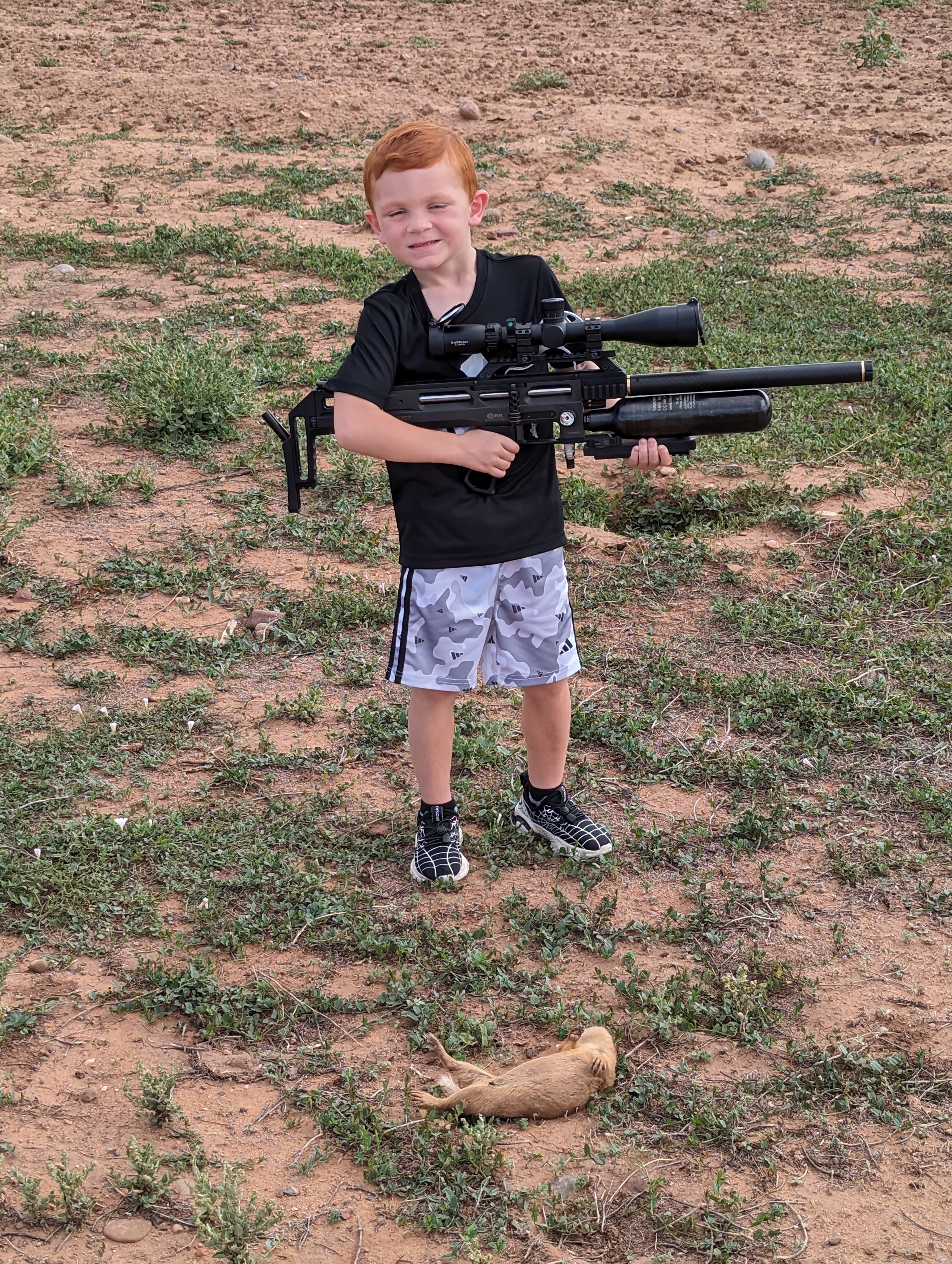

Don't tell that dead prairie dog my redheaded child (not step) killed him with the readheaded step child .20 caliber. Don't remember the distance om this one but this son was killing em out to 85 yards with the .20 pretty easily this summer. The other sons furthest was 105 or so, also with a .20. And I pushed it out to 220ish with the .20 slugs-witnessed by an adult airgun friend. Pretty worthless caliber if you ask me. 🤥
Found another photo, same redheaded kid, and same redheaded .20 cal gun. Same outcome, dead dogs.
3 shots, 3 dead dogs. These were only 50-65yards but Cabe and the .20 took care of em.
Nice pics.
Sighs your writeups regarding the 20 are making me look into it some and maybe get a rifle in it. As if I needed any more help spending money on airguns lols.
