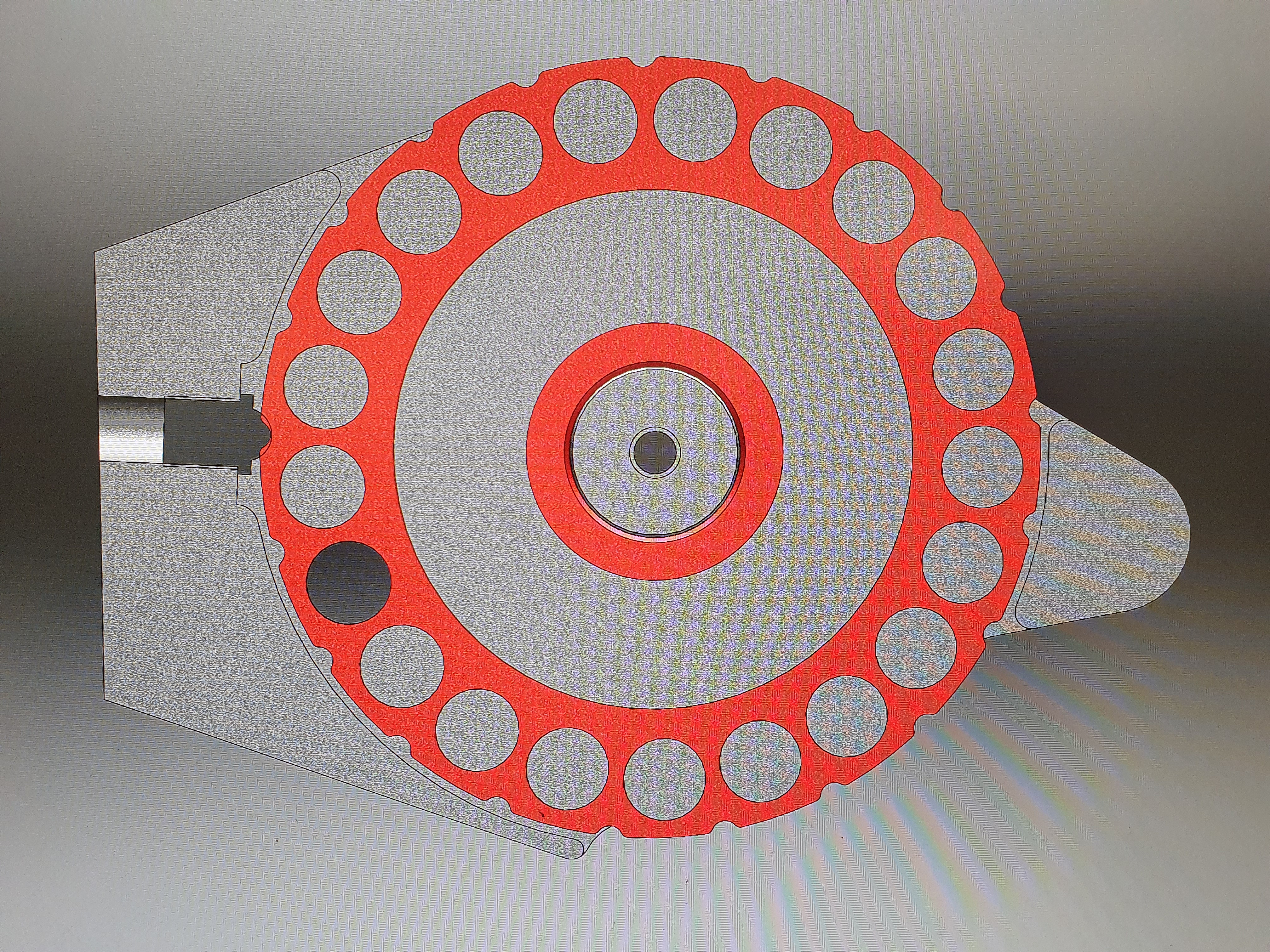

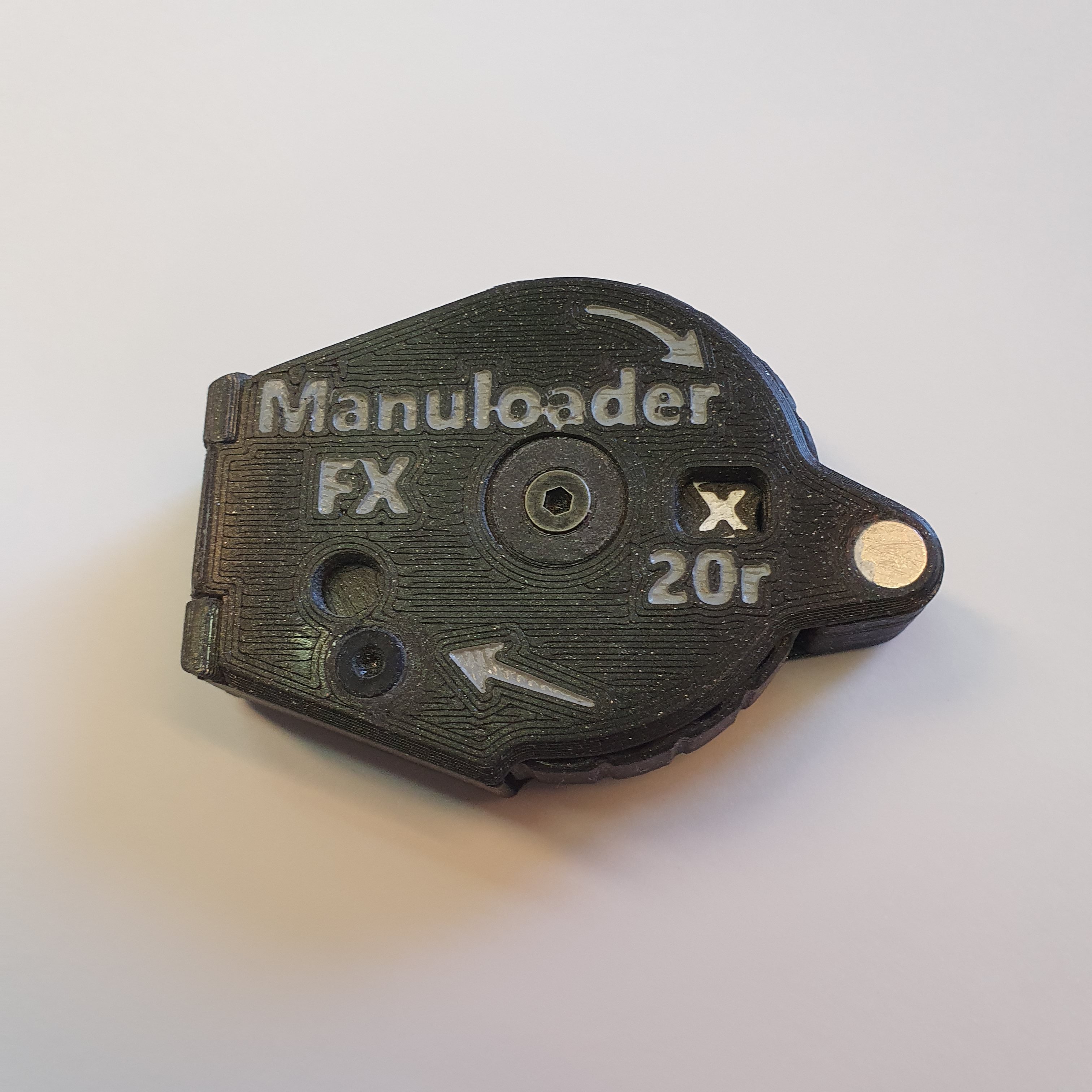

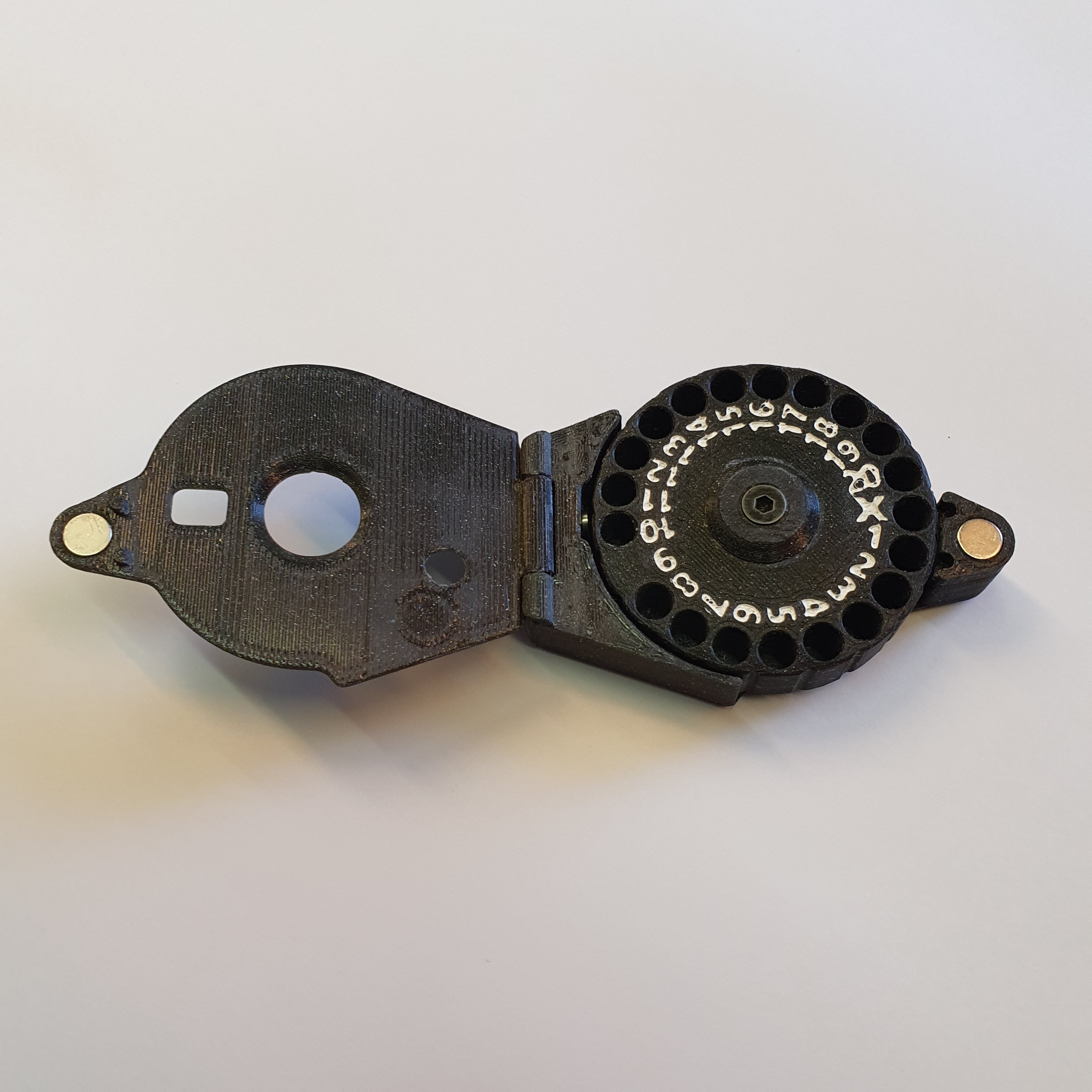

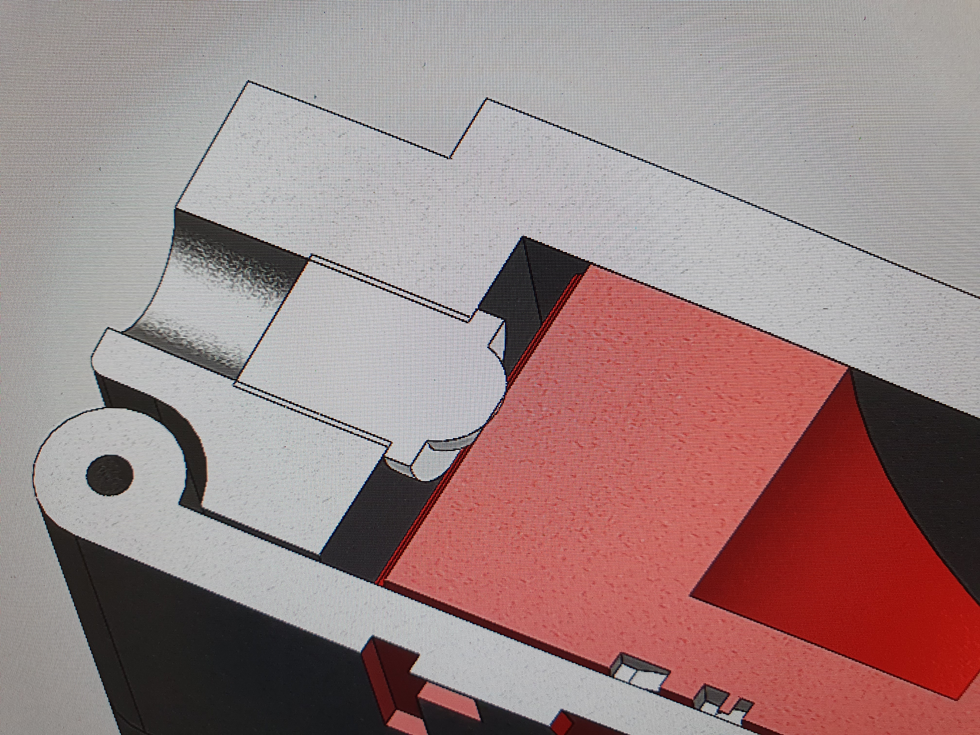

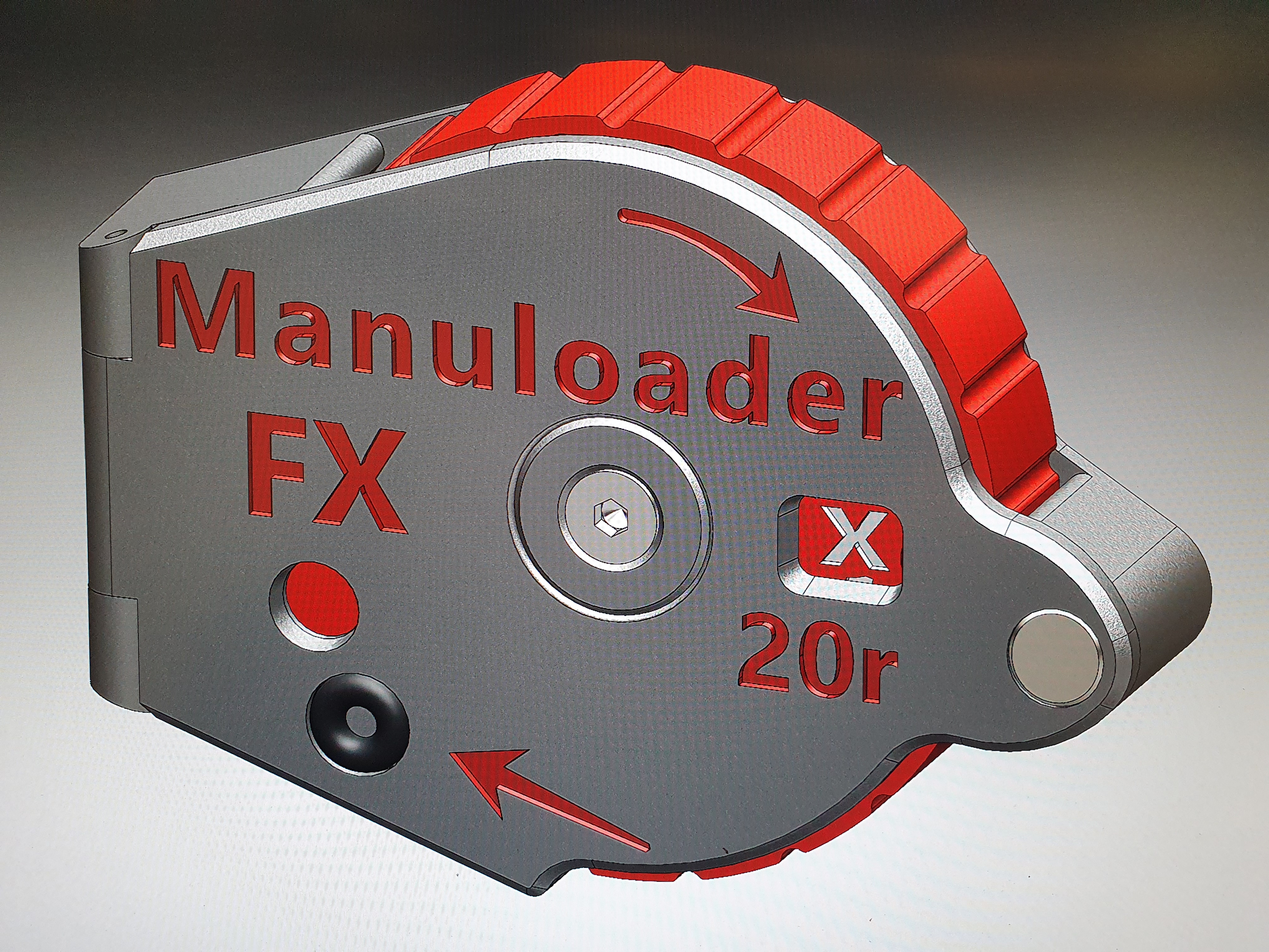

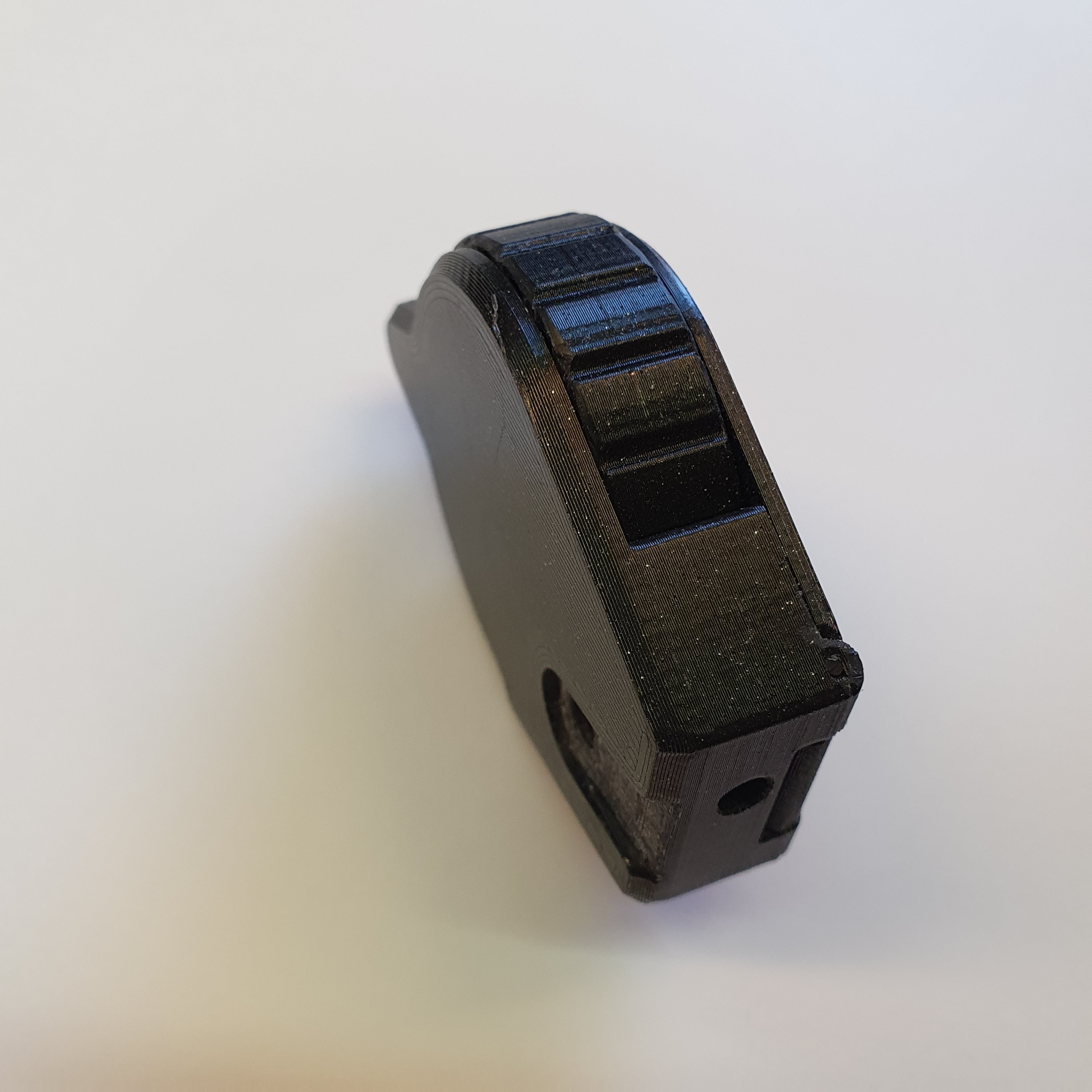

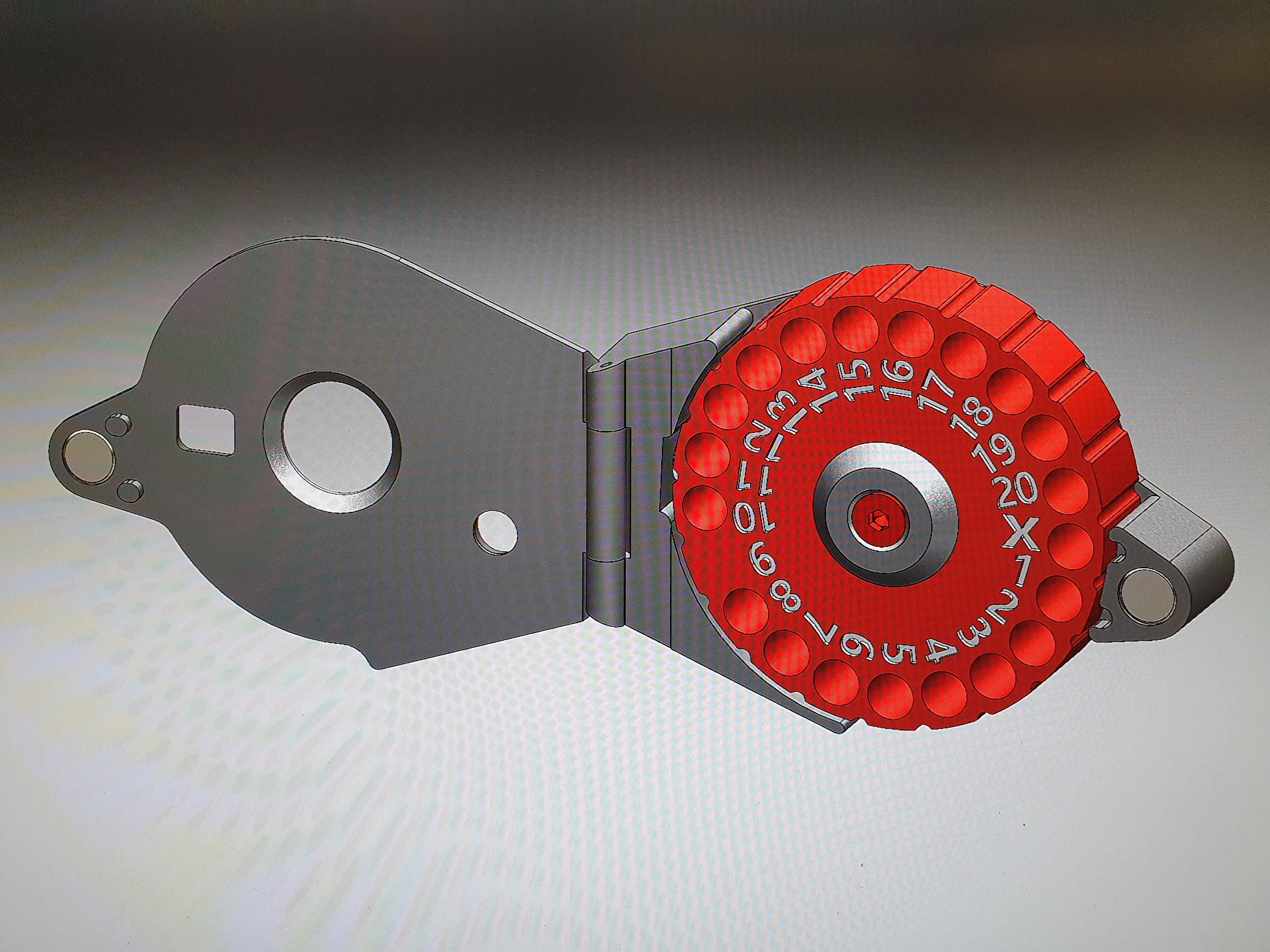

The reason for this question is that i designed a manual indexing .177 to my Crown and will do one for 22 as well. A lot of comments was that I should do one for .25 and .30 as well. But In my head there must be limited gain
image of my new manual indexing Single loader

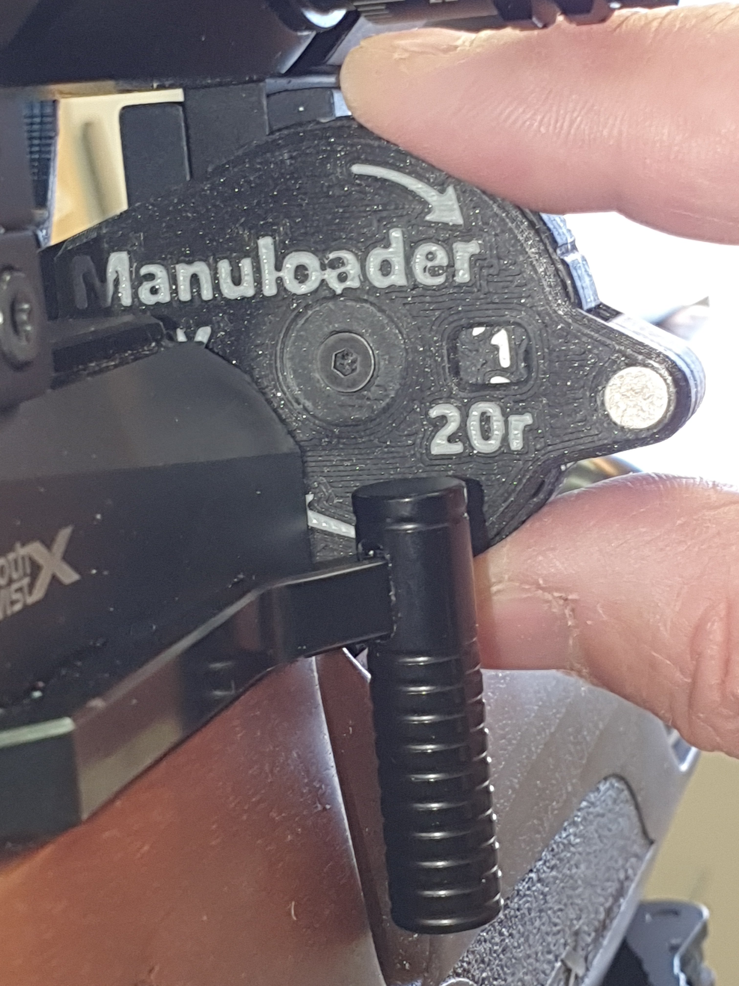

So I thought I'd try something different. Instead of chasing my POI thinking I had a problem reading wind or to wide of an ES, I started with 240bar in my big tank and also in the gun leaving the valve open. A near windless day I started shooting 5 or 6 shot groups keeping the same aim point. I shot 4 mags and I belive that @Bigragu may be correct. So now I am going to print a single shot tray to continue my test. Then I remembered seeing a post about a manual indexed mag and here I am.
I don't care much for SS loading and I am very interested in your design (once again) and looking forward to seeing results.
