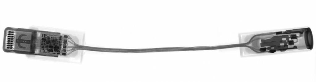

Just a thought with the adapters. The actual Apple adapters have a proprietary DAC in them. Have not seen anything similar in cheap adapters, only resistors, not unlike the cheap chargers. (although some of those have some chips that inject spyware). My last employer experienced the same problem with the adapter. It was needed for a product they manufactured and designed for the mic jack, not unlike the chrony. We found oem adapter is best, not perfect but best. This did not solve all the lighting to 3.5mm adapter issues but most of them. iOS updates and other firmware updates caused some problems as well.
