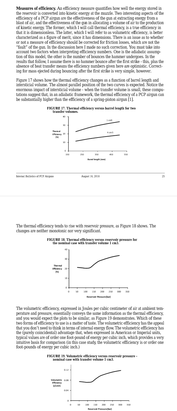

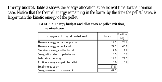

There is also volumetric and thermal efficiency. I personally prefer thermal efficiency! One can extrapolate here between volumetric and thermal efficiency...including where the energy is lost thermally. For those interested, the following information is provided courtesy of Domingo Tavella here https://www.researchgate.net/publication/326191398_Internal_Ballistics_of_PCP_Airguns and is something I was very vocal about (thermal efficiency and air's limited available energy) years before his wonderful contribution!
Agreed, for regulated guns, be mindful that a well-tuned gun will continue producing a stable velocity after the pressure has fallen below the regulator’s setpoint, at which point the plenum is contributing to the volume. You can avoid this source of error by stopping somewhere above the regulator’s setpoint. You just want to have enough shots recorded that the pressure has fallen by a meaningful amount (say, at least 500 psi), otherwise the poor resolution and accuracy of the typical gauge may represent another significant source of error.
