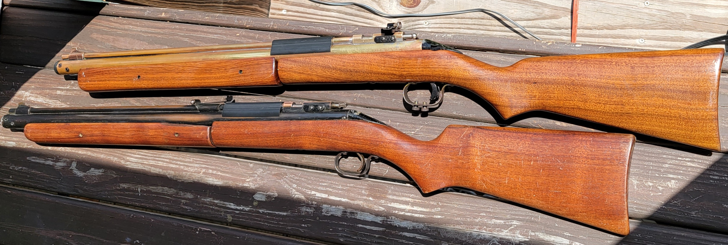

Someone removed all the black finish? Didn't Sheridan make some in brass finish? Serial number on left side of tube is 321848. Does that give up a manufacture date? I'm thinking it would look handsome with a bright polish. What to use? A little wipe with never dull didn't do much. I think shiny brass would look cool next to my silver streak. Thoughts?

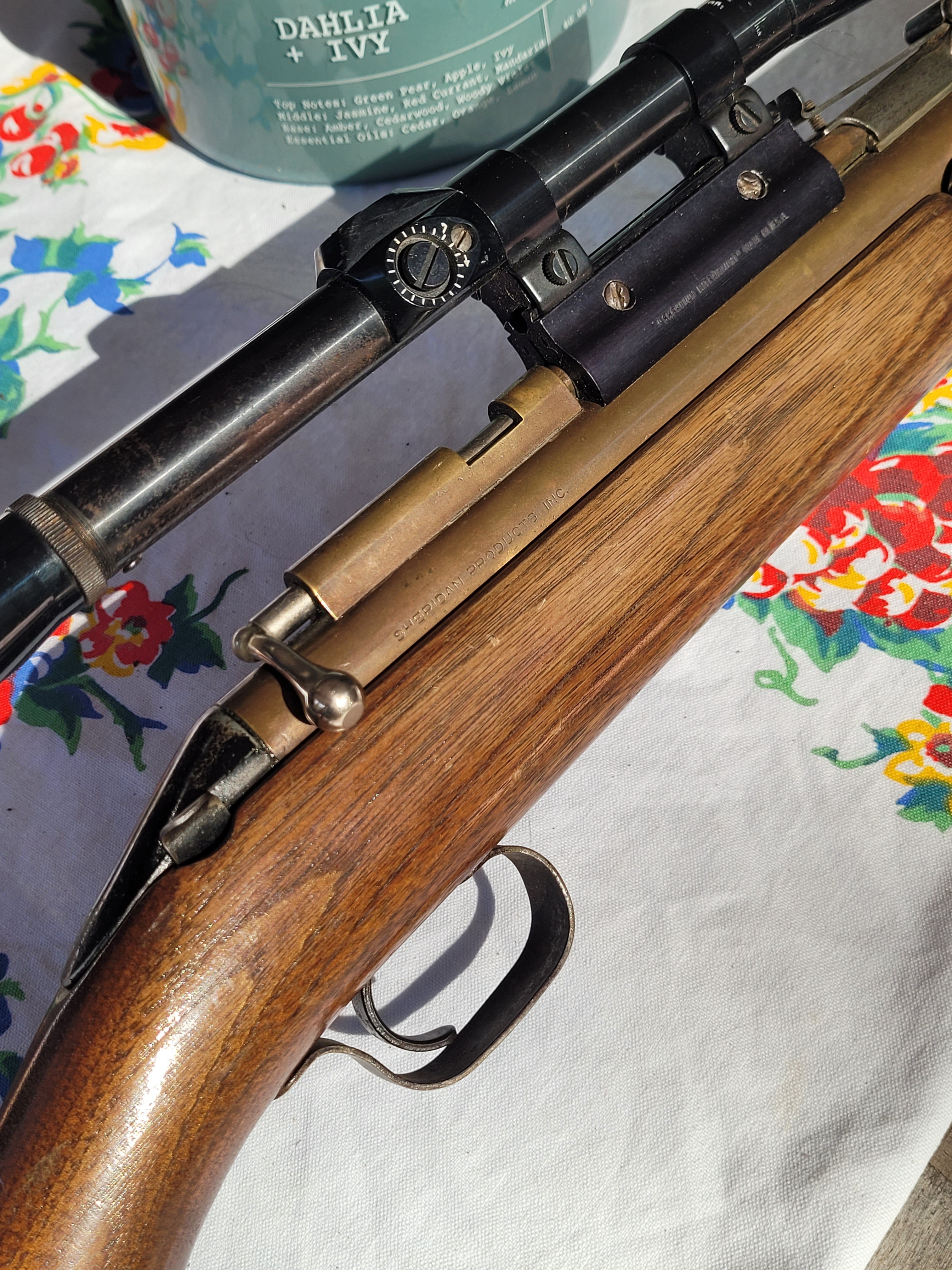

Doing a little research after posting, instead of before like I should have, says this could be 1974-1975. Sounds like this would be just pre Benjamin Era. The little weaver is cool and sitting on a Sheridan brand scope mount. Were guns ever shipped from the factory with this mount or was it only aftermarket sold by Sheridan?

Depending on what tools you have or access to supplies. Maybe try brasso and some clean rags first. If that doesn't work I'd take the oxide off with very light pressure using 0000 (4 ought) steel wool and maybe some mag wheel polish and then brasso. Wear rubber gloves so your hand oils don't leave finger prints. After it's polished, id clean it with a little acetone and wax it really well so it doesn't need constant maintenance. It will require regular maintenance. This is why I never stripped my childhood 392.
If you have some tools a cotton buffing wheel or ball will speed this up by a lot, it's not awful work tho.

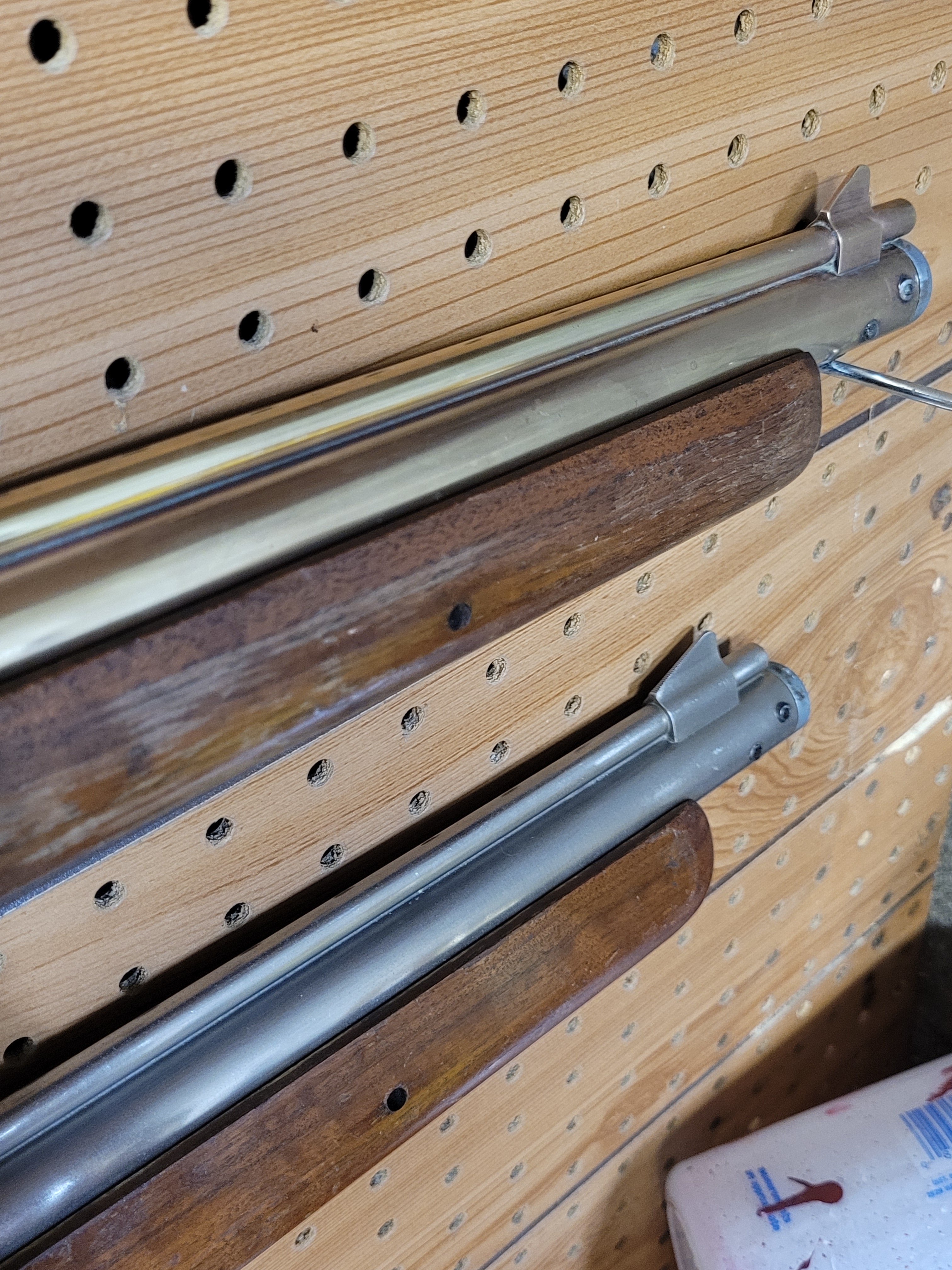

Yes 6gun, Brasso is working like magic. Pic doesn't do it justice. Silver Streak looks grey. I wonder if the brasso will hurt the nickle on it.

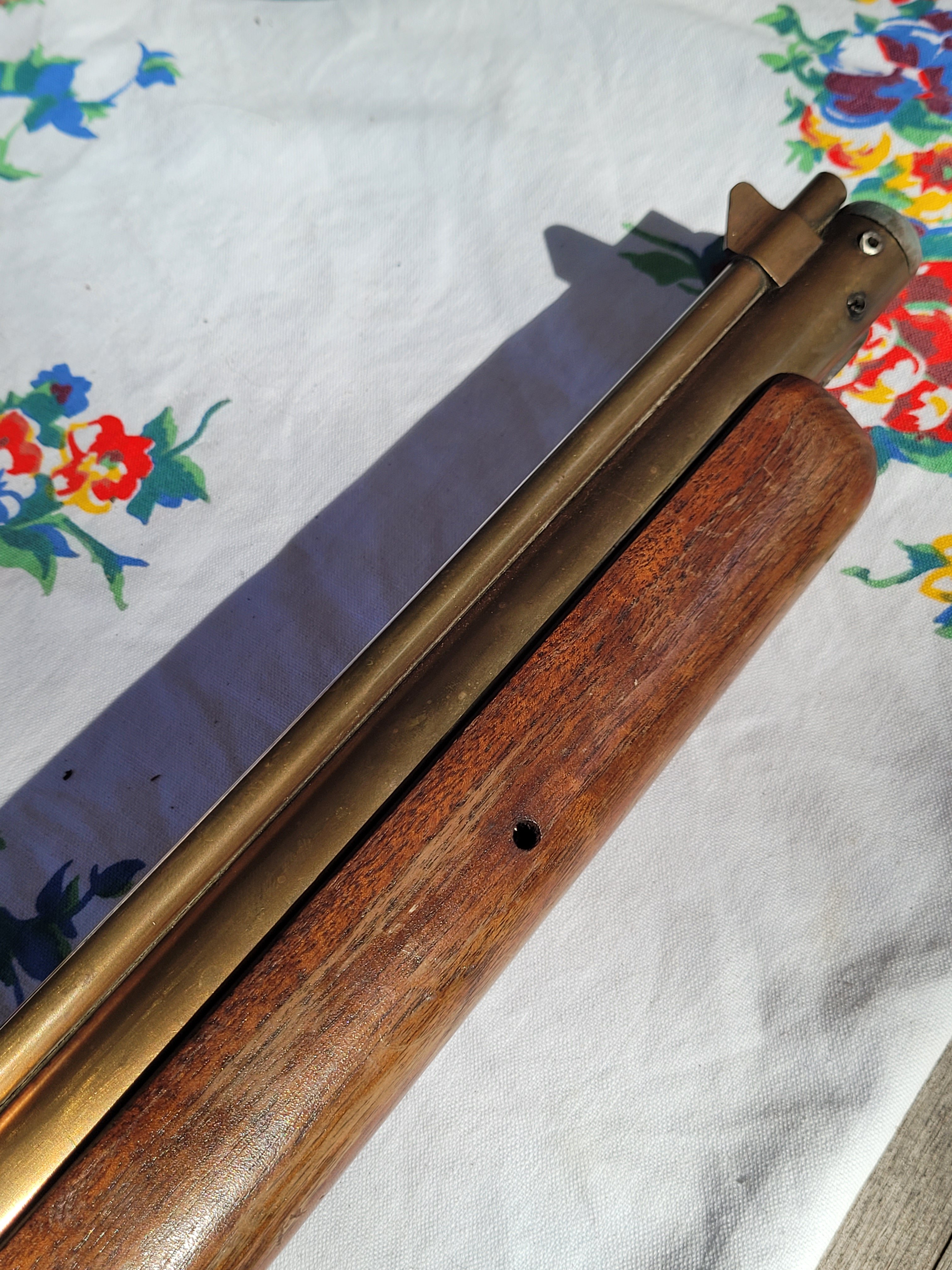

I'll likely pull the brass colored one apart to get in the nooks n crannies like around the roll pin holes etc. I want to refinish the walnut anyway. Was the grey end cap under the muzzle ever painted or always left unfinished?

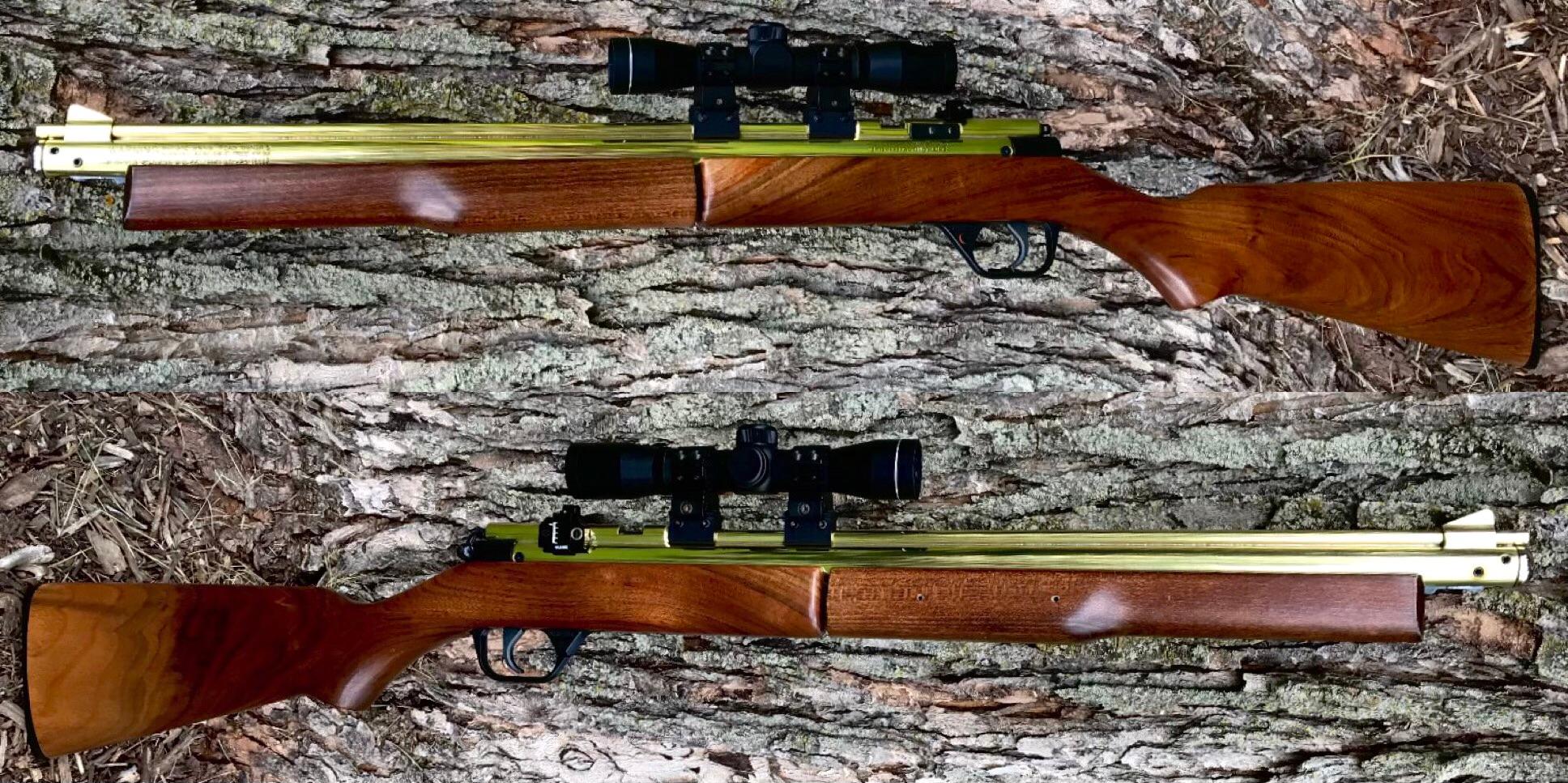

I had a black parco survival 22 with the built in foot pump.. I got it scratched up and I saw it was brass underneath the flat black finish, so I disassemble it enough to get all the black off with fine steel wool.. I think I might have used a cloth buffing wheel for a very good bright polish and then I gave it two coats of acrylic clear coat.. was and stayed absolutely gorgeous.. it's on that got away though one hard winter with little work available, ended up selling most of my exotic air guns but it kept my kids in clothes and food..
I'd definitely recommend two coats of acrylic clear coat and then there's basically no maintenance.. get a good quality one and once and done..no more repolishing and I'd likely polish the nickel one and do the same.. then it's always bright nickel.

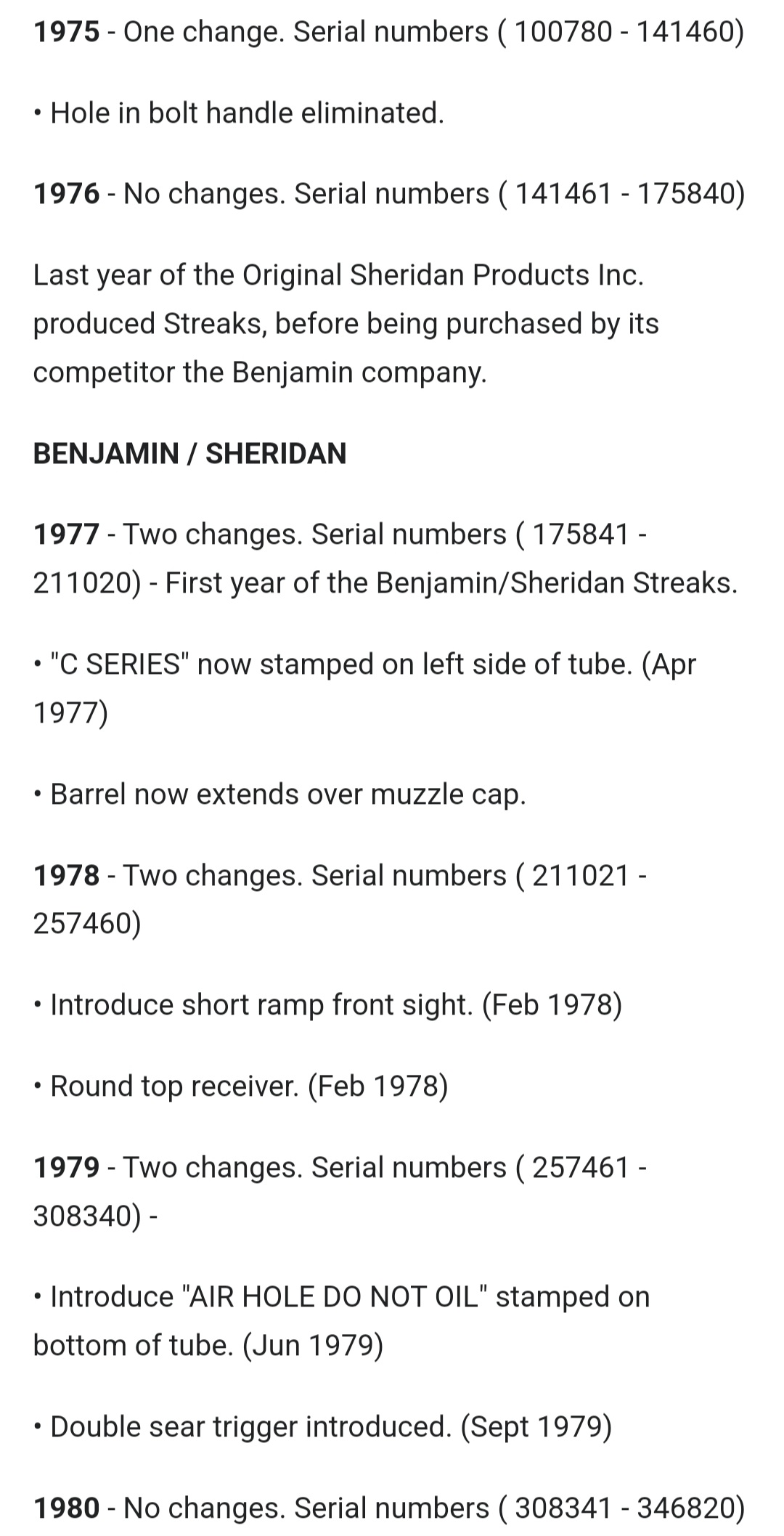

How did you arrive at 74-75?
321848 is 1980.
Your finish was likely polished off down to the brass like I did mine many years ago.

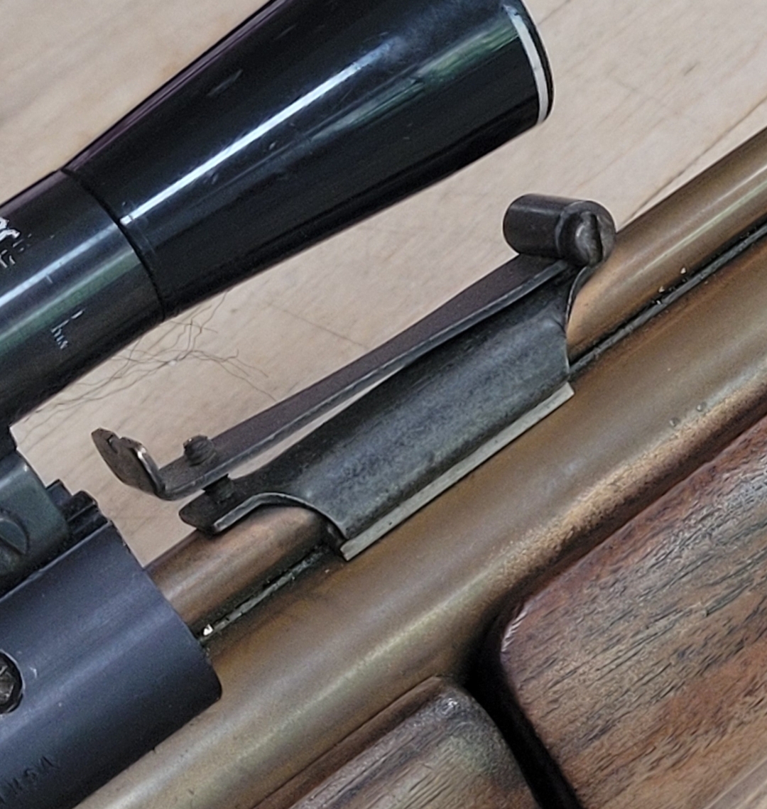

The rear sight has two wedges under it. It can be removed by carefully tapping it off the wedges.
The Sheridan Intermount scope base, is from Sheridan.. I got mine by mailing a check to Sheridan and it came to me in the mail, probably 1973 or so.
I have polished my brass to a beautiful finish a couple times, but it doesn't last long. It would need a clearcoat to lock in the luster.
Nice rifles you've got there! 👍
How is the rear sight attached? Just tight press fit? Can it be removed to clean under and close to it?
The rear sight is held on by the tension applied to the wedges lodged between the tube and barrel. You can pull the scope mount off and then drive it to the rear. That will push it backward off of the wedges. I put electrical tape on the barrel to prevent scratches and use gentle taps with a hammer on a wood block to preserve the sight's finish.
Those scope mounts are known to cause the barrels to separate from the tubes on the Sheridans. The sight mounting wedges add to that stress.

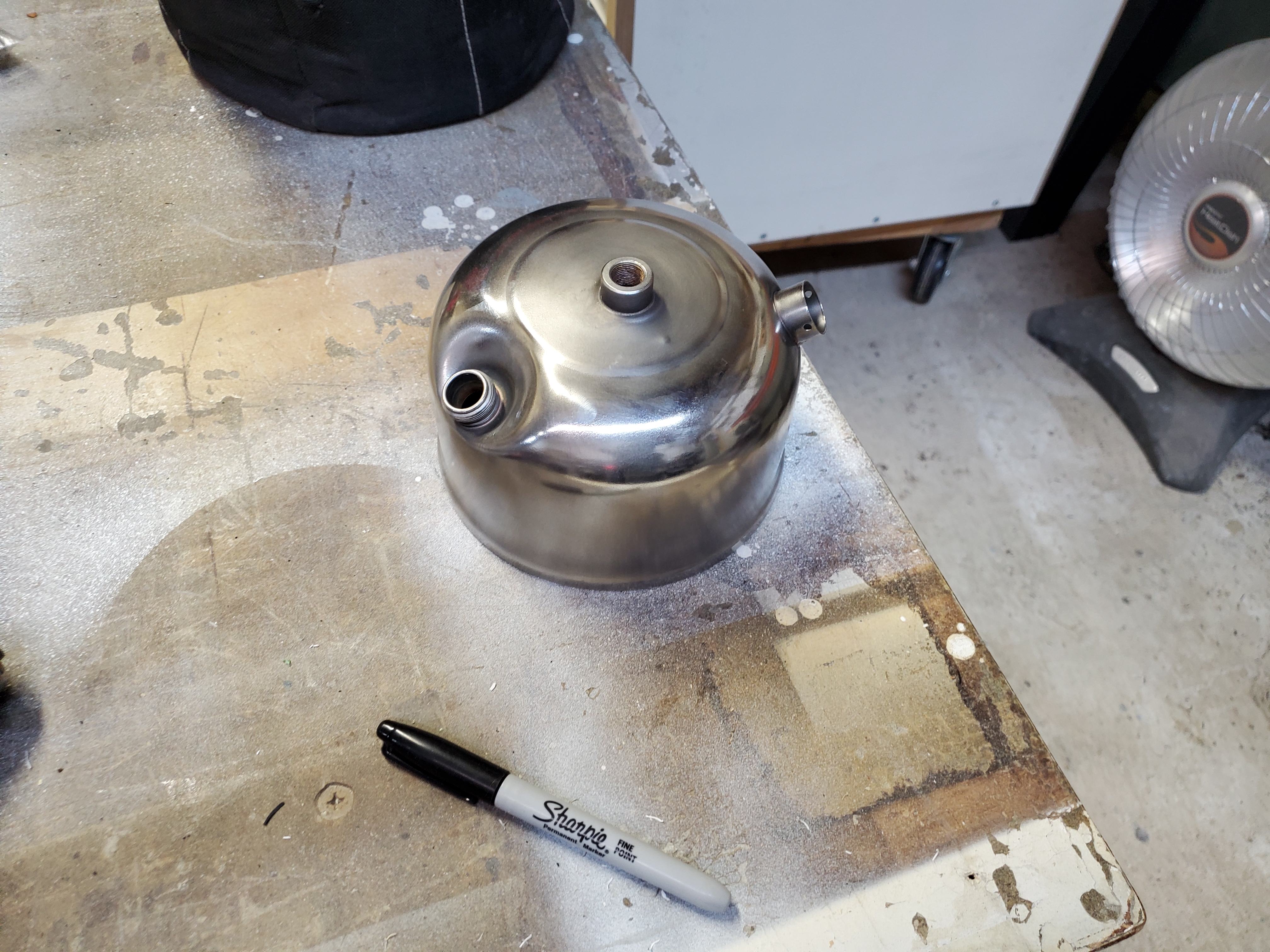

OK, it's not at airgun but I just want to reassure you that brasso won't hurt it. I plated this coleman latern fount with nickel battery tabs and vinegar (it's not a thick plating) and buffed it out with brasso and a cotton ball on a die grinder at some scary rpms. I didn't burn thru any of it. I think you'll be ok.

I will agree with the clear coat idea but suggest an alkalyd. Only because I can speak to it's durability. If you have an air brush it gets even better because you won't worry about over building the finish on such a cool gun. You have tapped into a gun that is a core memory for me and keeping antique machines alive.... All the dopamine. 😁

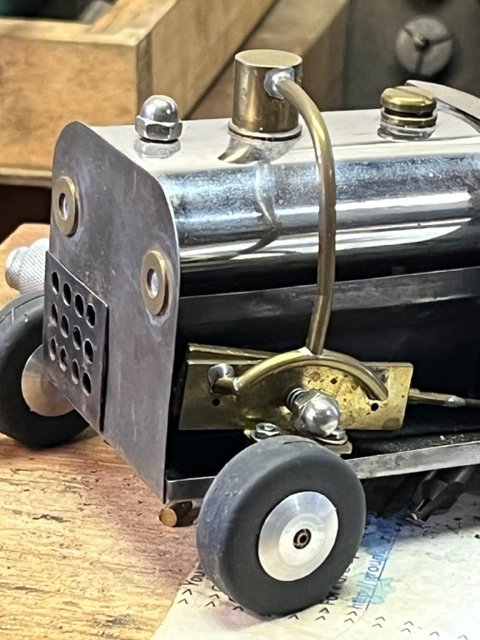

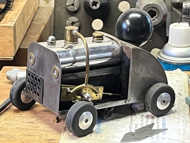

Here's a link to a discussion about clear coating brass. I've made a cool steam engine or two
View attachment 588103View attachment 588104
I have to get acquainted with the general off topic discussion sub forum here. I have so many questions. Live steam is something my grandfather did and I never got to see it or work on it with him. My dad was a fine furniture building hobbyist, out of nowhere I picked up metal pretty well and I love your steam car 👍 the fun tie-in id
