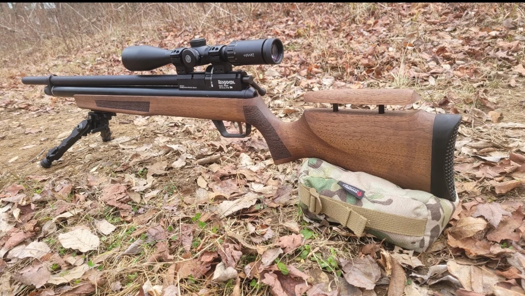

I am thoroughly impressed with mine even being the unregulated version. I purchased a brand new Marauder .25 from pyramyd air and received it last Friday.
Now keep in mind the .25 is unregulated and has a Crosman barrel not an LW.
My biggest gripe is shot count, with the .25 it is a magazine then refill but I will fix that (more on this later).
When I unboxed it I was pleasantly surprised with how gorgeous the rifle was (I also was told I hit the stock lottery) . It was also much lighter than expected.
I purchased this rifle for a specific task of long shots 60 to 90 on birds, rabbits, etc , maybe even 100 (which it proved it could do).
I love the trigger ,I own an uragan 1 , taipan veteran, and an airmaks caiman, the Marauder trigger comes in second only to my Taipan (clearly).
I have not really tuned the rifle yet and I'm not going to adjust it from this point until I get it regulated, now I talked to Tim Hill and he told me 30 shots around 880fps with 25.39 which would make this rifle an absolute game changer and it would still come in at under $1000.00 and I'm pretty confident that at that price it would still punch better and be more fun (I think the fun factor comes mostly from the true bolt action of the rifle, gives ya a "popping german heads in ww2 feel") than rifles 4 to 700 dollars more, it will never be a slugger for me but I have only shot this rifle one day and these were my results with just an hst adjustment so this is out of the box after a barrel cleaning which I highly recommend.

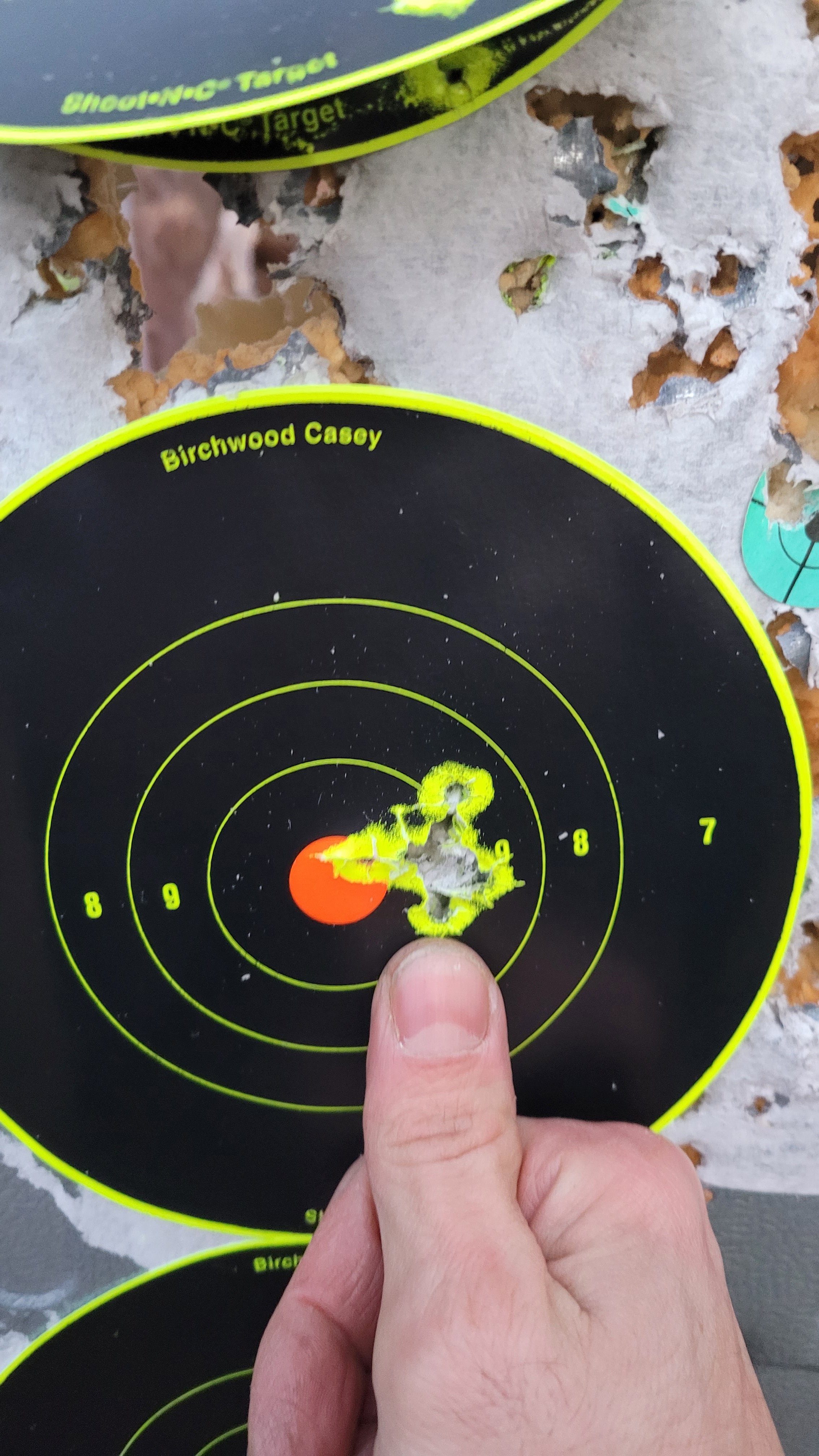

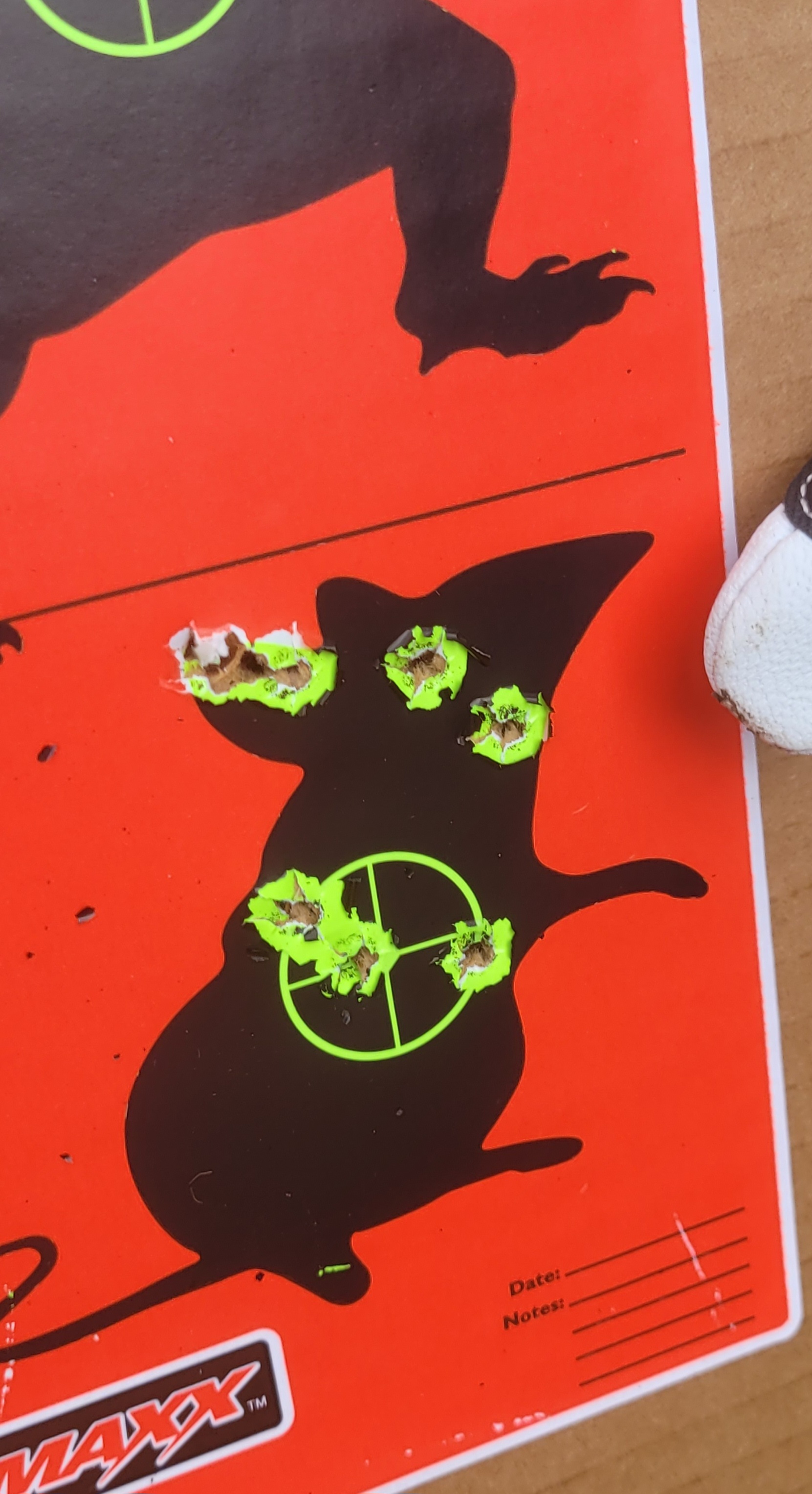

First group is 55 to 60 yards, I can't remember the exact yardage as I'm very familiar with my home range and just plopped the table down
Second group is at 101~102 yards, with pellets, that honestly have a pretty poopty bc.
These are full magazine groups. With minimal time behind the scope. I'm not saying it's the greatest rifle in the world but what I am saying is , I was thoroughly surprised and impressed.
