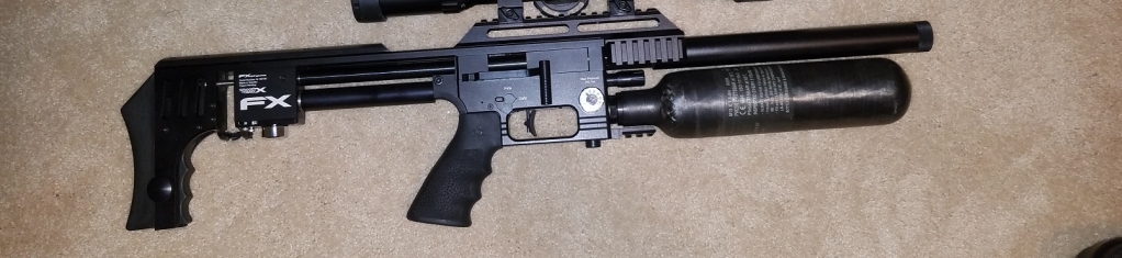

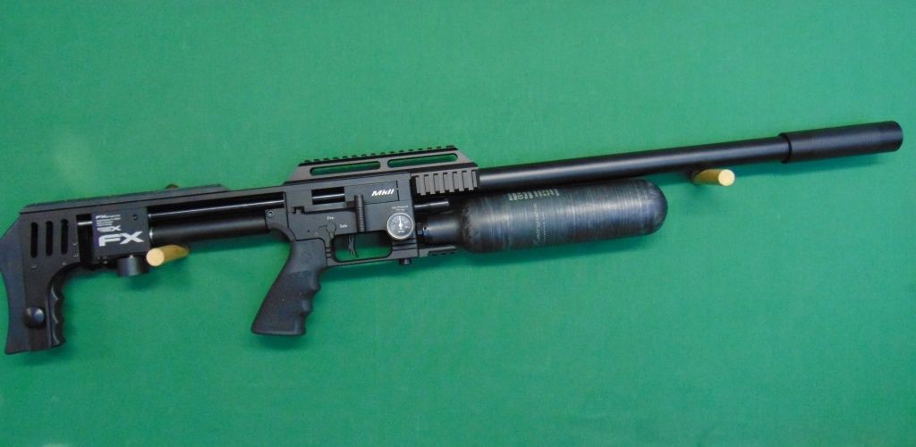

The first picture is a 600mm barrel, the seccond 700mm. Both guns using the same FX stock moderator. I know it is a bad picture, but tried to take both on same angle and position. For reference I also put a stock FX moderator on the floor, which is 12.5 cm long. I am 178 cm tall, and believe I have normal length arms:)
I don't think its a bad photo at all, it shows exactly what you were intending to show. thank you for taking the time to show that for me.
