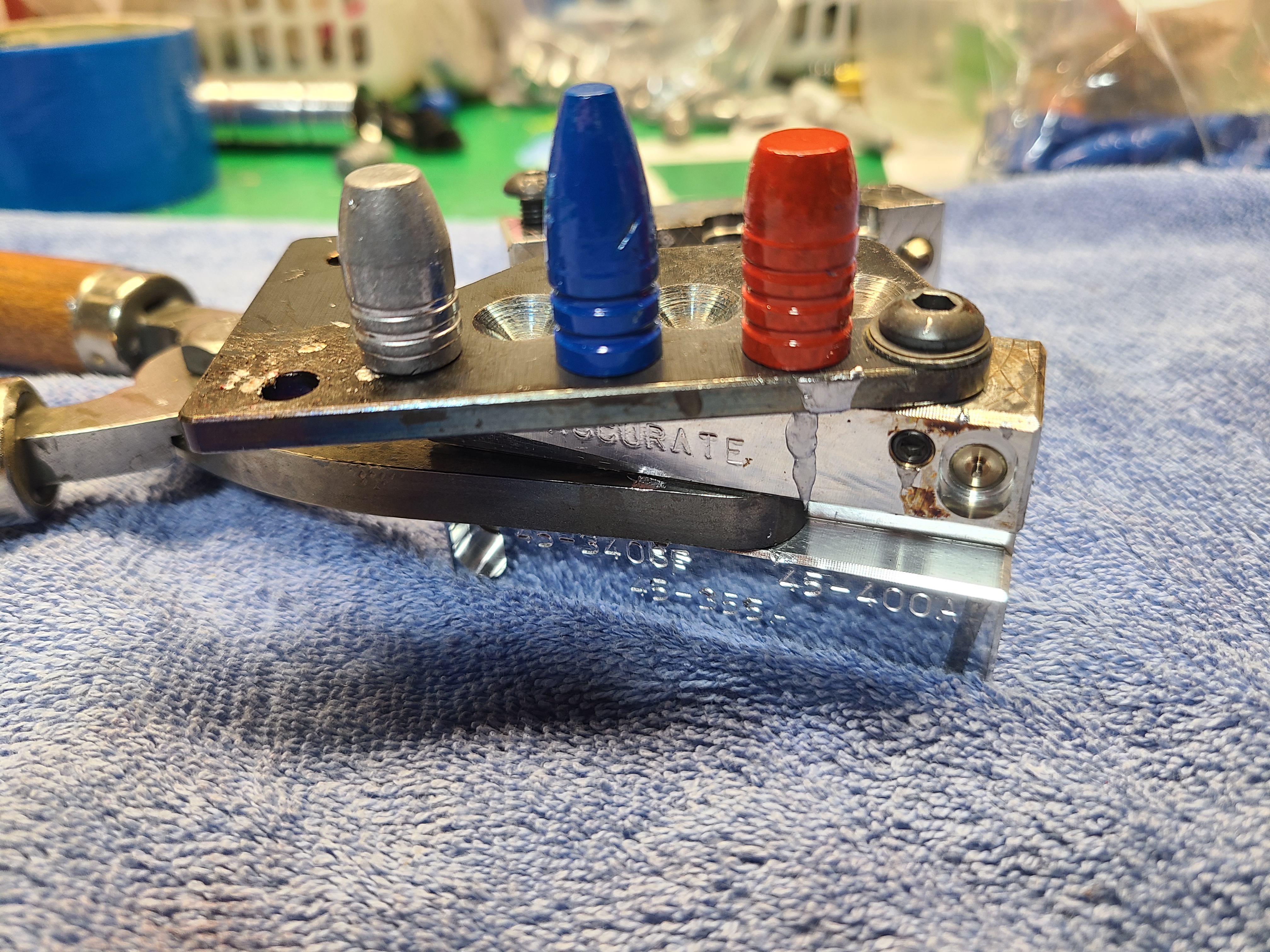

Getting the itch for fall deer hunting. Checked my scope zero and made a few minor adjustments and ready to go. Shooting 350 grain from my Bushbuck Carbine at 50 yards. Good enough. The spire point 380 grain shoot a one ragged hole but not much wound channel. Mold is a Accurate that drops 3 bullets 315, 350 and 380 grain.

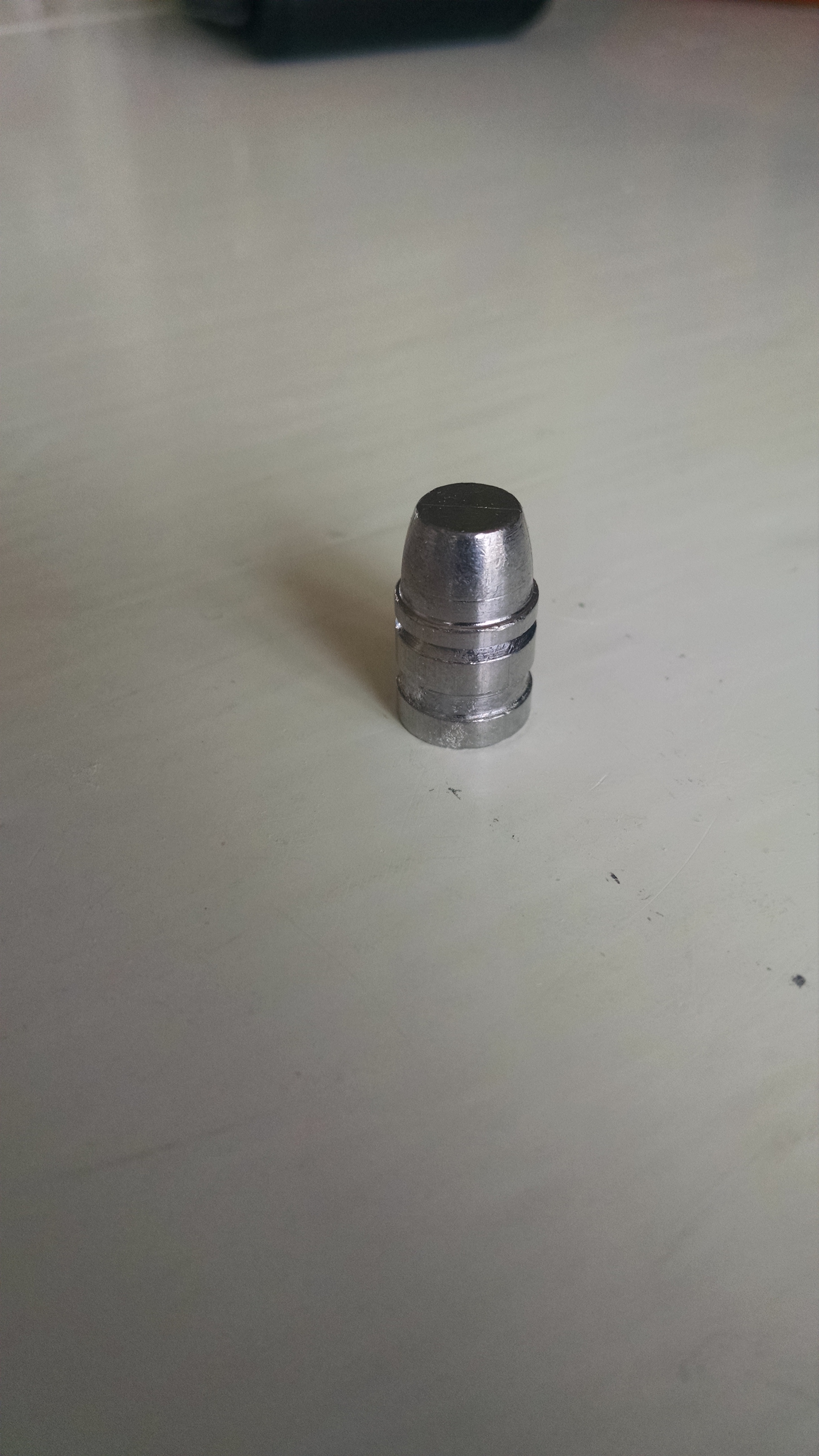

An ol timer did some homework a few years back and found that a large meplat (flat nose) is necessary to make a major wound channel which proves to be much more deadly. Spire points bleed much less.
@shamu I get that. I’ve learned a similar thing. My understanding is that spire points work well for certain applications. So considering that you’re hunting white tails, I was wondering what you intend to hunt with your spire points and Bushbuck.
and leave tiny entry holes, and if they don't upset going through the deer, tiny exit holes from the hide stretching around the bullet. Makes for challenging blood trails. Big flat meplat can punch a bigger hole in the hide.

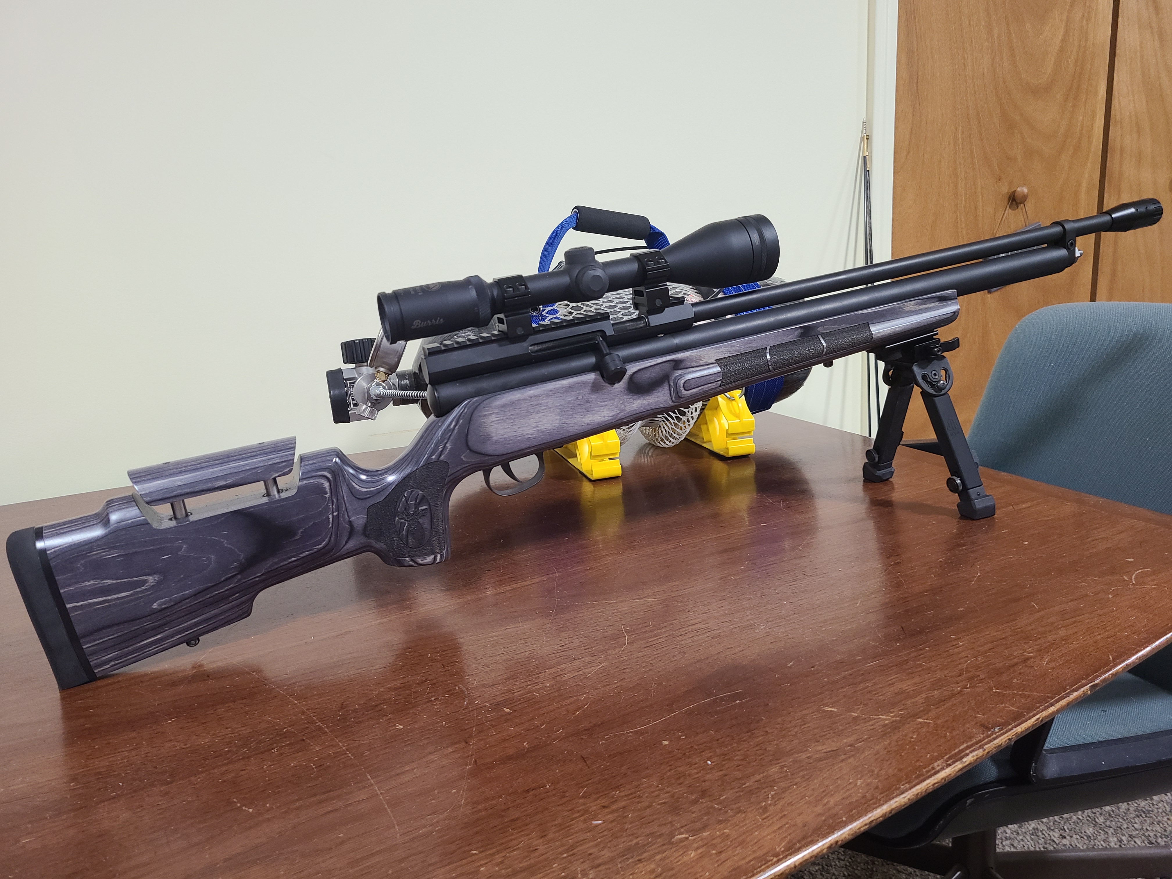

Nice rifle and great looking projectiles.
This will be my first year hunting deer with my new bushbuck.
