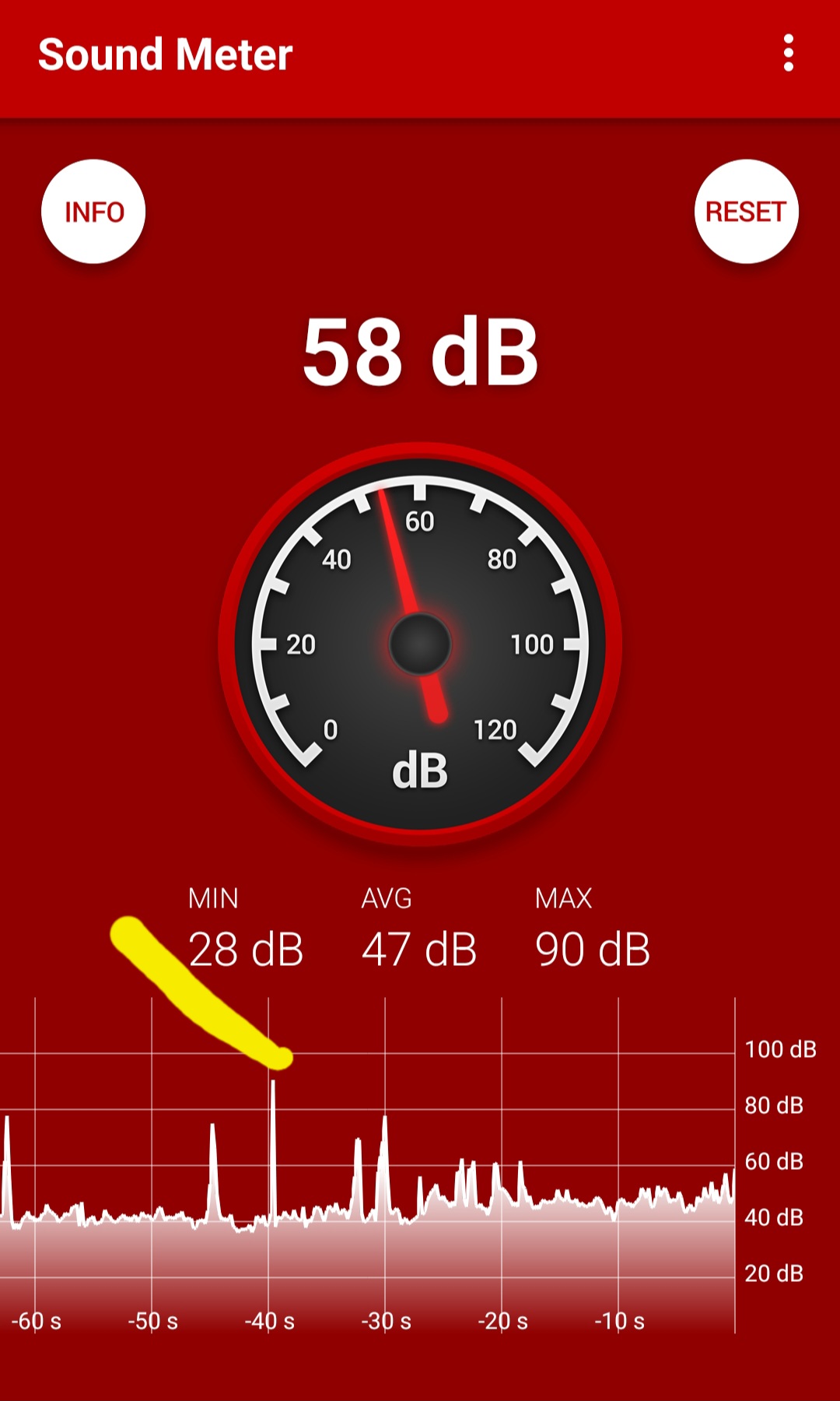

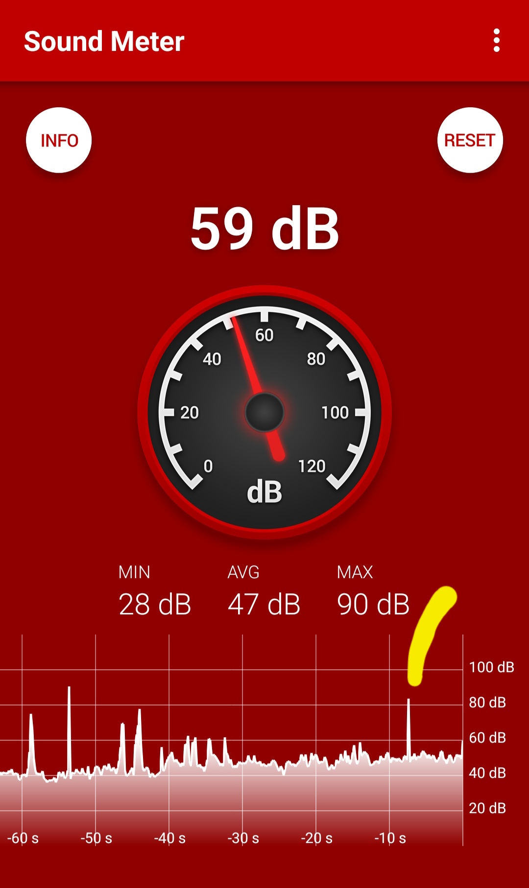

I don't know what I'm doing truly but these are the two readings I got.
First one shown at 90db was the shot with the factory 6.25 inch hps moderator
Second picture has the shot around 82 to 84 decibels it looks like with the smaller , lighter 4 inch Wylie Kanz moderator meant for my evol mini.
The phone was placed about 40 feet in front of the rifle so my 35 to 40 seconds of tooling to swap moderators would not interfere with the metering. Unsure if this is right or wrong.
With that said sitting behind the rifle it is much more apparent as to what this moderator is doing, to my ears.

So you MEASURED a 6 dB difference between the two shots. That's pretty good. Three deciBels is a halving of the aggregate audio power measured. So the second measurement means your friends moderator cuts the power by a factor of 4 better than the stock moderator in 62% of the length. Again that is pretty good. While I am not going to spend $180 for that kind of performance (because I am price sensitive) that does not mean someone else (or many other folks for that matter) won't. That remains to be seen. He does very nice looking work and the moderator seems to work exceptionally well given the form factor.
Now was that really all that hard?
