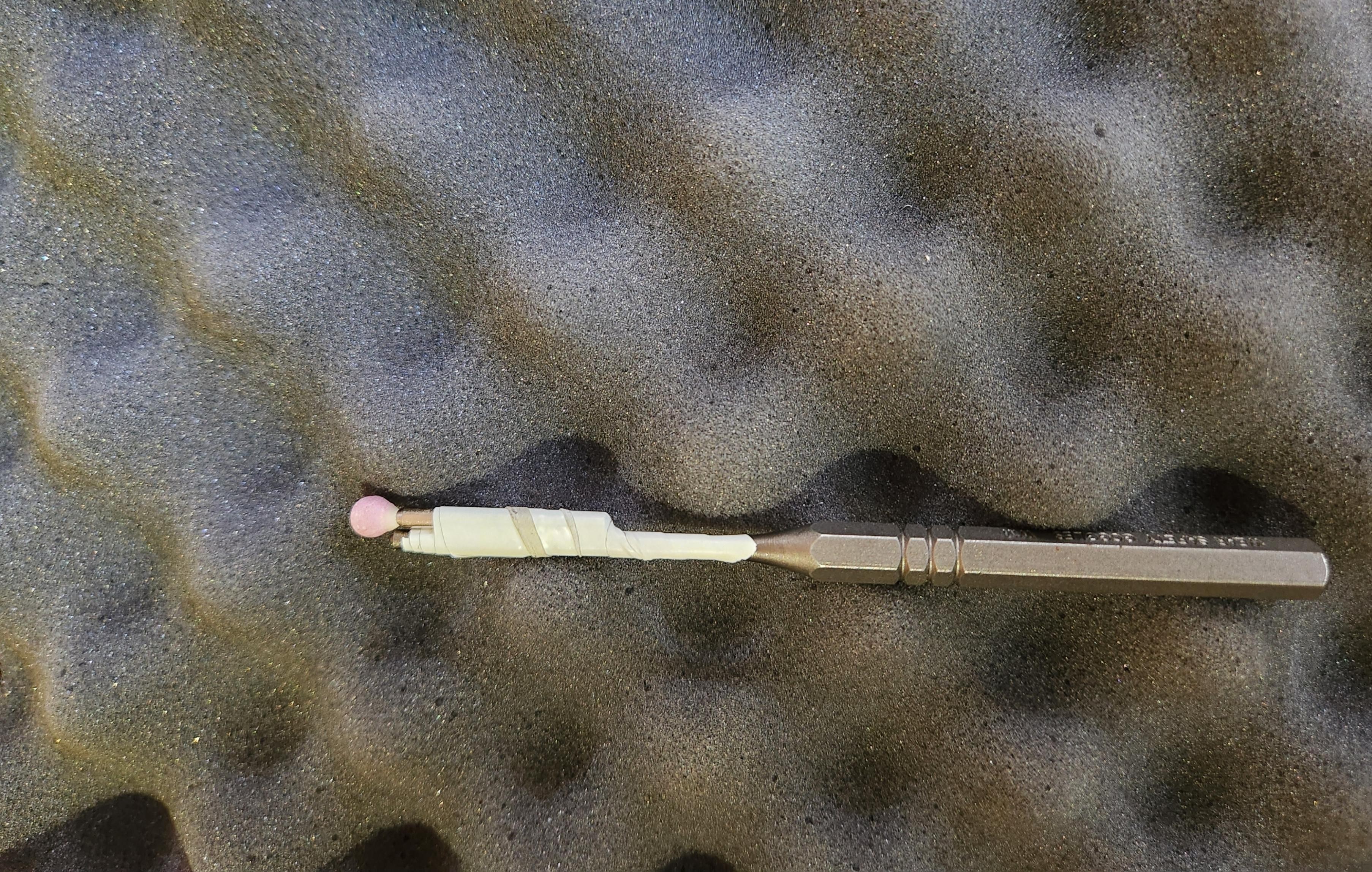

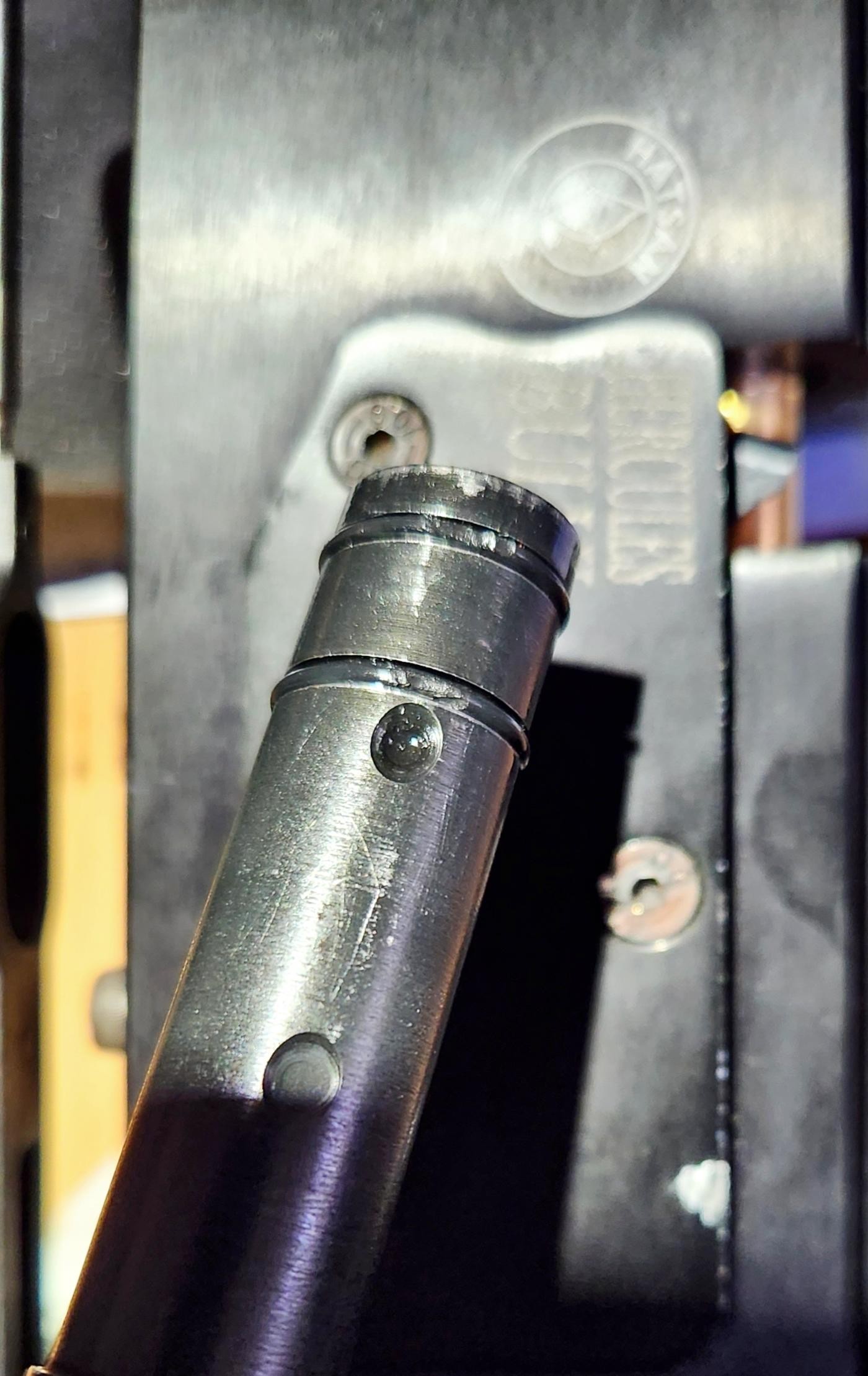

When I took the rusty barrel out, I noticed that on the barrel seal orings, there were a few small sections sheared off. I'm not sure if the orings sheared when Hatsan assembled it or if it happened when I removed the barrel. Those orings have to pass over the barrel lock grub screw holes, barrel port, and a few other holes which all have very sharp edges. Maybe Hatsan uses a cryo process to shrink those orings before inserting the barrel? That's how they get the rubber packed into torsion axles. Anyway, at room temp I destroyed a dozen orings trying to insert the new barrel. No amount of silicone oil or patience made a difference, and the receiver holes with the sharp edges are not very accessible. In the end, I chamfered the receiver bore and taped a dremel abrasive sphere to the end of a punch and used that to deburr/break the edges of the sharp holes.
