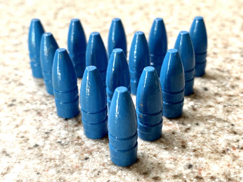

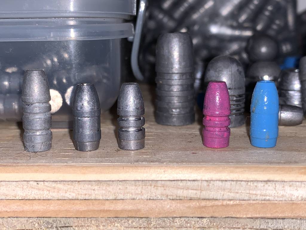

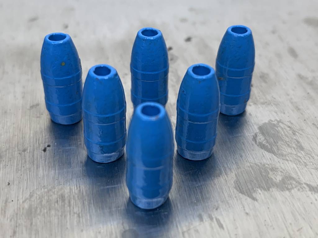

In my humble opinion, my Texan .257 and my Citrus .257 both prefer the 257420 (70-74grains) or the alternative boat tail version at Arsenal. If you can get on one a Noe 258-75-FN (75 grains +-) using the hollow point pin, is a tiny bit better.
At minimum I lube these bullets with 10 weight pure silicone RC shock oil. I now prefer to powder coat my bullets using the tried and true Ford Light Blue. Then they get the silicone oil lube. These rifles with pure lead unlubed bullets will lead your barrel in 50 shots.
257388 mold is good but so far not as accurate as the two previous molds I mention.
Every .257 owner should own a 257420 mold. My Arsenal Molds are fan-flipping-tastic.

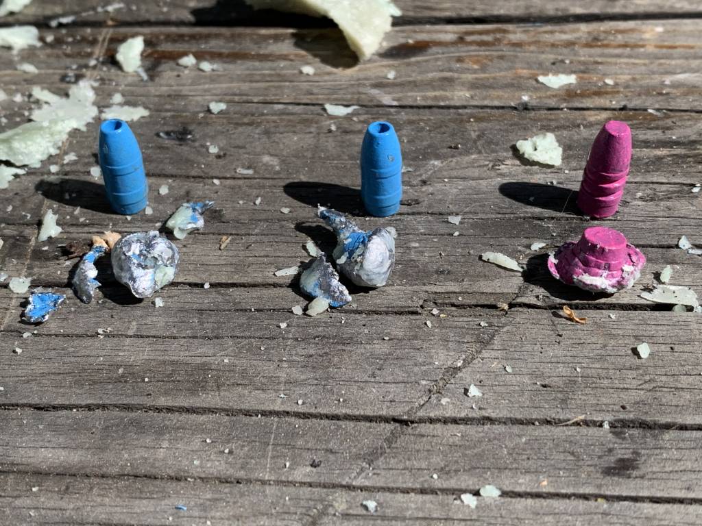

With a 257420 (pink one) in a .257 Texan you will have a lower power setting to get best groups. You will get 150-160 fpe at 3,000 psi. The Citrus with get around same power but pushed to 3600psi. You will want to stay below 1,000 fps. 980 or there about, seems to be the sweet spot. At these velocities, at a 100 yards the bullet goes in one side and out the other of a Turkey. Lights out.
