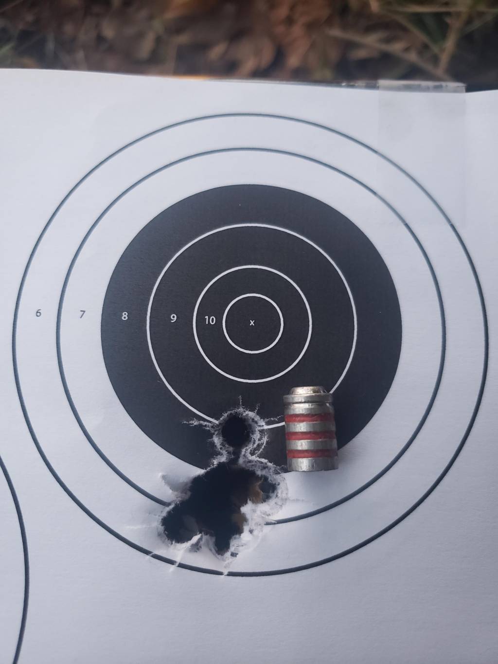

this is a .358 and a 50 yard un tethered 5 shot group.
148 grains at 880 feet per second.
