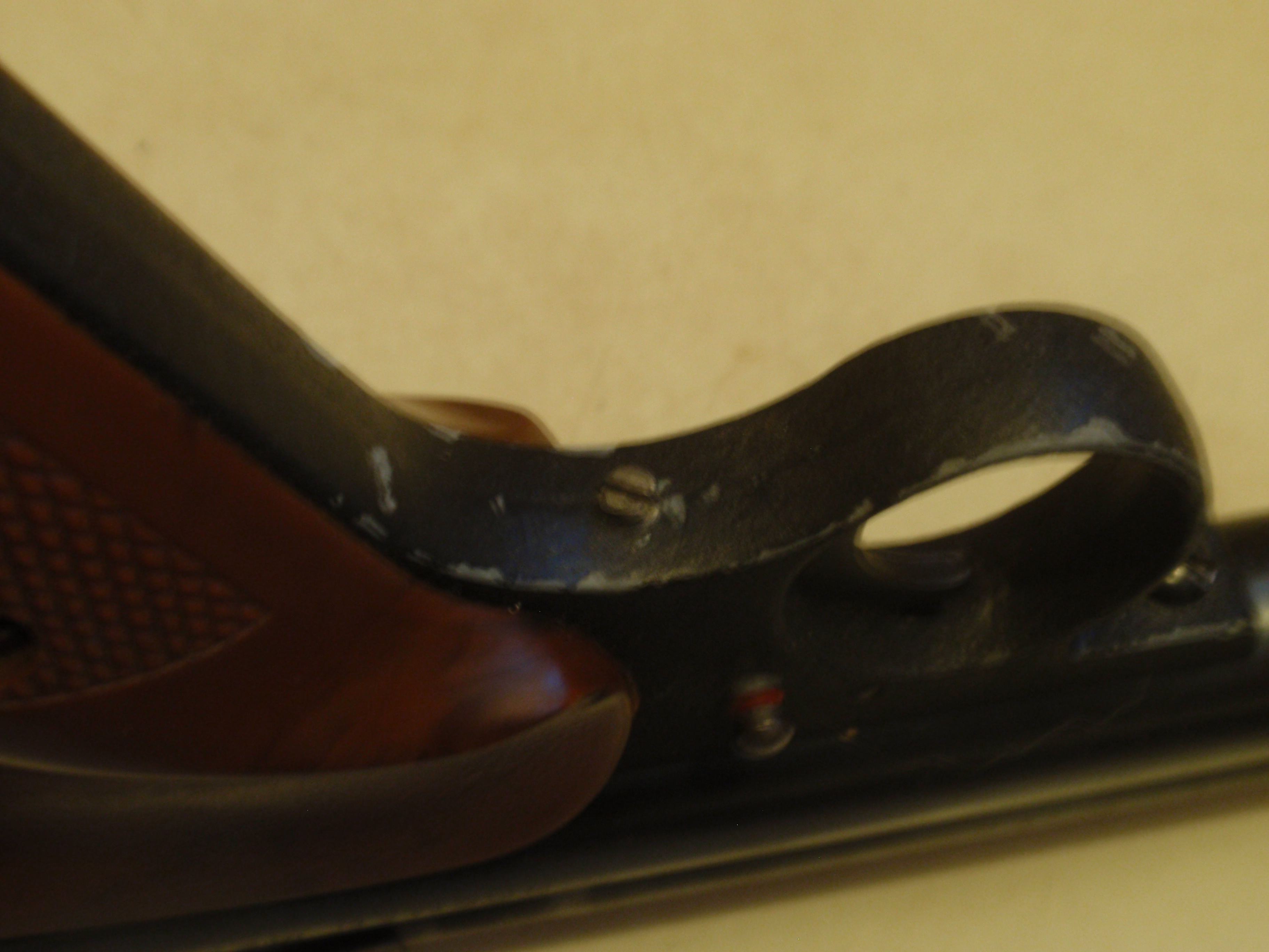

Do this trigger mod. Add a set screw behind the trigger guard . Eliminates most of the creep.
I came up with an over-travel adjusting screw trick for 150/112 grip-frames back in the late 1980s. Now Crosman has adopted it on their excellent PCP pistols. Enlarge the photo in my attachment below to see my approach.
I also invented a trick to install a sear-engagement screw on the 150/112 grip-frame that, combined with a lighter trigger/sear spring and a little moly lube yields crisp, creep-free trigger breaks of less than 2 pounds (and sometimes one pound). When scoped with mounts I sold for decades, a healthy 150 shoots 1/2" groups at 25 yards, with power enough for small-game and pest hunting.
