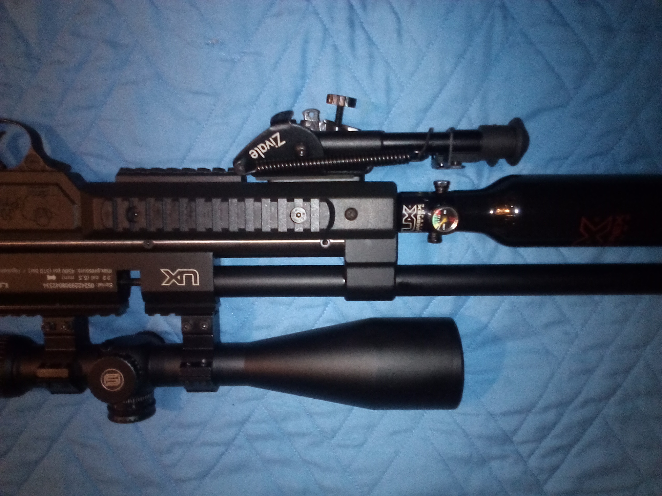

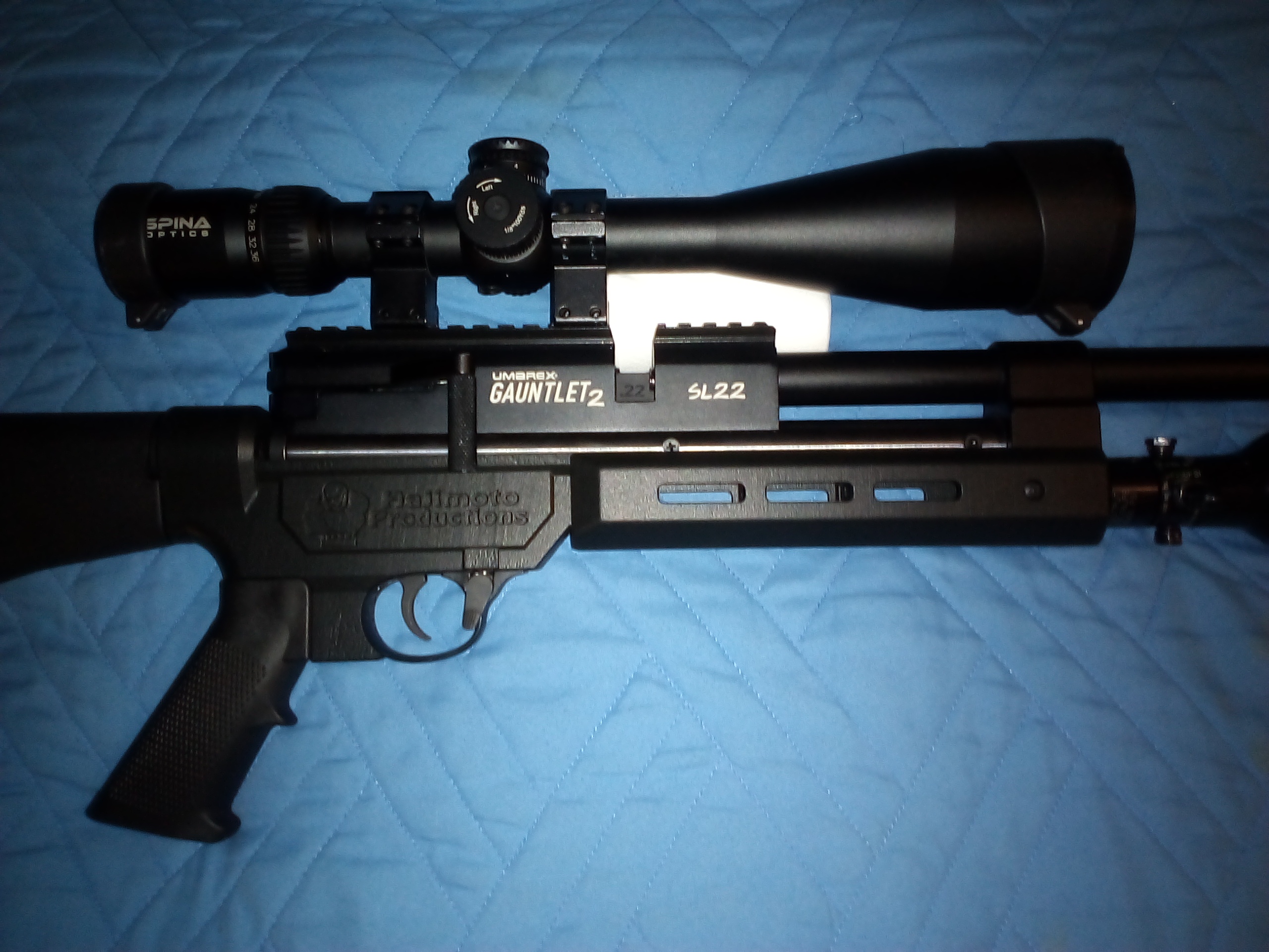

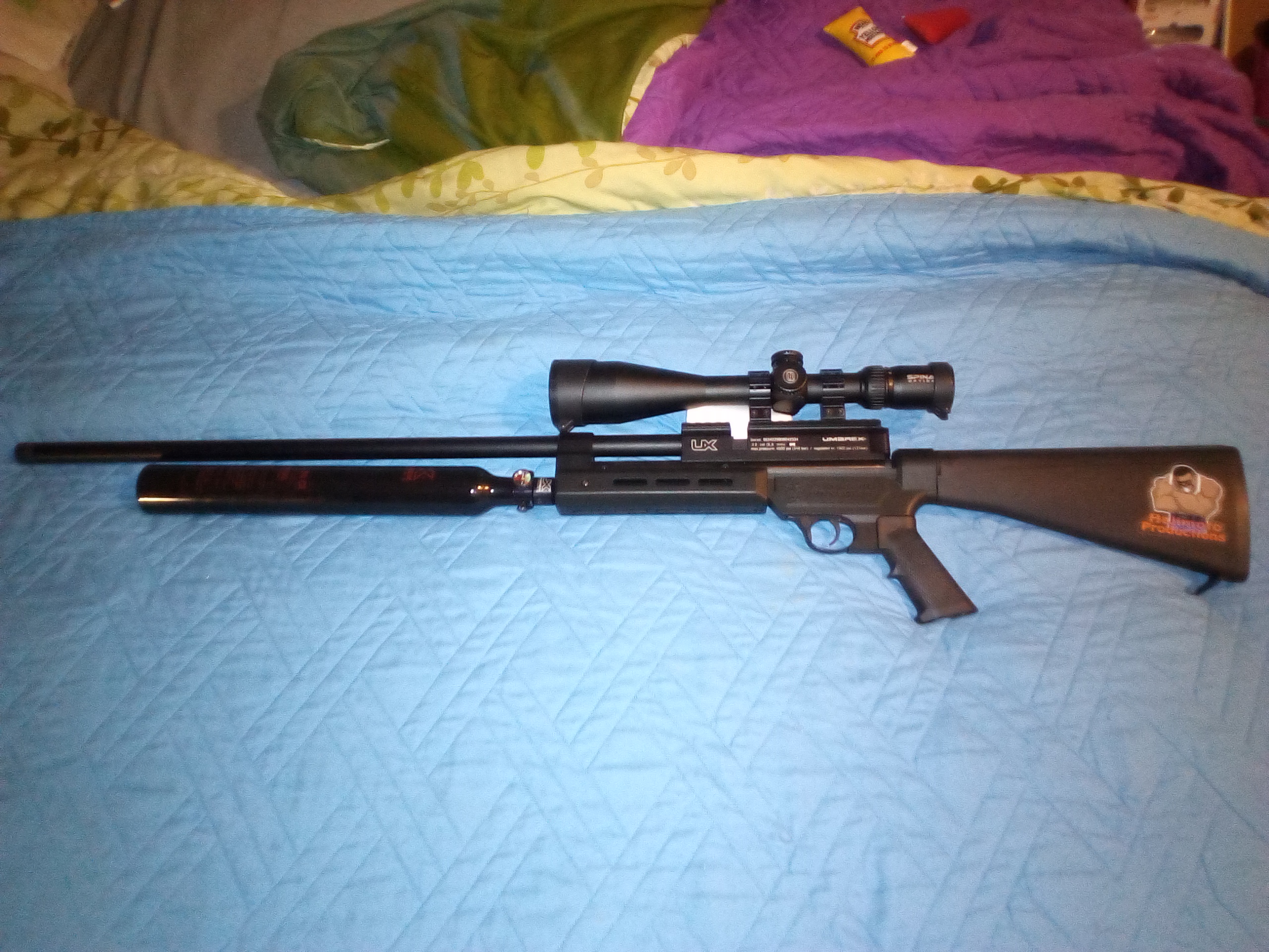

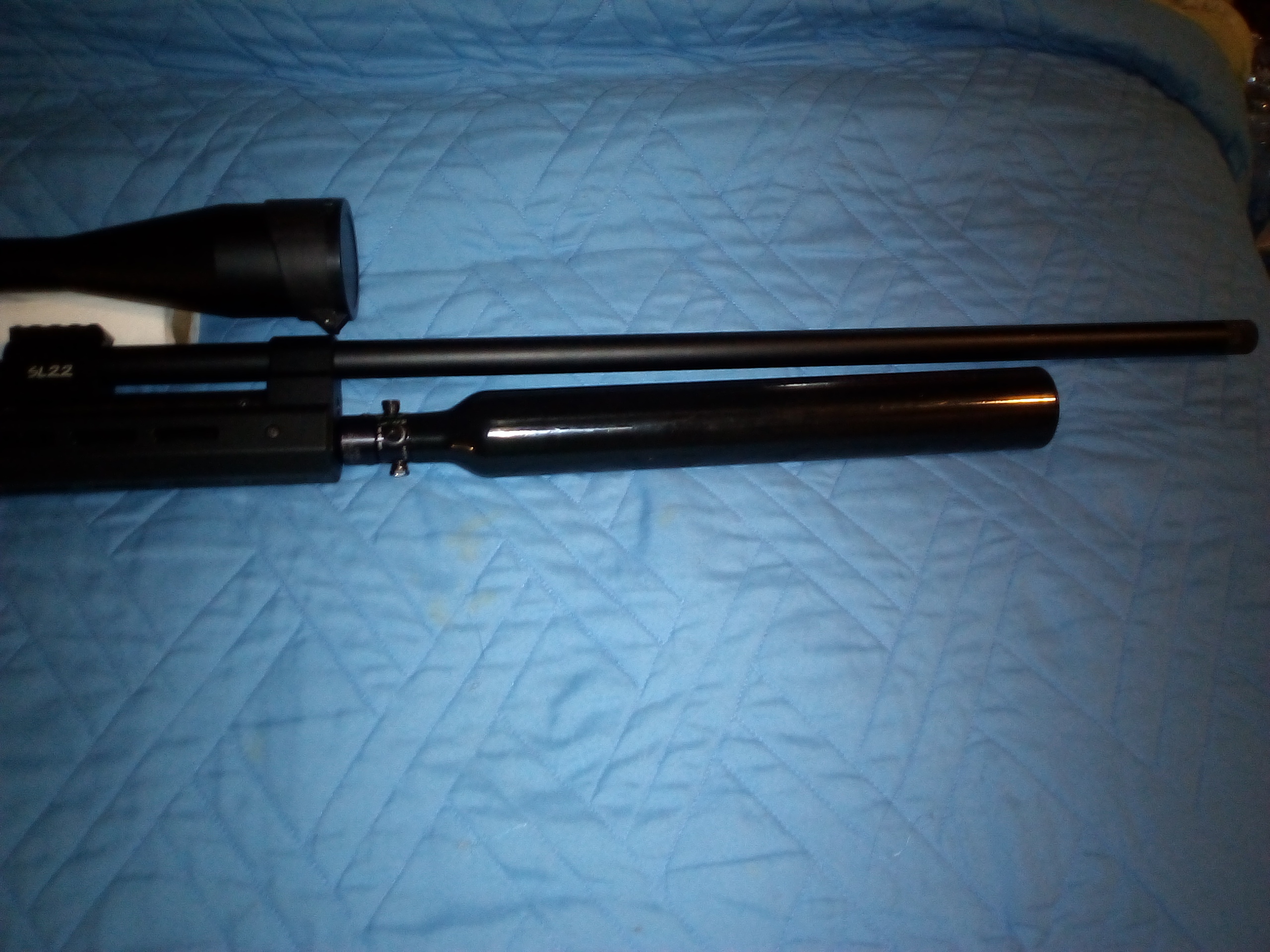

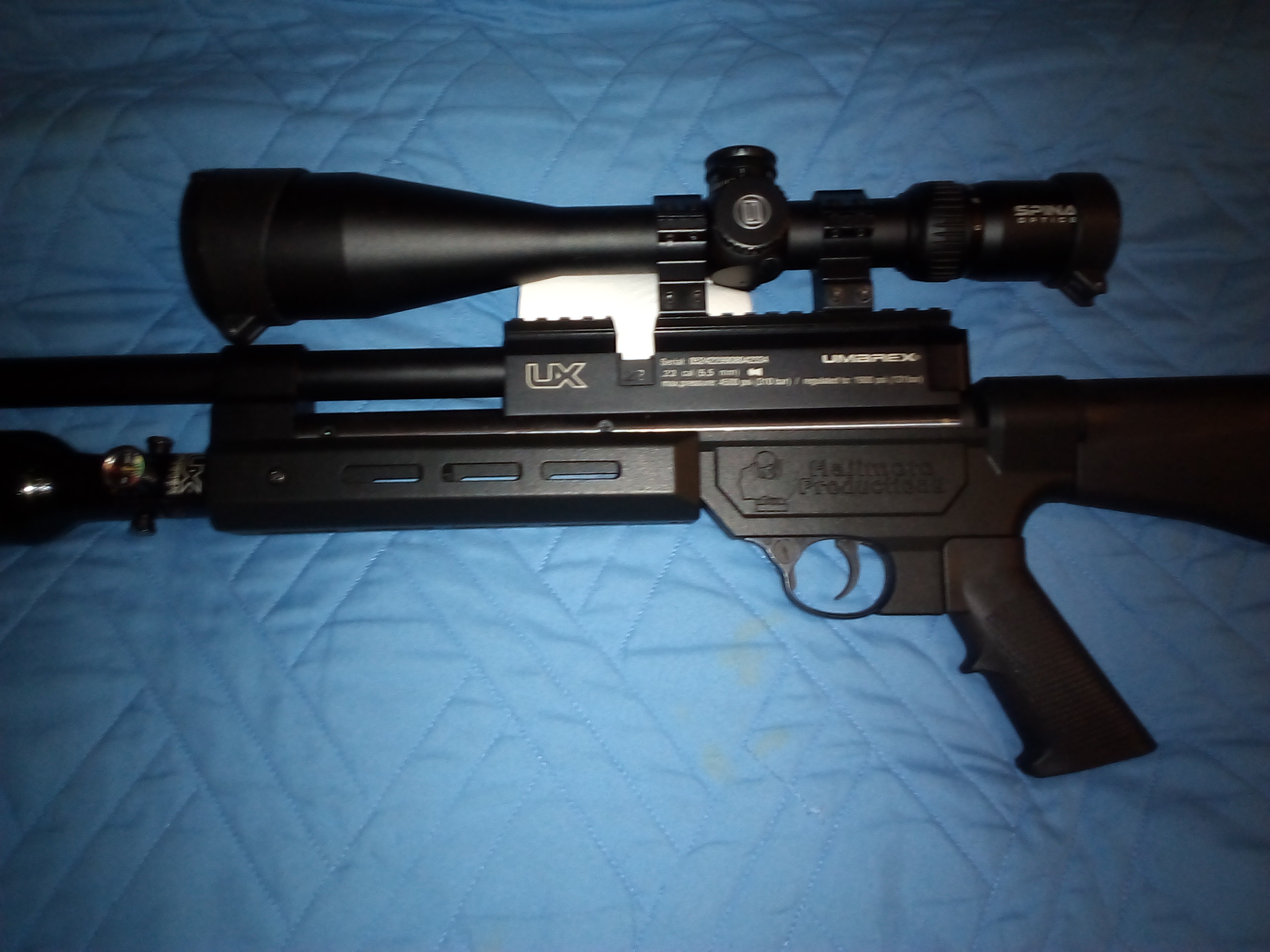

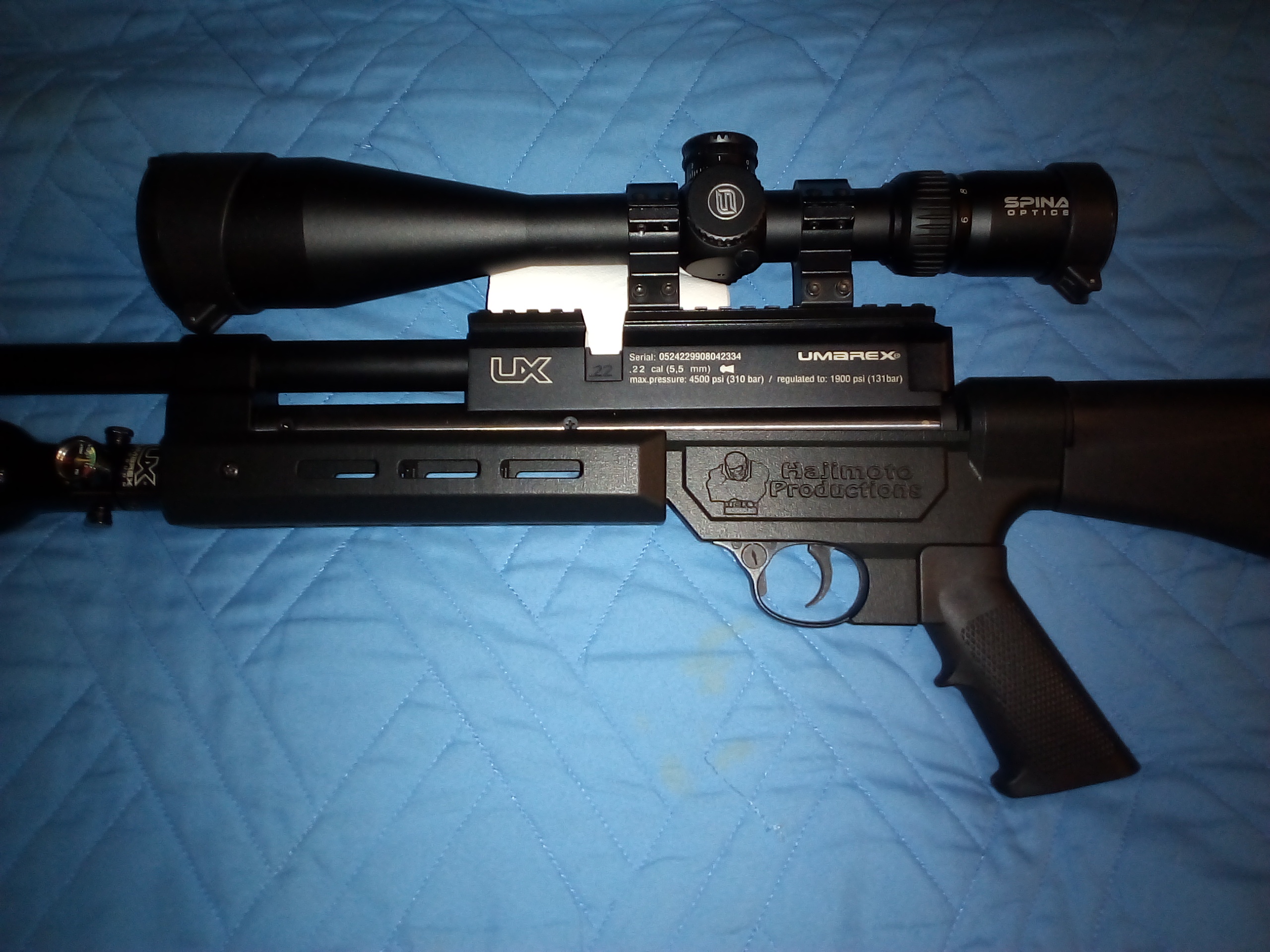

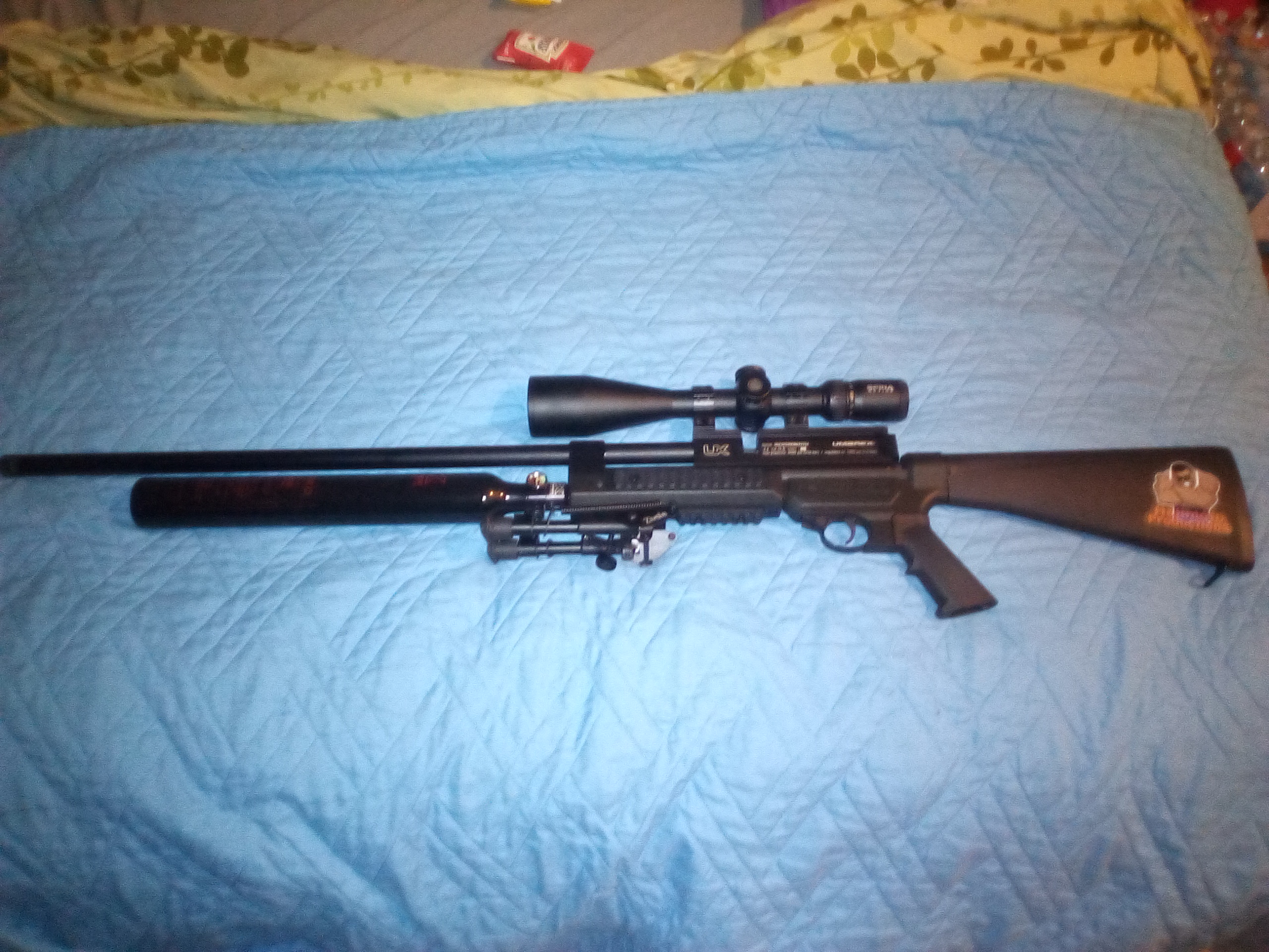

I got the final part I needed to do the build. .22 cal SL Guantlet 2 Tactical.
I like it can't wait to shoot it. OldVet
