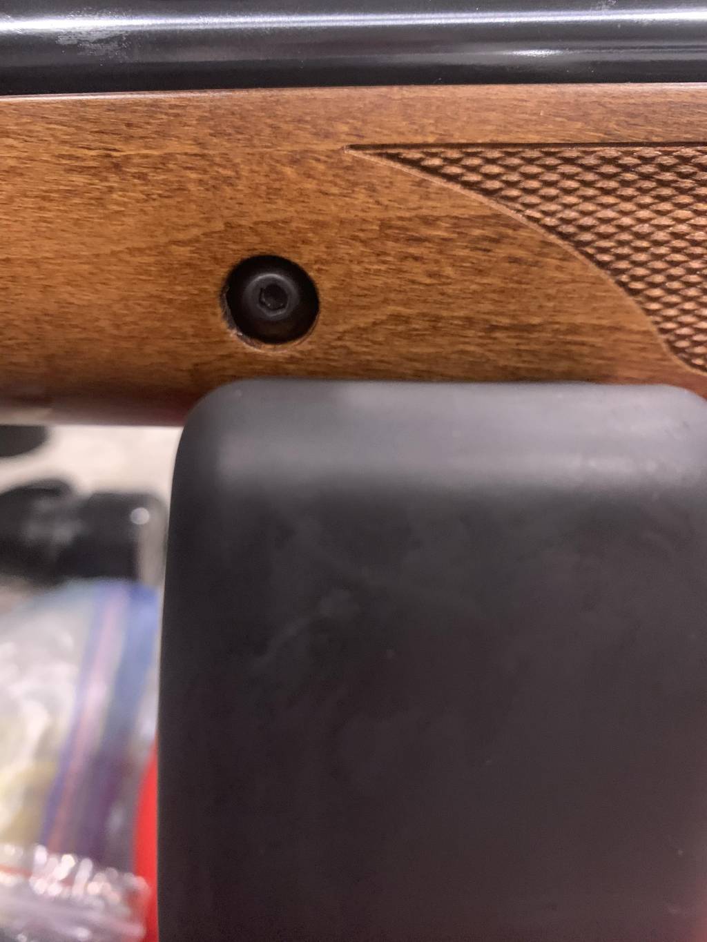

I did it with my HW50S .20 a few days ago while tightening the front stock screw. There are "gashes" instead of clear lines now on that screw.
The gash mark isn't harmfully sharp in any way and actually tells you the position of the screwdriver slot by touch; nevertheless it is a bit unsightly compared to every screw and other piece of my "perfect" rifle. So I took a few days off with it after shooting it twice after the gash or gaff (always on target, always shooting straight) I felt I had ruined it. I thought of buying a brand new screw but then I realized I'd probably bugger it up. Endless unreasonable damage I find myself doing to all things that matter around me.

I used to be known for doing that to screws.I would work on my guns when I was really young and Sometimes I would booger them up. At the time I didn’t have quality screwdrivers so I did have a bunch of them though and filed them to fit various screws on my guns. But what I used to do if I buggered one up was take the screw out and stand it straight up on a hard surface and lightly tap the raised area with a ball peen hammer. Then I would sand it smooth and use cold bluing to darken it back up. I just bought a vintage mark one pistol that had a couple screws that were messed up and now after doing what I just mentioned, you can Hardly tell.
I have buggered up some screws myself. I need a good gun smith screw driver set myself. I bought a Winchester branded set but it’s junk. The screws can be cleaned up or they can be replaced. I found some screws for my hw50 here: https://dlairgun.com/collections/hw50

Simply replace them with nice hex head screws. Buggering eliminated forever. If you put in a cup ....even better.
This^^^. It's what I did on my HW95 .22 and with screw cups from Mac1. Sadly, he hasn't offered them in over a year and the ones at AoA aren't quite the same. I still have a set of the Mac1 screw cups with hex head screws that need to be put in my Beeman R9 .20.

I bought the Arizona Airgun cup and screw kit which comes with Allen socket head cap screws. But the cups are a bit tall, so you need to turn them down on a lathe, or drill the stock holes a little deeper. I don't have a lathe, and I didn't want to drill the stock, so I finally replaced them with new stainless steel Phillips screws (metric m5 - 0.8). I got them at our local Home Depot. I have repeatedly tightened them, using a sharp Phillips driver, and there is still no burr. This is probably because the heads are better made, and the steel is harder. The heads are larger than original and fit the stock holes better. Yeah, I know, Phillips screw heads tend to look cheap. But these look really nice.
I did the same thing to one of my guns and it really bummed me out. Reading this form the other day instigated me to go get some screws this morning and I put them on my brand new R9, I can thank you guys for that one too. I picked up the screws that go in the stock for $.85 each. In the HW’s it’s an M5 x 16. So far as this size has fit into every stock that I tried. Night and day difference.
