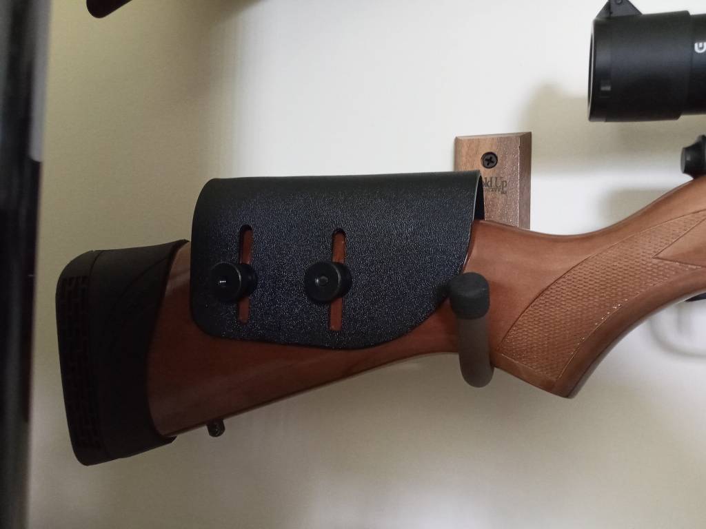

3) How is eye alignment on the Avenger? The comb looks kind of low; are people using cheek risers?

id say mount it where it works out best with eye relief and your hold .. dont know the setup for an avenger but medium rings are usually best to clear mags .. i wouldnt worry about qd, either way i dont overtighten scopes .. as far as comb, ive used the kydex ones on wood before, alittle heat from a heat gun to match it to the stock and theyre pretty jam up, drilling the stock is nerve racking but its prolly worth it if it needs one ..
