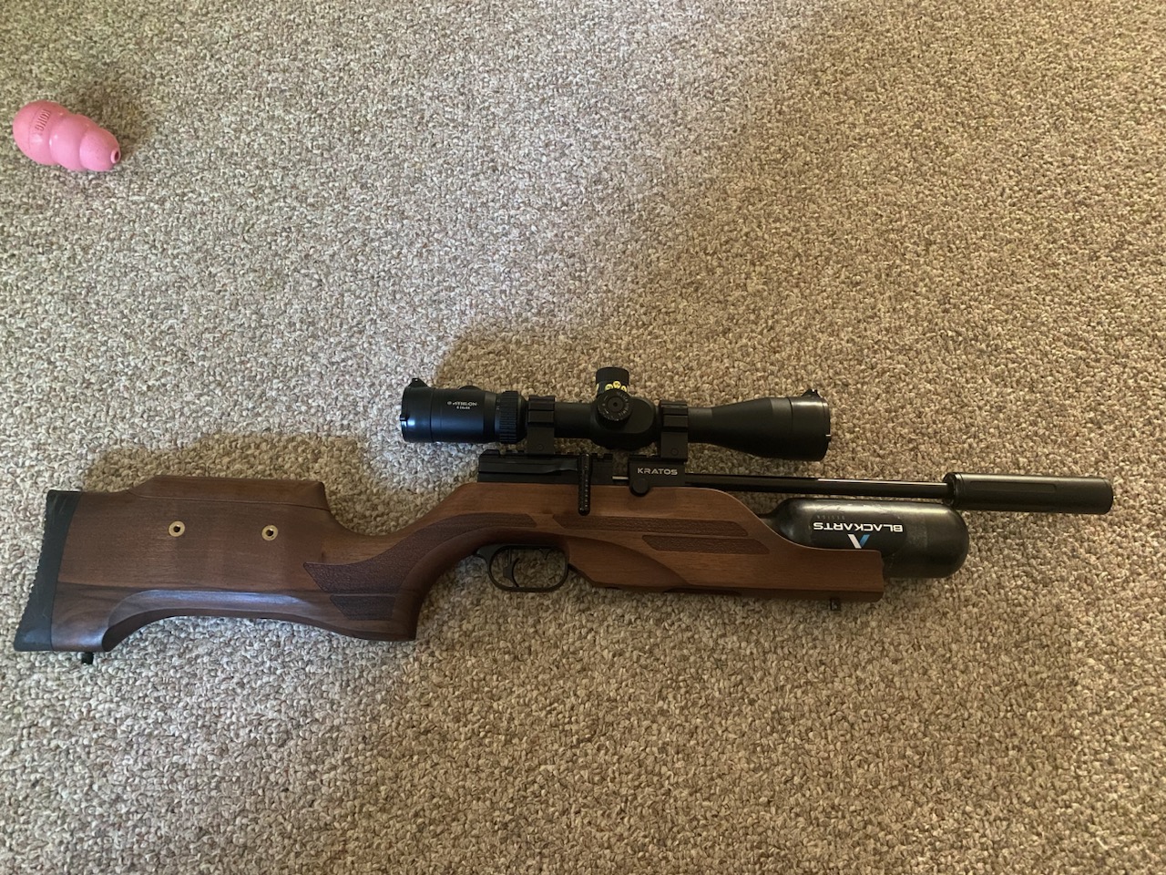

With your budget i have seen a few .22 kratos go by for 350, ebay also. Get the barrel cut and threaded., carbon bottle and bottle reg. Get plenty of shots at lower power and up to 40 fpe or so. Can be done Under 800. This is a friends kratos.
