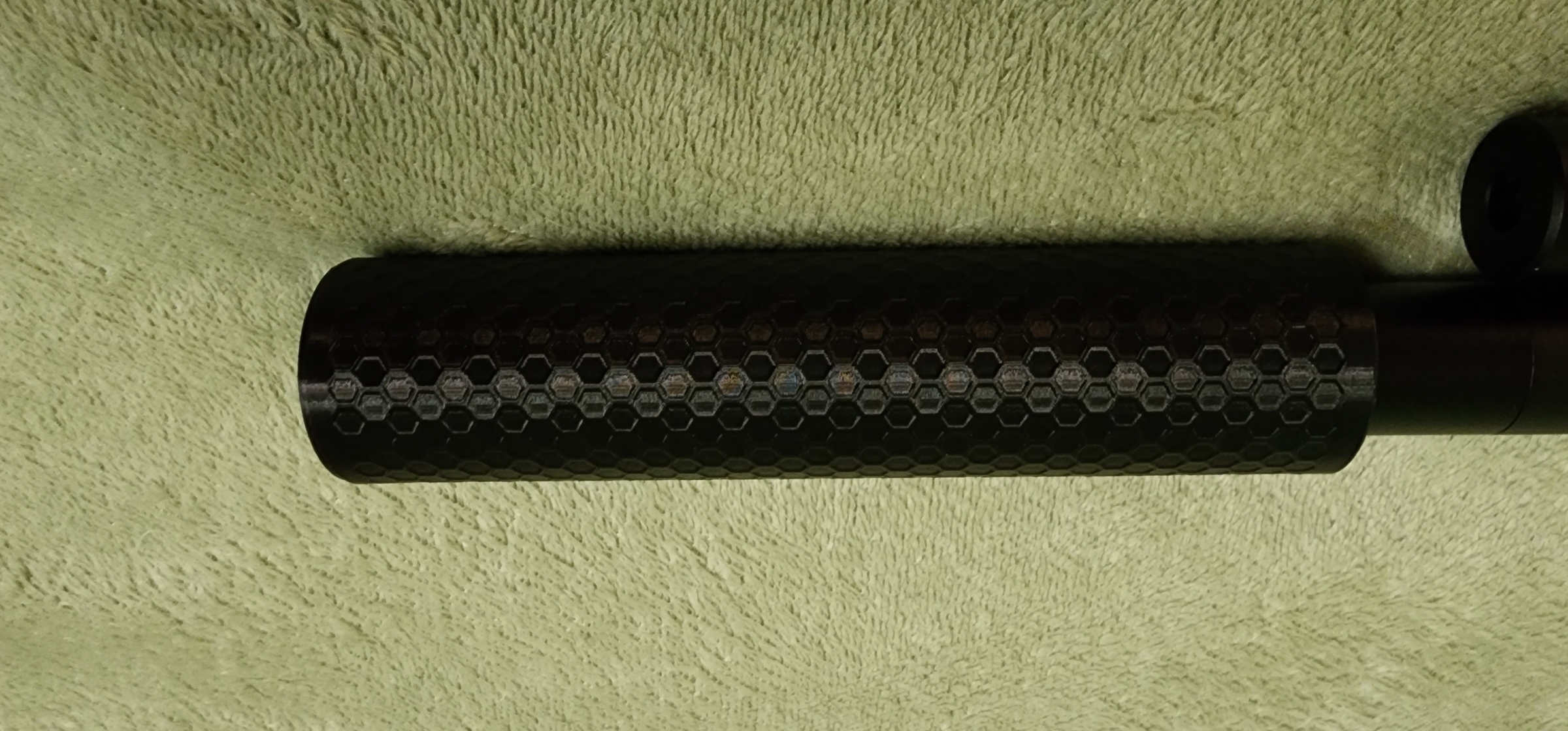

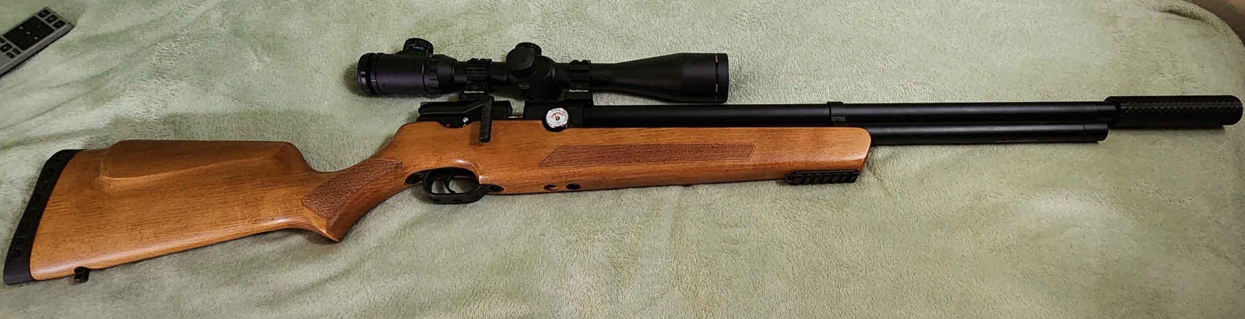

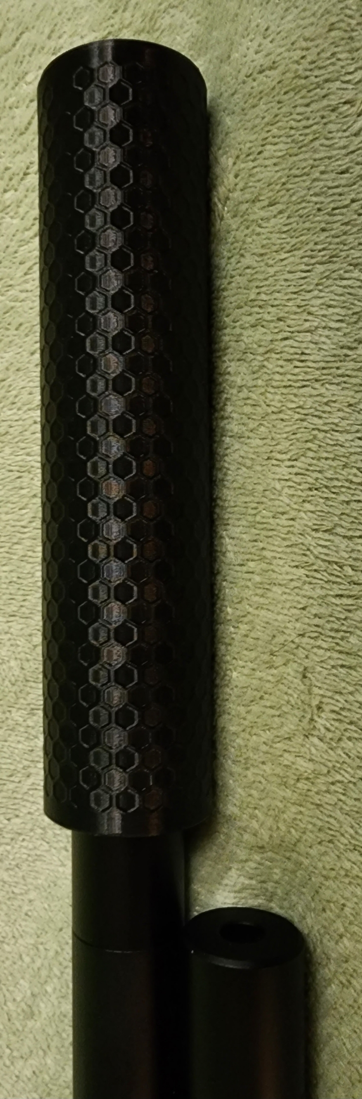

By the website these are later generation units. I bought the newest release.. It is a 30 cal model..
You can see in the pics.. The 30 cal is a can style not a tapered one..
I am shooting 25 cal but they advised to get the 30 for the 25 cal guns to avoid needing to touch up the inside diameter in some cases.. To avoid clipping..
I tried this on 3 of my 25 cal guns
1) Hatsan AT-44 (non QE)
***the most effective.. Honestly I had no idea how much mechanical noise this gun has until the BARK was mostly removed..
2) Hatsan Galation
*** helps quite a bit.. The new sound now is a combination between a snap and mechanical sound.. A bit noisier then the AT 44.
3) Avenger wood stock..
*** this is the strange one.. This gun is shroaded but has a bit more sound then the Galation and more yet then the AT 44???
This one has a healthy snap with the bit of barrel bark.. It also has a Donny FL inset adaptor..
Would I buy again.. Yes I would keeping in mind they are 40 bucks..
