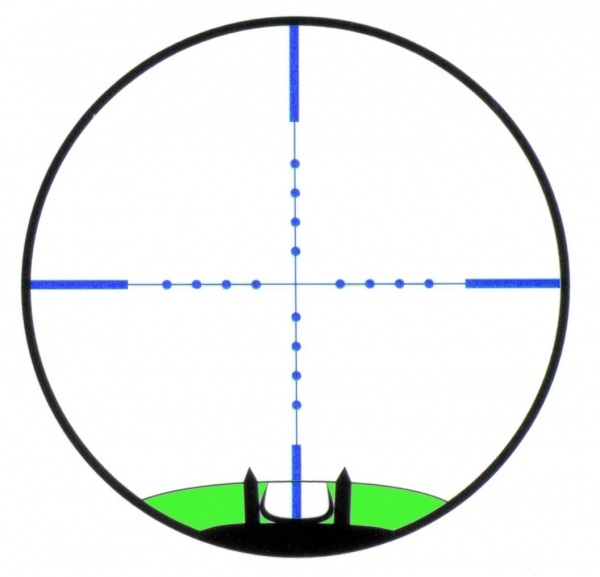

The other issue is simply the field of view. Although the amount of viewing area taken by the level (always mounted at the bottom of the scope) is small, the level's movement can be disconcerting when you're scanning the country side. You sort of get used to it, fortunately, but it has taught me to rely more on the binoculars which is a good thing.

UTG and Hammers have scopes with the level incorporated in the scope. Meaning that you can look through the scope and see the leveler.
