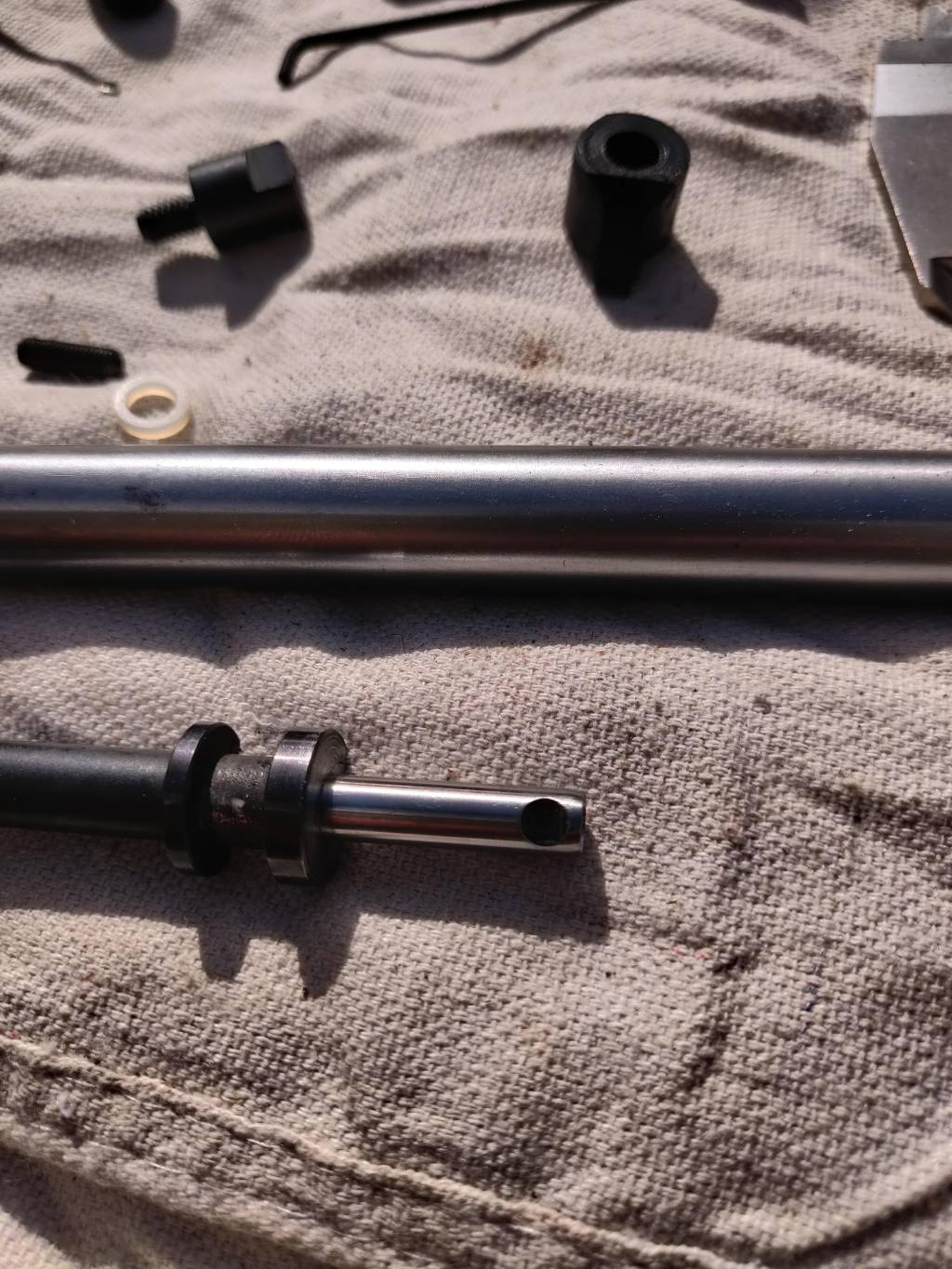

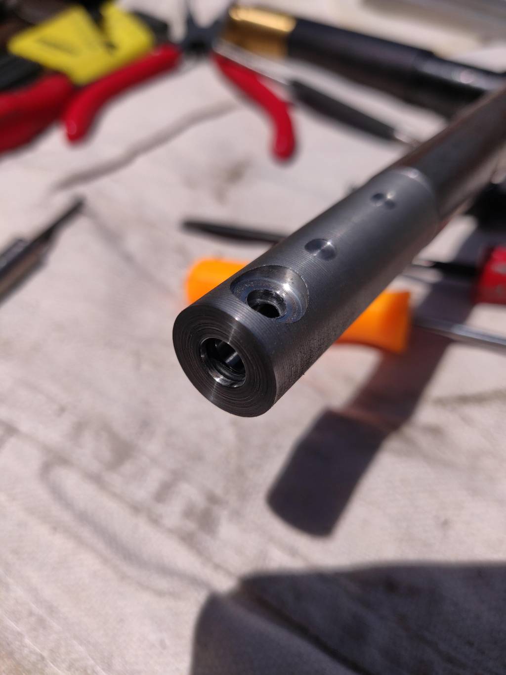

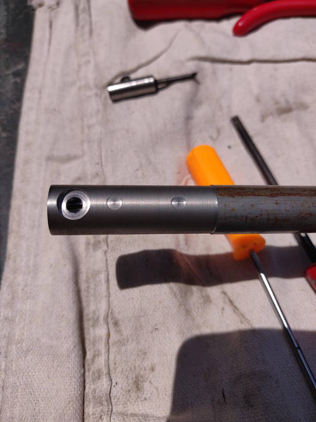

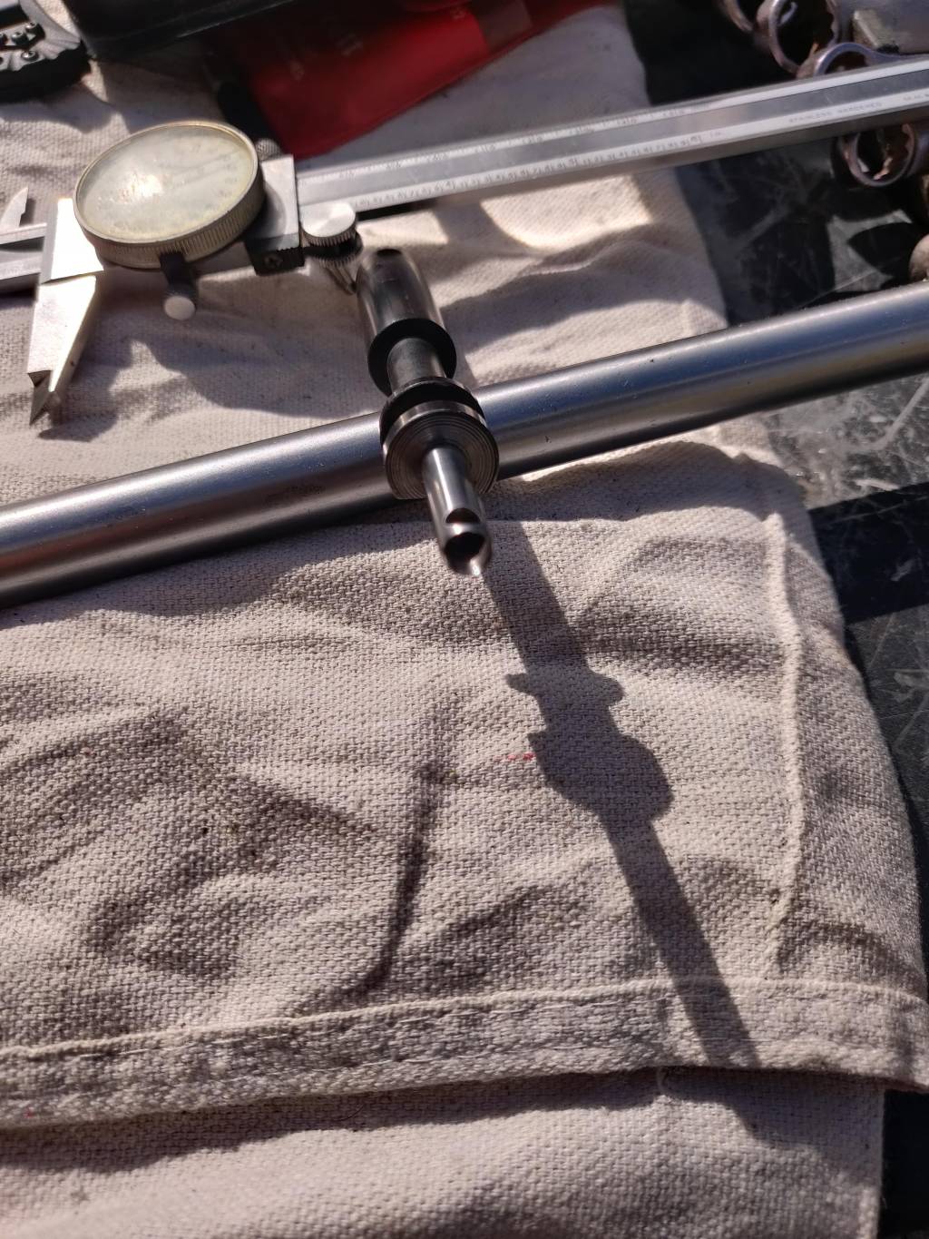

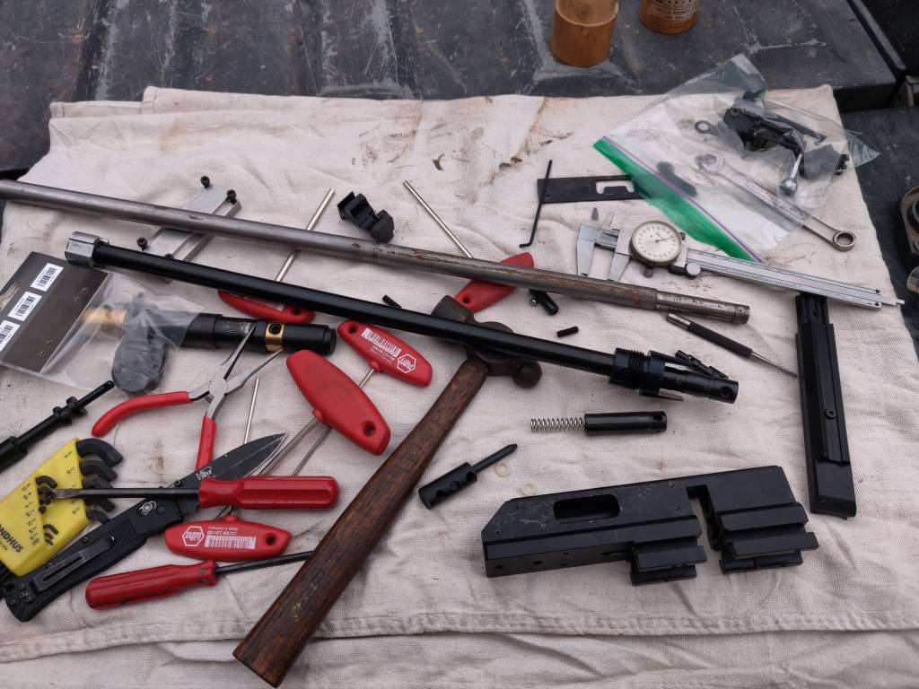

Okay, it's been a productive day. Tore the rifle down, found a used Lothar Walther blank and made a new barrel. Only trick pony was grinding an internal grooving tool for the barrel O-ring. Not a big deal, but it was the only tooling item I had to make for this. The bolt was hardened, which surprised me, but a carbide mill in the tailstock of my lathe finally bored that out. I made a new end for the bolt out of drill rod and secured it with sleeve retainer.
Got it all pieced back together and put the factory cigar and bottle back on it to test it out. Eight rounds loaded, eight rounds fired. I need to do some smoothing of the guts to get it to cycle a bit smoother, but it worked fine. As it's currently set up, it's got quite a bit of power, I'm still using the donor barrel at full length and the cigar is set up for FAC levels. Once I'm ready to do something, I'll cut the barrel back to 250mm and set the new regulator at a more docile level.
