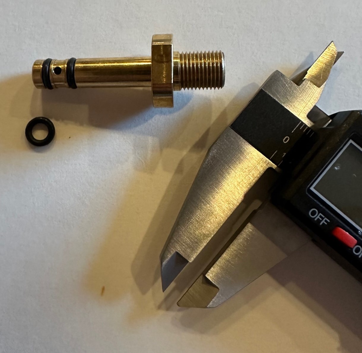

Anyone know the size of the probe o-ring on the 22 model?
Need to get some, mine got stuck in the mag and shredded it.
Not too sure, I tried a 22 crosman o-ring and it was too big.I'll bet it's a
O-ring 5,5 x 1,5 NBR 70
Standard size for .22 air guns. Global O-ring, where ever you get them from get 1% tolerance, anything else may leak with the tolerance stack.
No. I misread the OP. This is for the Filler probe.Is this for pellet probe or the fill probe? Im looking for pellet probe oring?
3mmx6mmx1.5mm CS Buna 70 o-ringsIs this for pellet probe or the fill probe? Im looking for pellet probe oring?
