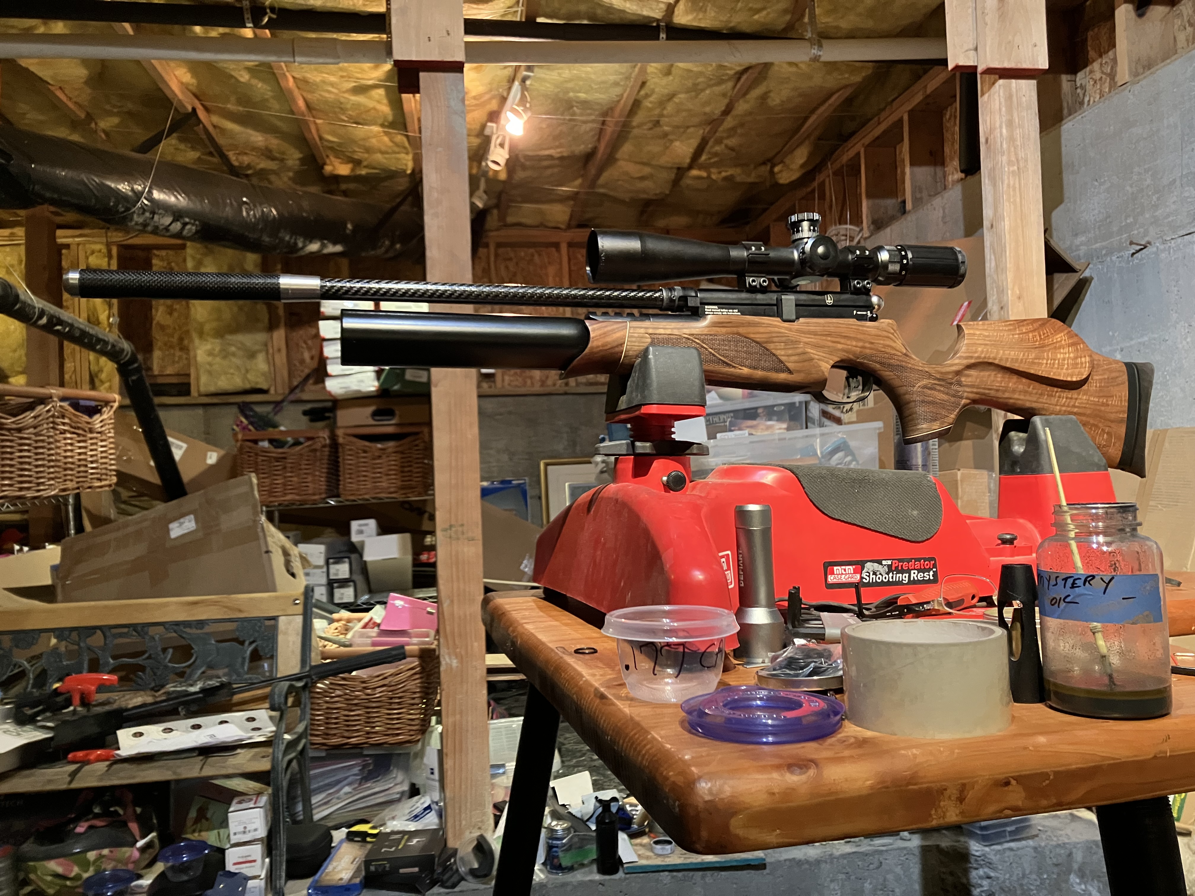

agree totally ! gorgeous stock by the way. what moderator are you rocking on that thing?

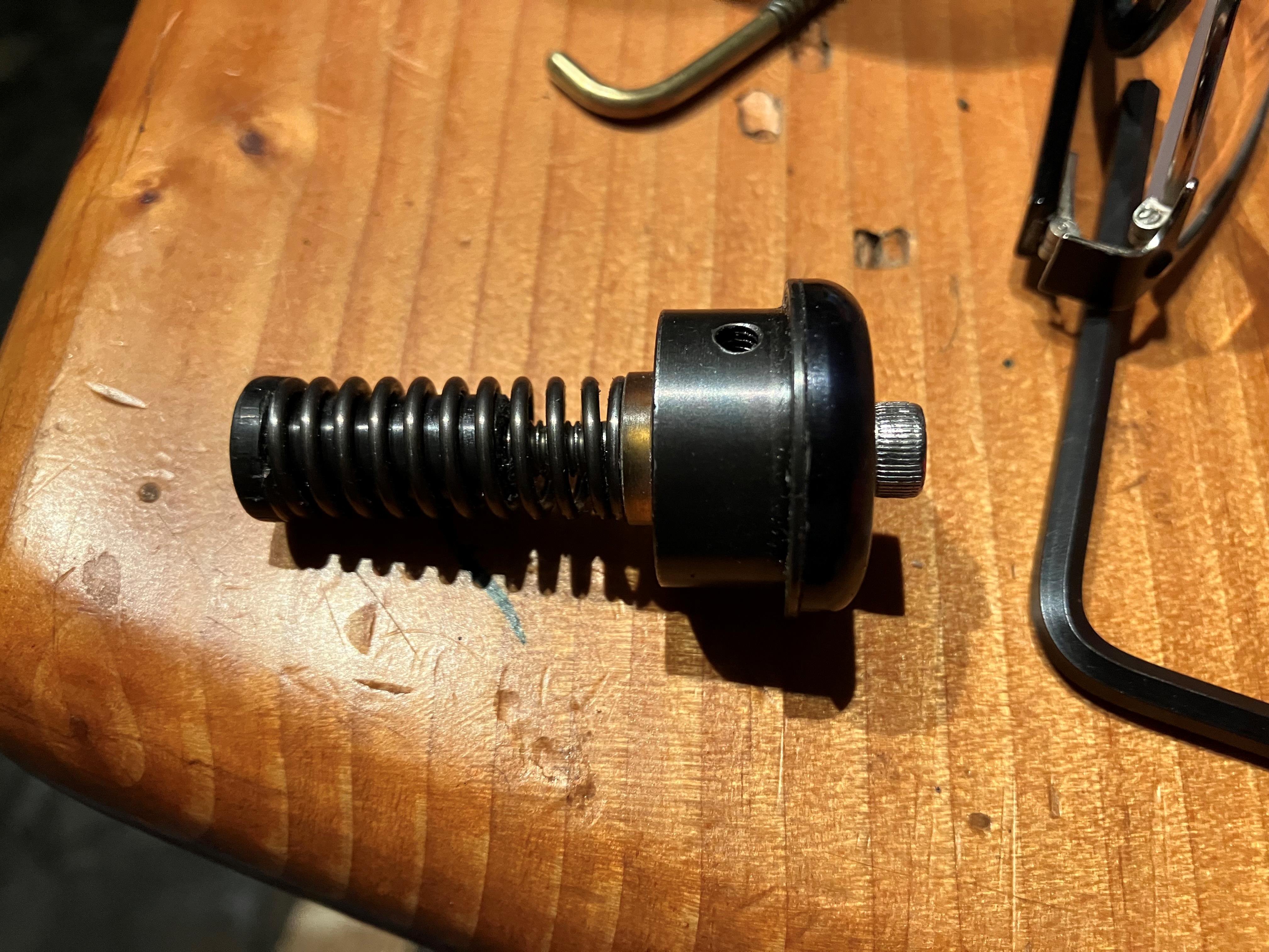

One knock would be shot count. You can make an anti bounce device pretty easily or it reallly bothers you, eBay Uk sellers sell different parts to increase efficiency but you need to partially take it apart. XTX’s videos are a great ref if you ever need to.

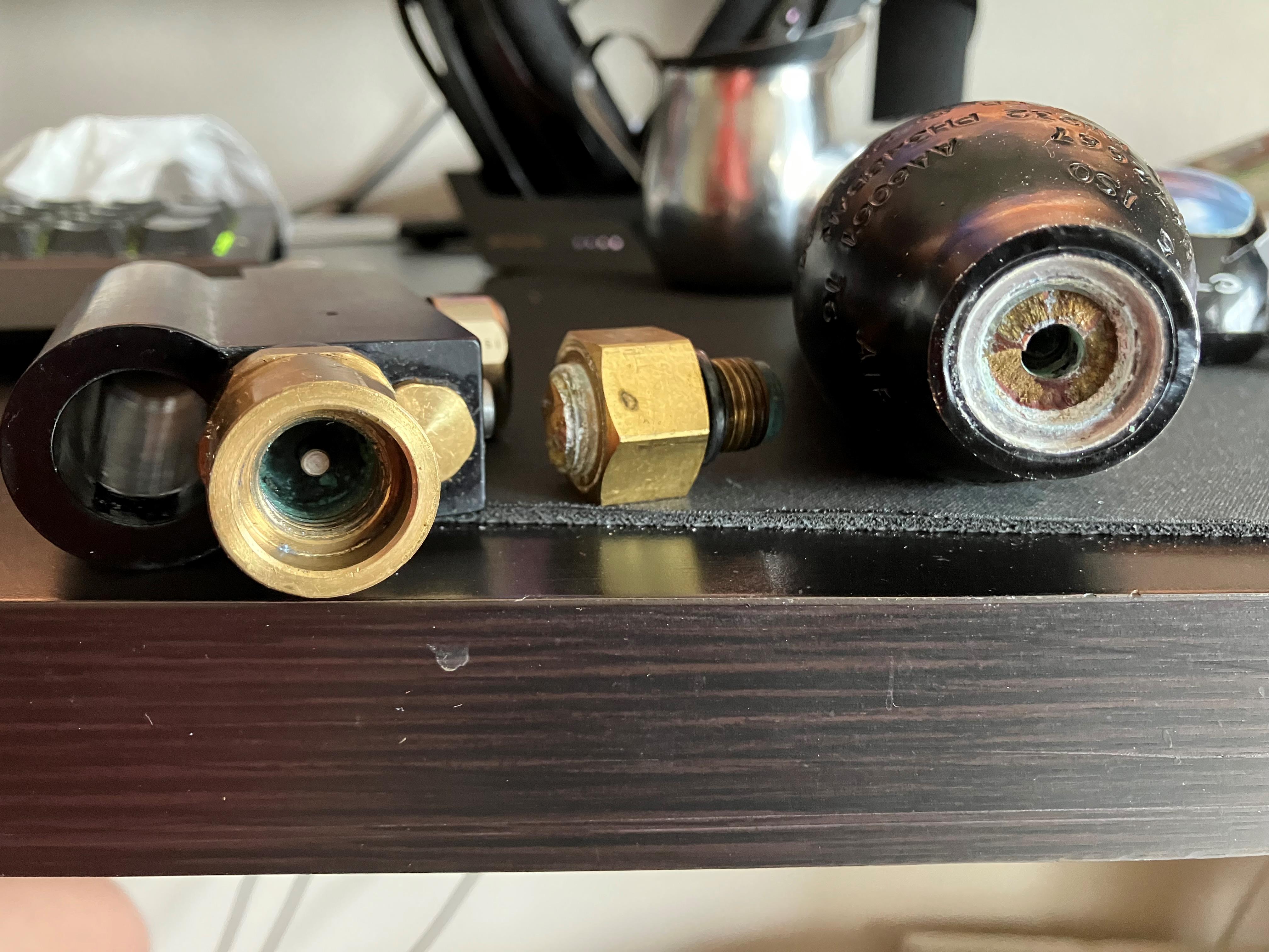

I got 70 shots per fill at 900 fps using JSB 10.35 grain pellet with a 200cc bottle.
The bottle mysteriously broke off the gun due to excessive moisture, corroding the brass coupler. This was caused using my Benjamin pump.
I then purchased a 280cc bottle and SS coupler since I now have a compressor - no moisture issues.
Hey Cave,
Made the moderator on my lathe - it looks kinda long in the pic doesn't it?
I made it extra long because I didn't have a longer piece of CFT for the barrel. The actual moderating section is about 5" long and slipped on the barrel about 4" - anchored with a set-screw.

Here is the Spring Stop Guide (SSG) I made on my lathe.
I haven't tested it for shot count, but likely the 200cc bottle would have gotten 75/90 shots per fill and my 280cc bottle will get 100+ shots per fill.
I get tired of wasting good pellets to see how many shots I can get before dropping off the regulator.
When I tested the Huma regulator vs. the old BSA regulator (using Blast Tamer) I was getting 70 shots per fill on a 200cc bottle.
