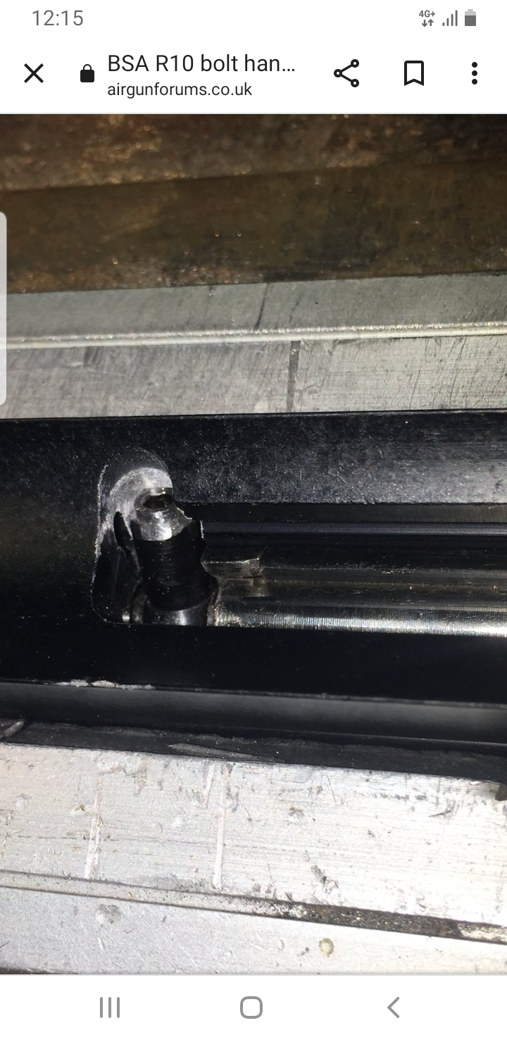

I bought a second hand bsa r10 super carbine 177.
For some reason the loading bolt keeps unseating itself when firing the gun but not all the time.
I've searched the ne t and some say the probe is to long and some say the bolt needs turning another 10 degrees.
Does anybody body have a definitive answer for what the gun does this.
Any help greatly appreciated

From what I can gather the cut out in the probe housing is bigger than the locking pin on the probe and apparantly this is the cause.as it's a pig in a poke.
I shall strip it down and have a good look what's happening.
Blowing air through the hollow probe like some crosman probes is maybe also adding to the problem or may well be the cause.
I got the gun cheap so all is not lost and hopefully I can sort it out

I'm sure theres 3 things maybe going on 1 the probe locking pin is undersized.
2 the locking pin needs few more degrees of turn in the housing?.
3 the air coming from transfer port is sandwiched between the pellet and the wall of the probe and forces the probe back on itself
They have modified the probe and swapped indent ball bearing for delrin type
I may also swap probe bearing for fac type as one is steel and one is delrin if its worn.

Some fellas over here replace the 12ftlbs probe bearing with the fac type and remove more metal from the probe pin cutout so it travels further and shorten the pin and cone the end of it " the use a dremel ball bit to redo indent on the probe.
I shall try new probe on it's own first if problem still there replace probe bearing before removing any metal whatsoever.
With barrel housing off the gun look at the indent hole and see if it lines up when cocking handle fully rotated to closed position?
