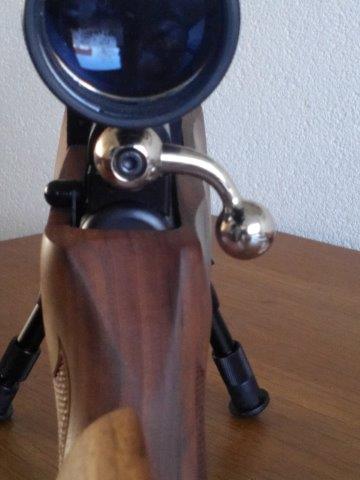

Hey I recently had the same problem,
Part of the bolt is curently pressing against the stock, this causes the chamber to be only partually closed.
To fixt this you need too looses the screw on the bolt and move it a bit upwards.
This should fixt the problem.
The video shows how the bolt moves backwards when you fire.
So when the bolt is closed it shoudn't touch the stock, this way you ensure it's completely closed.

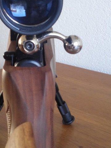

These are the up and down positions of the bolt of my gun, as you can see there is a clear gap present in the down position. This ensures that the bolt can make the whole movement to lock the chamber and doesn't come back up when you shoot. The screw in the middle you can easily adjust. It took me just 30 seconds to fix the problem.
