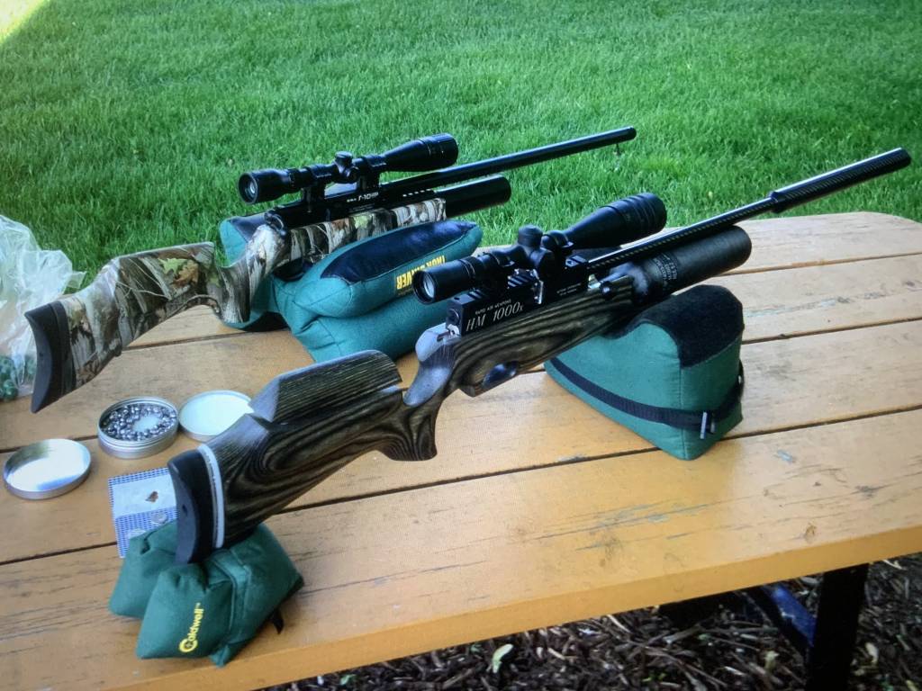

poor neglected bsa the only 1 i own anymore. i filled it and didn’t notice a leak, shooting recently received jsb hades 1 shot on top of another @ 35 yards, leak got worse and i hear it. I took apart the fill port check valve and did find potential problem causing debris. After reassembly i try to fill and now air blows out of the reg “bleed to atmosphere” holes. i didnt touch the reg. I have a huma-air reg on order. anybody have advice? much appreciated as always. the camo stock seems so cool to me. its ambi which is better than righty only but not as good as lefty only. after seeing 2 mags of hades stacking this ag is my new project. by coincidence i have hades 30 cal i need to try with the RAW, that pic was taken long before hades existed
