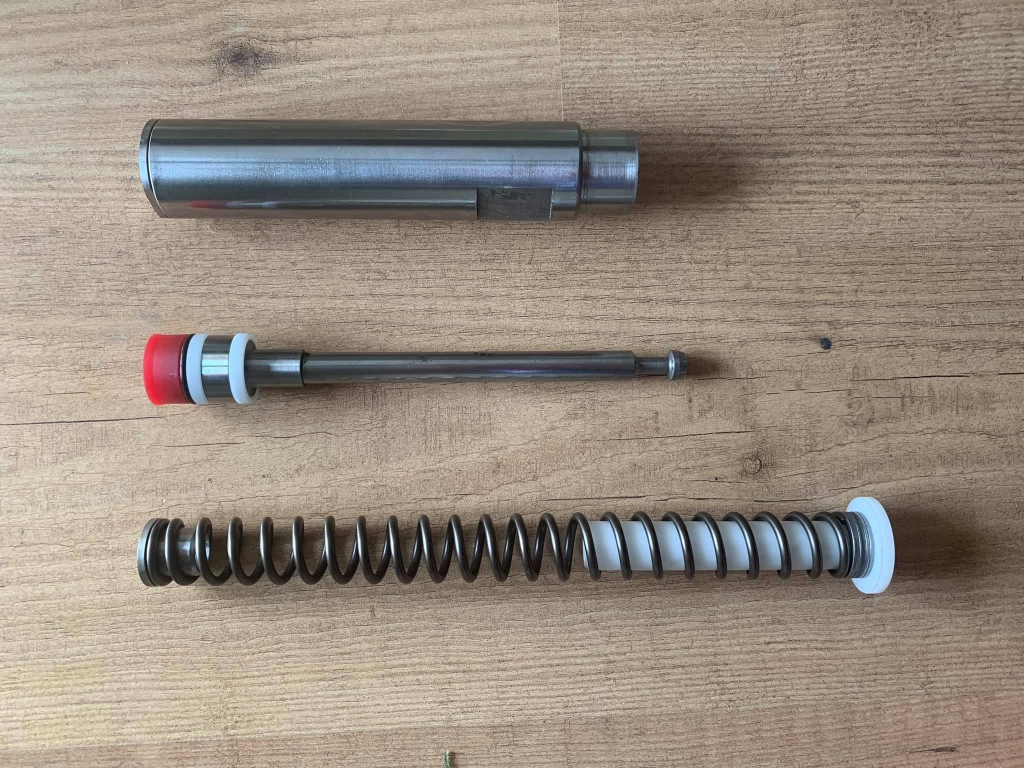

Was wondering if anyone can make two Bronze bushing for my Tony Leach Skirtless piston (to replace the Delrin ones).

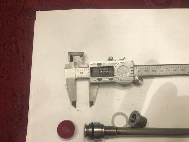

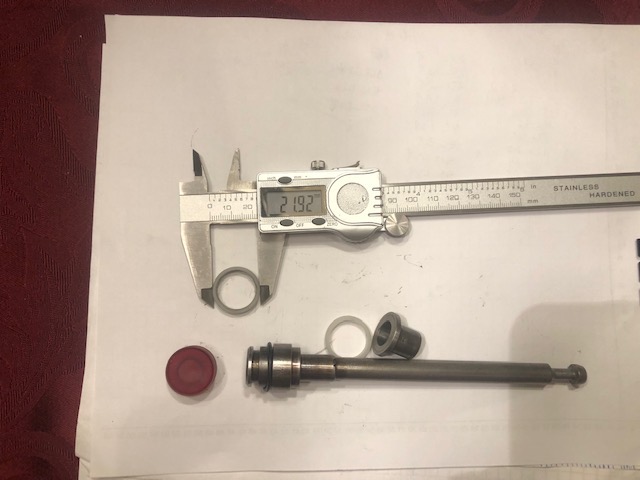

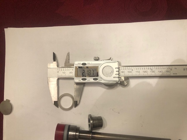

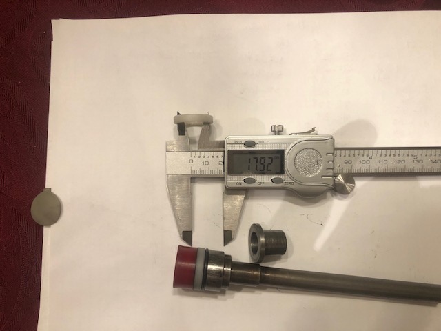

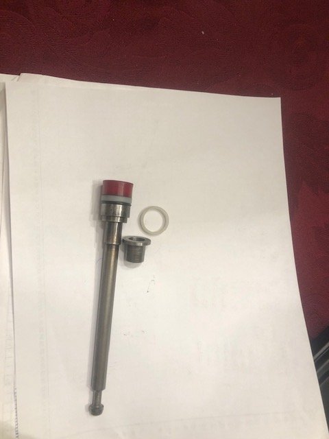

Hi Bob
the Delrin next to the top hat. OD=21.87mm, ID=17.92mm, length= 4mm
the Delrin next to the red piston seal. OD=21.92mm, ID=17.98mm, length =4mm
having trouble uploading pictures so grabbed one from the net

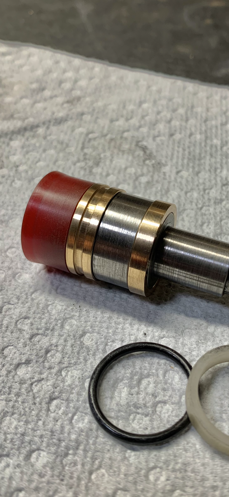

I’m all the way over on the East Coast, but I install, tune and upgrade Tony’s older kits with hand fitted bronze bearings. I also replace the delrin transfer ports with brass ports with single oring.
One thing to note on the front bearing, I remove the front o-ring and machine a wider bearing with a small groove. This eliminates the o-ring.

Is there a reason why you want to switch to brass?
Tim
Tim, the phosphor bronze bearings expand less with heat and can be run with a tighter tolerance within the compression tube than the delrin bearings. All of Tony’s skirtless kits now come with bronze bearings.

I had two summers when my Tony Leach kit went from 11.5 FPE to 8 FPE. Other competitors using Tony's Kit also reported losing power in 90+ degree heat. I contacted Tony and he suggested Bronze bushing instead of Delrin Bushing as his analysis was that the Delrin bushings may be expanding in the heat and dragging on the compression tube thus robbing power.
BTW the suggestion was Bronze bushing ...not brass

Its the problem with Delrin. Especially with the Tinbum kits.
With the Tinbum kits you will already be dropping a full 1ftlb due to the reduction of weight from steel, but on a hot day ive known as low as 9 ftlbs…as the already tight guide gets even tighter on the spring.
Its because the high thermal expansion of Acetal/ Delrin is adding another effect against power, especially when tuners already build in tight tolerance fits…
Tony got it right first time (see his original report on the New Formula AGW) using PB bearings.
His shift to Delrin an error because Tony loves his tight tolerances which Delrin is not so keen on.
Great guy, but i believe his original New Formula should have been his final formula as he got it right first time.
Sometimes with technical advance, we occasionally need to take a step backward to our original design….
Recently, i discovered the joy of machining up some Medium Carbon steel guides and Top hats.
Got zero temp shift in size, going from freezing nights to a hot day, allowing good snug fits.
The reason we all shifted from Steel was not the material, it was the fits were not very good from OEM and us then assuming the steel was the issue.
Get your fits right, and steel can be superb, for guides, and never break.
Steel Top hats can easily be relieved a bit by up drilling the the internal diameter for a portion of its length and keeping the length short to keep its weight down if that is what you want.
