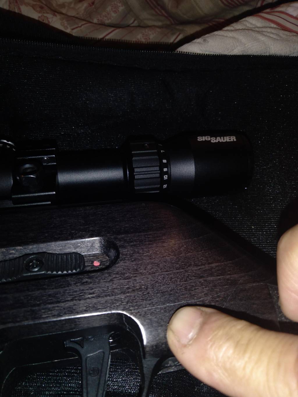

Yesterday I dropped a beloved gun while cocking. The result is a fracture of the beech stock that is only half way through, but I am in the need of someone capable of fixing my stupidity. It will be difficult for me to photograph because I am limited by my phone, lol.
Any suggestions??????
Get some epoxy, take the action out and open up the fracture carefully to allow the adhesive. Then wrap a compression band around it, you might need to remove excessive adhesive. The longer the cure time the better. You can do this, good luck!

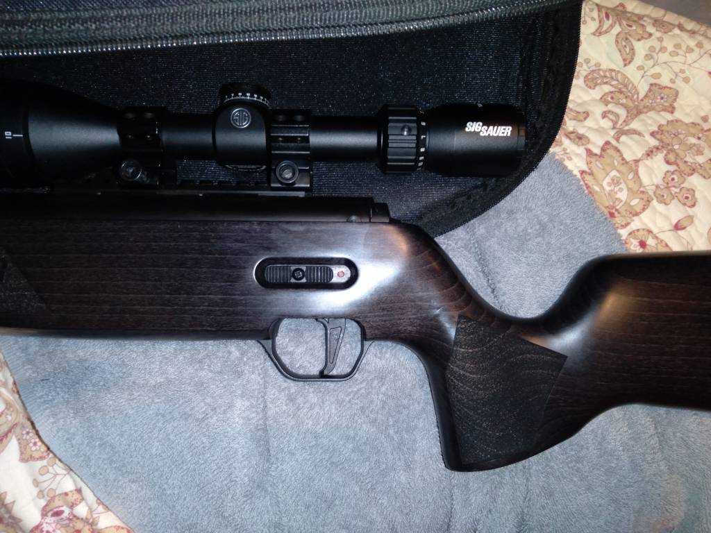

Well. It looks good, is holding, and shoots perfectly. Guess I didn't upset the scope when it dropped!!
Thank you for pushing me to do it!

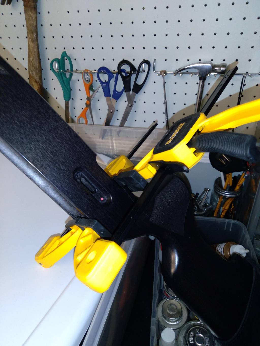

I moistened the wood to allow deeper glue penetration and seepage further into the crack. I the tightened the clamps ETREMELY tight over the defect. After the glue dried I used my fingernail to smooth out any irregularity and remove residual glue ( I used water resistant wood glue). I then used a black sharpie to cover any non black edge, and some old black shoe polish to blend and polish the defect. Turned out great!!

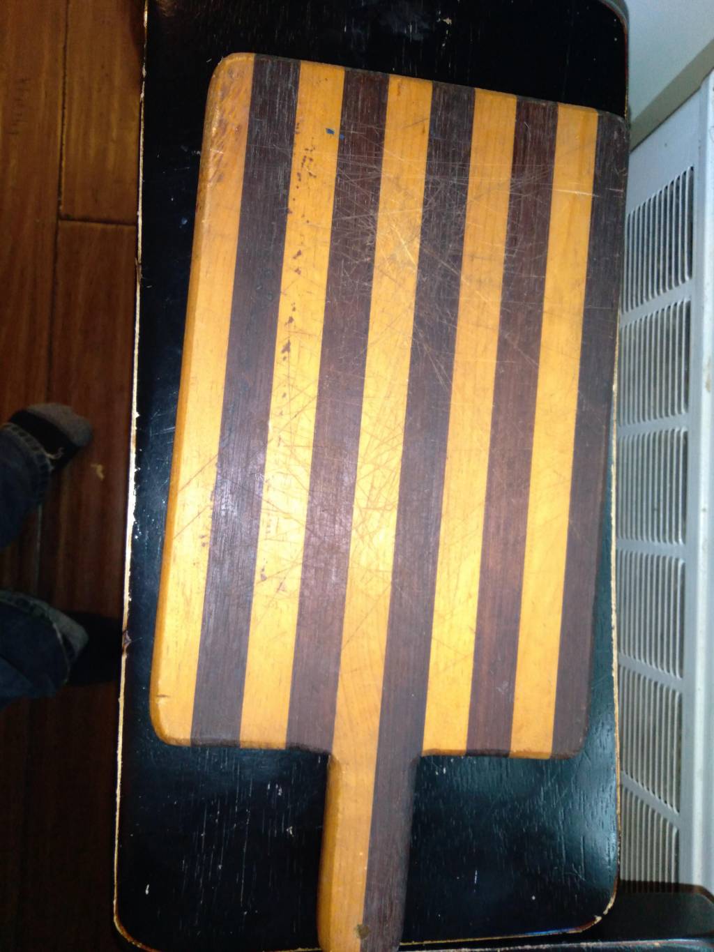

I went with more traditional wood glue for a few reasons.
1. I have used it on many projects that have withstood the test of time. This cutting board I made in 1983. It has been dropped, stressed, abused and put in the dishwasher countless times and all of the seams have held up perfectly (I've used the wood glue in sundry other products under stress as well with perfect results)
2. I figured if I couldn't fix it, it would be easier to remove wood glue than epoxy.
3. I feel epoxy might be stiffer and more prone to re breaking. I've used wood glue and if the edges match up well and its held under compression I have seen the wood break in another area rather than along the crack.
4. The edges mated perfectly and I feel wood glue may work better here and epoxy may be better to fill in gaps.
I just didn't want to touch this project since I wanted a "perfect outcome". You guys pushed me to do it and I'm so thankful you did.
Sorry to hear that you dropped your Sig Glen ! Any other damage other than the stock ? Trying to figure out how you dropped it while cocking ?
The key to a good wood crack repair is to open up the crack as much as you can without increasing it's length. I've used Gorilla Glue on cracks that wasn't a gun stock. Wetting the wood is a great thing to do and will allow for a better bond. Fortunately, I think where it cracked might be a better place than if it were on the forearm. Just keep watching it as the ASP20 has high shake firing behavior.
