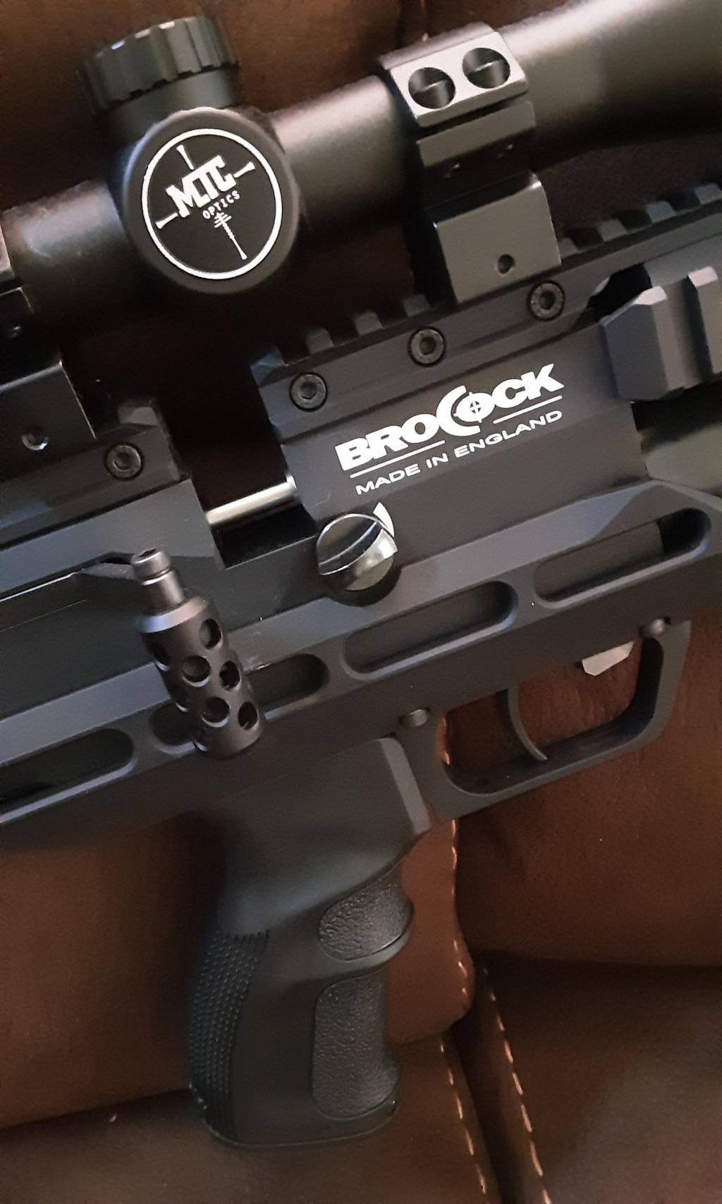

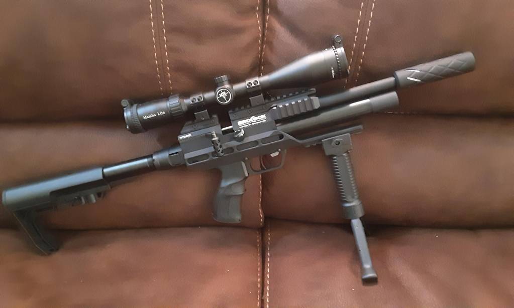

Hope there is some Brocock masters in these threads today. My issue is every time I fill my Ranger XR (200 bar) she leaks down to around 150 bar, and then stops leaking. Any ideas on the issue?
She is only 4-5 months old, this was the first time shooting her, only 2 magazines through her by me. After that initial time shooting to sight her in is when I noticed the problem. Tried refilling a few times but same result of leaking to 150 bar. I cannot find any Videos on the disassembly or reassembly of this gun so its kept me from trying a fix myself. If someone can point me towards a breakdown video that would be great. If you have any ideas of what could be wrong I would love to hear them, or point me towards someone that can help. I will be checking back here a few times a day so feel free to ask any questions that may help solve my issue. Thanks Guys and Gals I truly appreciate it.
photos attached (until I figure out how to post pictures in the post)

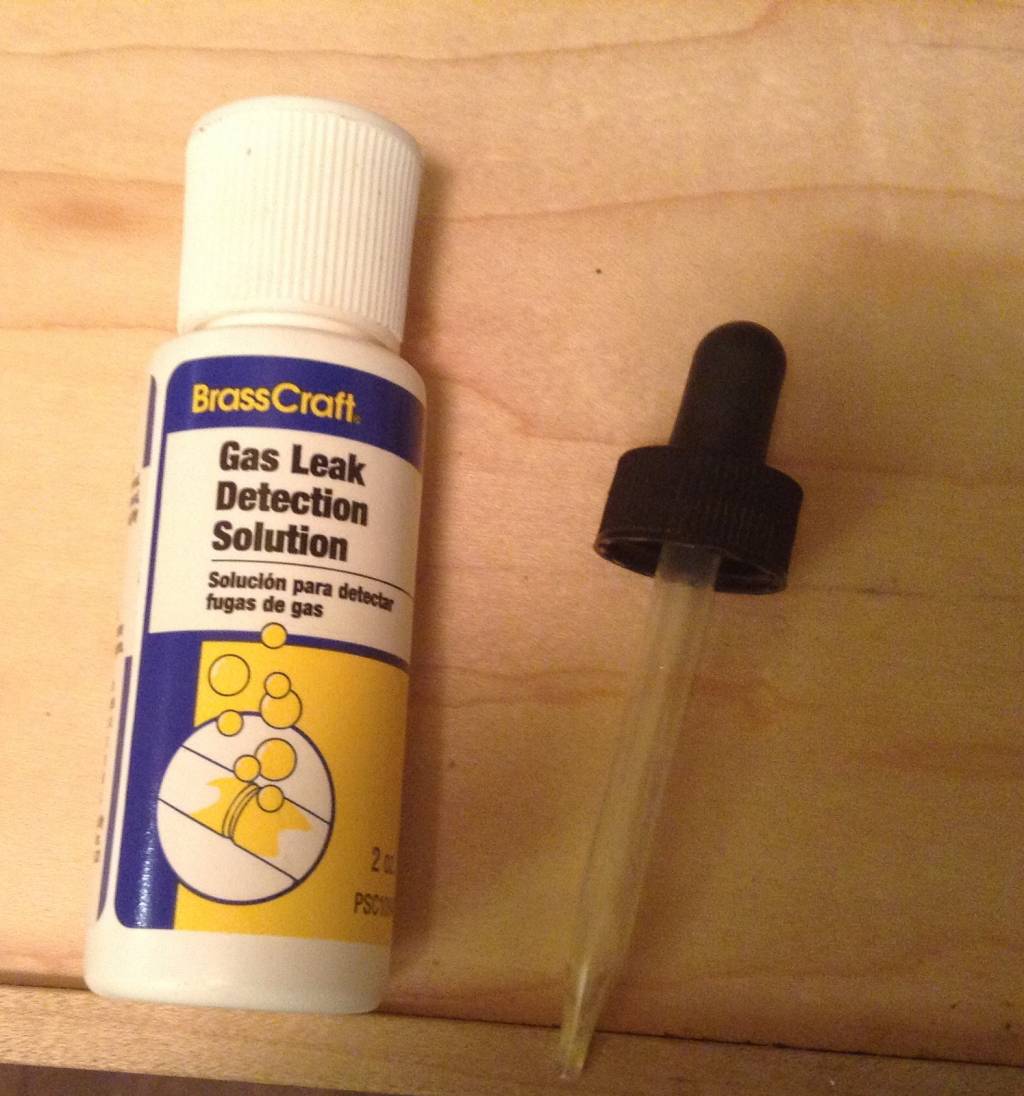

You might try something like the following leak detector, best applied via a dropper tube. Apply a drop or two where you insert the probe. If you see little bubbles form you'll have your answer.

I fill my Atomic XR to 250 BAR no problem... I had a similar, very slow leak in my Compatto, applied leak detector via the dropper (this way you don't get fluid where you don't want it). And saw the bubbles forming ever so slowly... Please post up once you have remedied the leak. Reaching out to AOA would also be prudent to see what they might suggest.

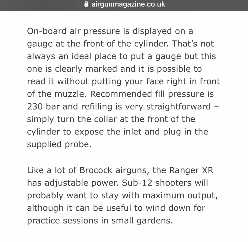

@L-Leon I was under the impression we were discussing the Brocock Ranger XR in this thread. Are the Atomic and the Ranger the same gun (one sub-12 fpe and the other FAC)? In regards to the Ranger, I’ve read two conflicting maximum fill pressures in two separate airgun publications. One suggests 200 bar the other 230.
I’ve seen this sort of conflicting information concerning Brocock airguns in the past. The difference is that in the past the conflicting information was released from the company itself.
The information you've posted is from a UK Airgun Magazine... The information I posted is straight from the Brocock manual. I believe all Brococks sold in the USA would be FAC rated PCPs in the UK.

@L-Leon Thats what I was unsure of, but began to suspect after reading your initial response about the Atomic. Thanks for clearing that up. It makes sense considering that Brocock has done this with other models/configurations. I did more reading on it this morning and now I understand why. From what I read the changes were specifically for legal purposes. That caused the two variations to be marketed differently. The name change is slick as well. I thought I was clear in communicating that the conflicting information was from two separate publications and left the URL in the screenshot intentionally. My apologies if I caused any confusion here

Going to use leak detector today, will come back and fill everyone in with results. It has also been suggested that I fill with the gun cocked, although I can hear the hammer spring moving around in there. I guess it is possible for the hammer to be pushing on the valve just enough to cause the leak but then I don't know why it would stop at 150. Another place that I am going to really look at is the power selector knob. If you look close in the picture you might be able to see a slight oily sheen around the knob. And when filled, if I push on the knob (inward like trying to push in a pin) I hear a very slight, short "ppphhhttt" sound (like blowing a "razzberry") though it is hard to duplicate at lower pressure, which is why I suspect that area. I have emailed Brocock, and I am hoping that they have a tech that can email me on some of these issues. Here's a Question for you all, the "poppet" is that the part that opens to let air through the transfer port? Is it inside the valve and has the rod or pin that the hammer strikes to open attached to it? How hard is it to remove and are there any videos showing the process? I have had the poppet suggestion 2 or 3 times now from all the places I've posted asking advice, and it kind of makes sense after setting all that time at 200bar that maybe it "settled" into a shape that now allows for this issue. Although that would be a design flaw, no? I really don't know much about "Peek" or "Derlin" the two materials I've heard it was made of. If the leak is from there (the poppet) the bubbles from the leak detector would come out of where?
