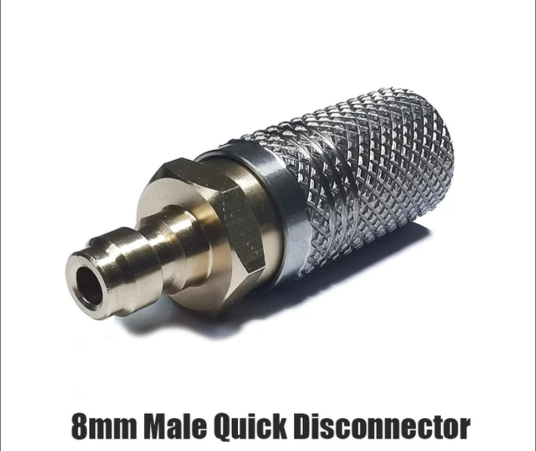

Do I need an adapter for the fill port prob on a Brocock Sniper XR Magnum .25 to fill it? If so could you tell me what the name is or what it looks like. I have a new GX PUMP CS4-I Portable PCP Air Compressor to fill it with but not sure what adaptor I need or if I need an adaptor, any help would be greatly appreciated, thank you.
I don't have a brocock but I had to get this adapter for my fx impact mk2 since the connector in the rifle itself is deep inside my regular hose does not reach it. Might be the the same way
This is what you need . The fill port is recessed and difficult or impossible with a short foster fitting.
Yes I bought it used and it does not come with it, as it wasn't turned in with it.
Bummer. I can get a normal one to fit and fill the gun. It's just very hard to remove but can be done with care and some long fingernails(aka my wife) or a small tool that can grab the release collar once it's up in the gun.

Mine came with one but it would not work on my compressor whip line ( looked the same but wasn't).
I had to add another coupler to make it work so, I ended up just purchasing a whole new deeper disconnect with the correct fitting.
If it was the one with the threads there is a difference in threads with NPT and BSP anyways if it was the one with threads you do need another coupler I think. Most compressors us BSP threads as it is global standard and NPT is north American standard. So since most compressors are not made in America it seems to be BSP for threads. But I just ordered the one posted here above and avoided threads and extra couplers altogether.
