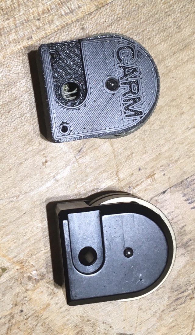

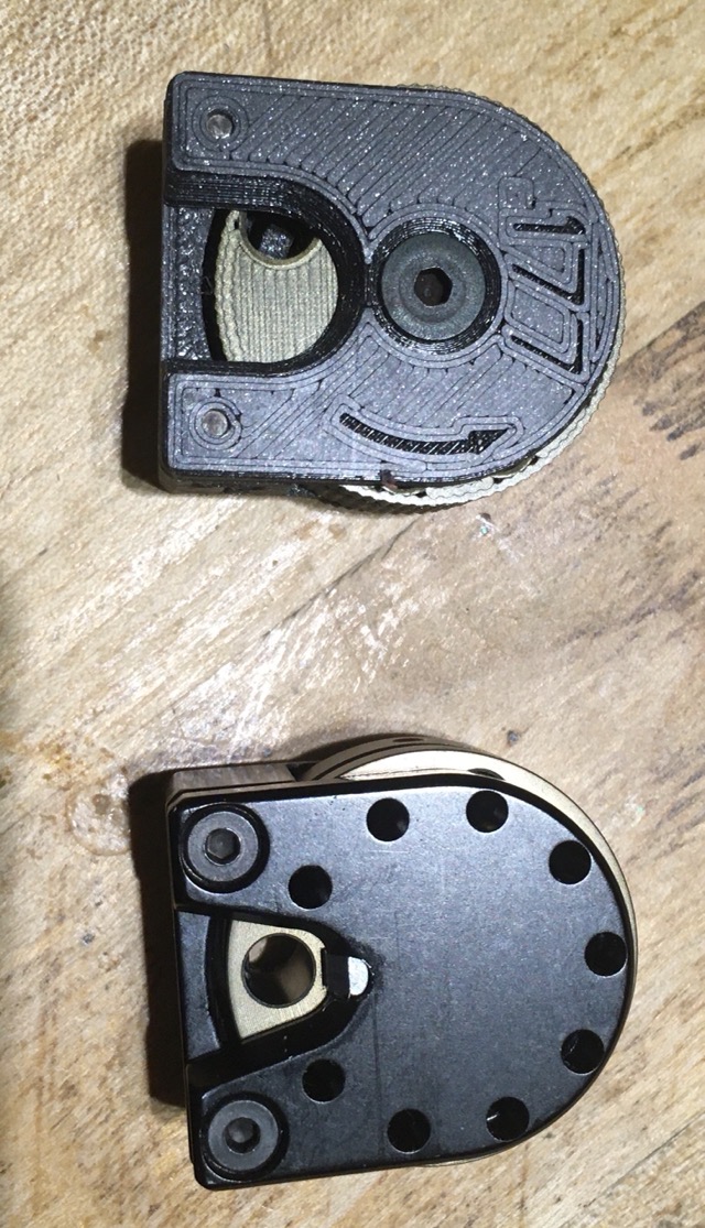

 I have a non flip factory mag and a couple of Carms mags for my .177 Sniper XR that work fine. I bought the gun used from a forum member here, but am under the impression it came from the factory with this non-flip style factory mag. Here are a couple pics of the factory mag and the Carms.
