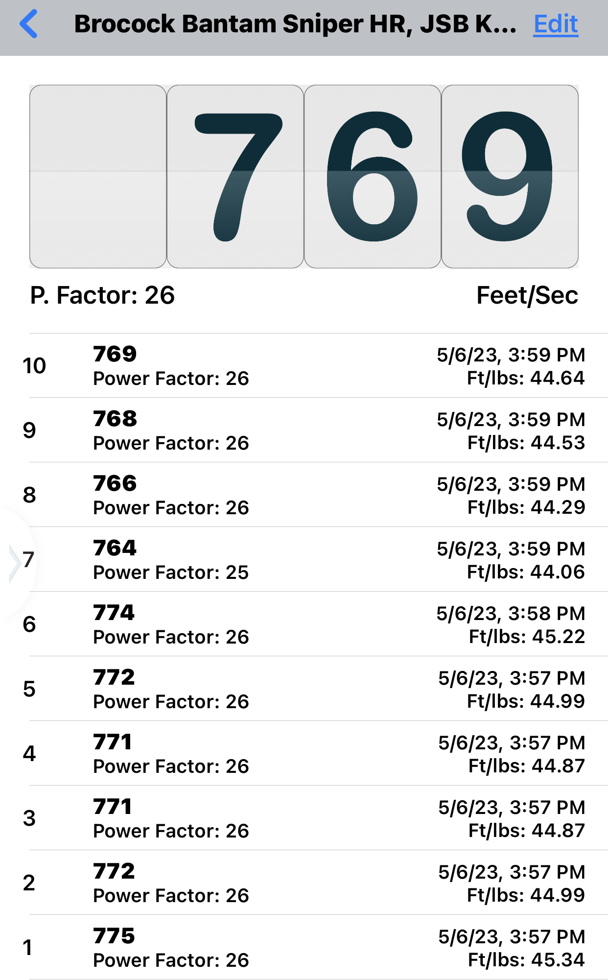

@drsquall I shoot a Bantam Sniper HR in .25 Reg is set around 145 bar. I’d have to do some searching for the hammer spring measurement.
I think you’ve received some sound advice about coordinating balanced adjustments between the reg and hammer spring. I haven’t pushed mine to its power limits. It does what I need it to do the way I have it set. I also do not recall what the differences are between the HR and XR. I discussed it with a member recently but I can’t recall the details. I’m not so sure that sharing my experiences would be of much use to you. There’s a pretty good thread on the Sniper HR that I have bookmarked if you’re interested. I think other members will benefit from you documenting details of your tuning discoveries in this thread. Thanks for sharing.

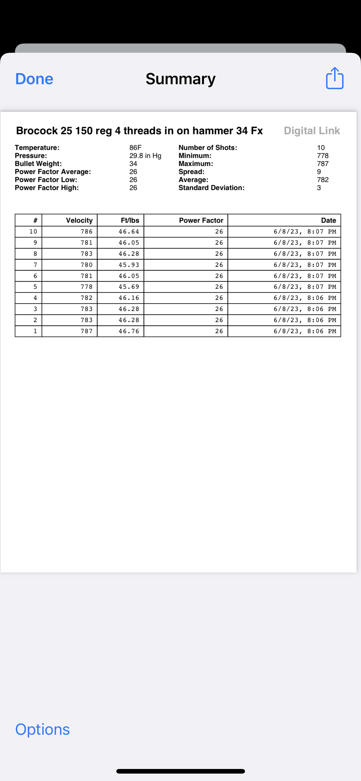

I am going to try reg at 140 and start there. Do you get reg creep? I feel I get at times maybe 5 bar increase. Also, I take the gun out of the stock to tune it so it's easier to adjust hammer spring. All this is new to me so I got another question- sometimes when shooting it without the stock I hear a little noise like the reg filling up again. It's not happening all the time. I haven't figured if it's when the reg is at a certain setting or the hammer spring tension greater less?
This one chrono with the 34
View attachment brocock-25-150-reg-4-threads-in-on-hammer-34-fx.pdf
