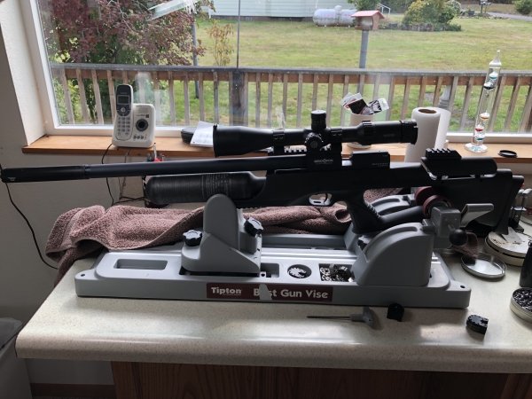

As requested some pictures of new rifle and now with scope mounted. NOTE: If you mount your scope low you may have to remove the rear most dovetail/picatinny mounting. I have a Hawke Sidewinder 4-16 and the Hawke low mounts. I had it all set but couldn't get the magazine in because I didn't have the scope far enough forward and just a little bit of the picatinny mount blocked a tiny portion of the access path for the magazine. I moved it just a bit forward. Everything is on the front picatinny rail. However the scope power adjustment ring was laying on the picatinny in the back. I took the picatinny off and it still was rubbing. Had to take the dovetail off also and now it works fine. Haven't heard that discussed so I have a picture included showing the dovetail sitting on the cheek plate after it was removed. UA checked with their tech and he recommended the low mounts for that Hawke scope. However I was not told I would probably have to remove the picatinny AND doveltail on the back of the rifle. Just a heads up that you have that option if necessary.
