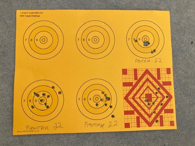

Hi Tony, I have the Brocock Sniper HR Magnum (a.k.a HP). I assume our guns are pretty much the same and have the LW Polygon barrel. I have found this gun to be quite accurate with JSB Monster Redesigned pellets at 895 fps.
BUT...
This barrel is THE MOST PICKY barrel I have ever owned.
Accuracy goes down the tubes as soon as the barrel gets a little dirty. In good conditions and with a clean barrel, 1/2 inch 5-shot groups are possible at 50yards. I DO get the occasional flyer but for my purposes I shoot straight from the tin so I'm OK with this.
Oh, while I have tried lower reg settings, I still come back to factory of about 155 bar on the reg and having the hammer spring screwed in about 3.5 mm in from being flush with the back of the receiver.
This target was at 50 yards off a bipod prone...with lots of coffee on board ; ) Upper right was last target. 880 FPS
