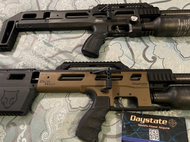

All,
The gun shoots really well and I'll post more pics and results this weekend. Will test with 44 and 50 grain JSB's. More to come. All parts completely interchangeable with the Delta Wolf too!!
Regards,
Steve
