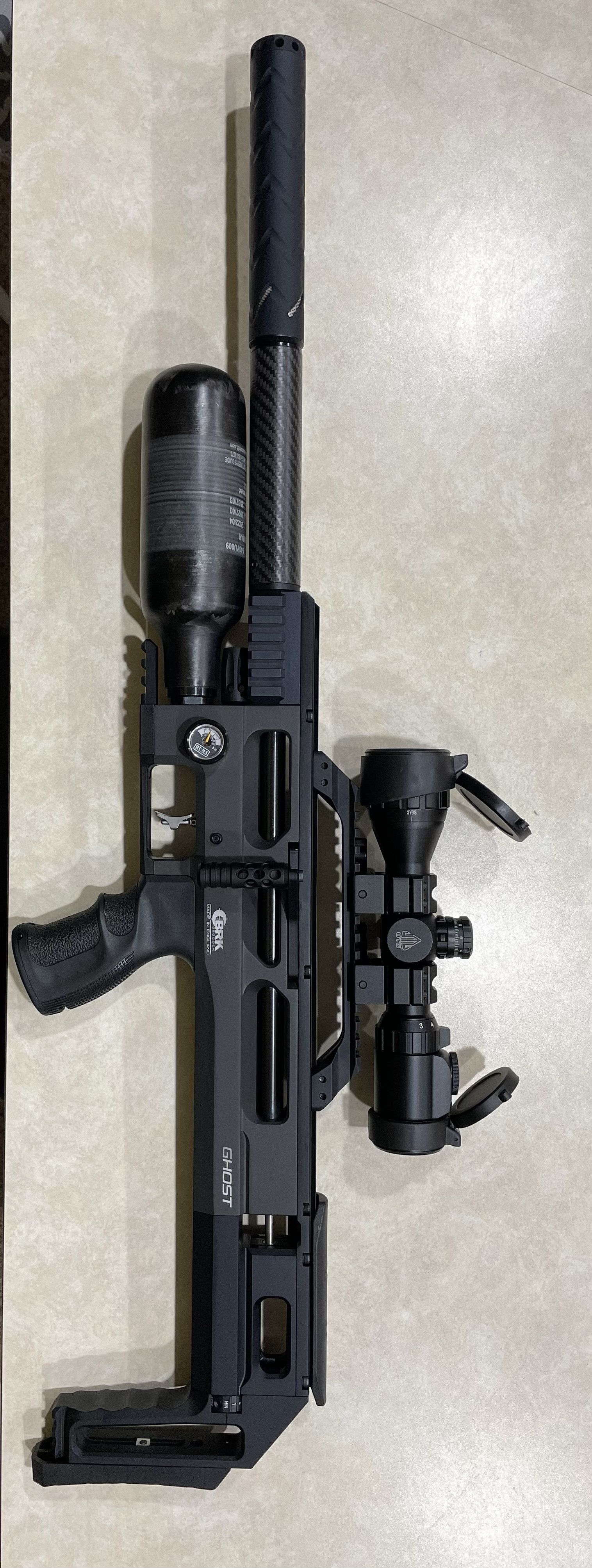

In the three days of ownership of my Brocock Ghost Carbine .22, I can say that so far my experience is a positive one. I think three days make for sufficient time to assess the build quality by sight and feel of the gun’s exterior only and share my impressions here, and share a few thoughts on its power capabilities.
The build quality of the Ghost in one word is this: superb. Now that I'm able to hold it in my hands—after waiting for its arrival at AoA and viewing the available videos of it online—to get a feel of the finish and texture of the materials used, there is nothing I can say to downgrade what I’ve stated above. I’ve said it in another post that its build quality is like that of a fifth-generation fighter (yes, I've seen one up close in the metal at an open-house event at the Air Force base close to me). From the screws, which are appropriate in size for the torques to which they’re subjected, to the muzzle, to the rear end— fit and finish are excellent. Even the entire power adjuster unit itself has quite some heft to it because of the metals used—no plastic can be found on it. If you’re that type of dude, you’d consider it a jewelry piece! Now that’s what I call attention to detail.
The only nonmetal components, again on just the outside, are the cheekpiece and the shoulder pad, both of which seem to be made of ballistic polymer. To put it simply, should I ever run out of air while out on the field with a coyote after my tail, I’d have no problem holding the Ghost from its rear end to use it as a club to whack the animal and have the confidence to use it the next day for a competition.

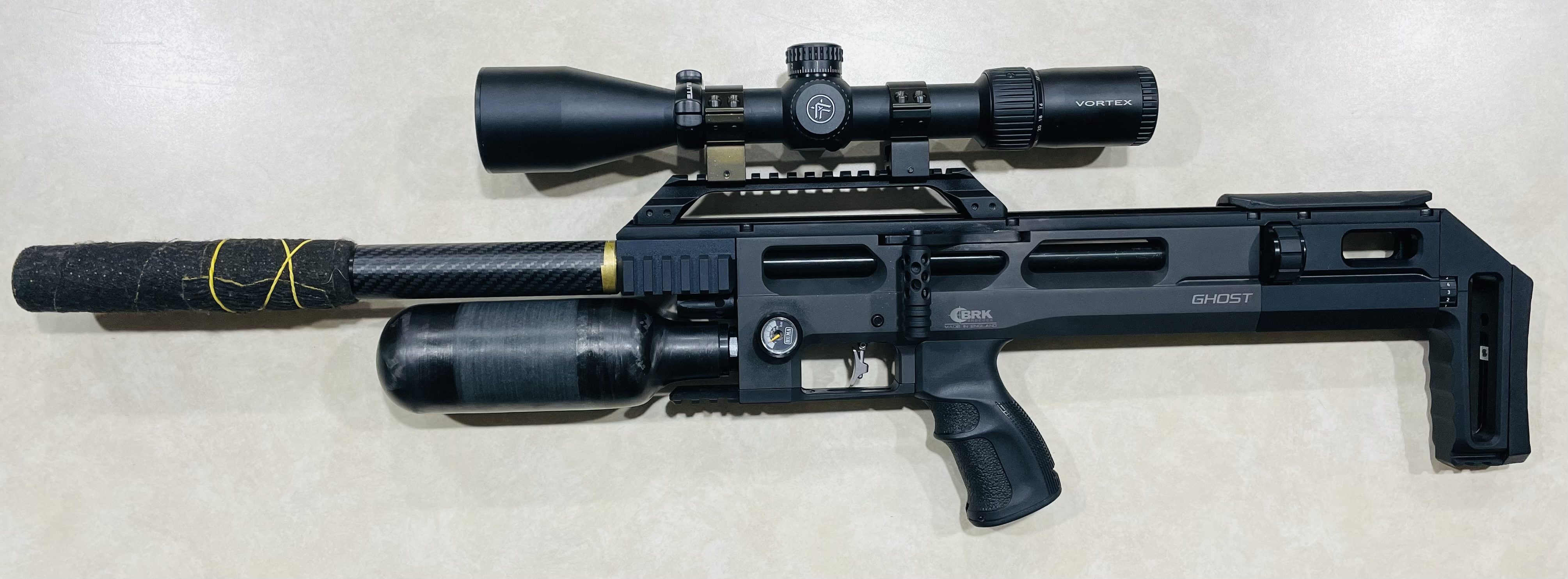

So here's my Ghost Carbine in its final configuration. Initially, I put my Bugbuster to try keep it as light as can be but decided to mount my Vortex Diamondback FFP instead for more magnification, as the photos show below. Also, I've changed the hammer spring for a lighter one and achieved my goal of getting it to shoot at 9 FPE--plenty enough power for backyard practice and pest control.
This gun is made for enormous power, and to achieve such magnum power VERY EASILY. But because I also want magnum shot count, if you will, 9 FPE allows me to attain it. I gave up counting the number of shots at the current power setting at shot number 288. The regulator pressure is set at 50 BAR, the lowest number on the gauge, and the power wheel is set at #4. Remaining bottle pressure was still over 100 BAR at shot 288; obviously, there was still plenty more shots to be had. Also, I find that the power wheel provides more variance between each setting with the light-tension spring I installed and at the lowest reg setting.
